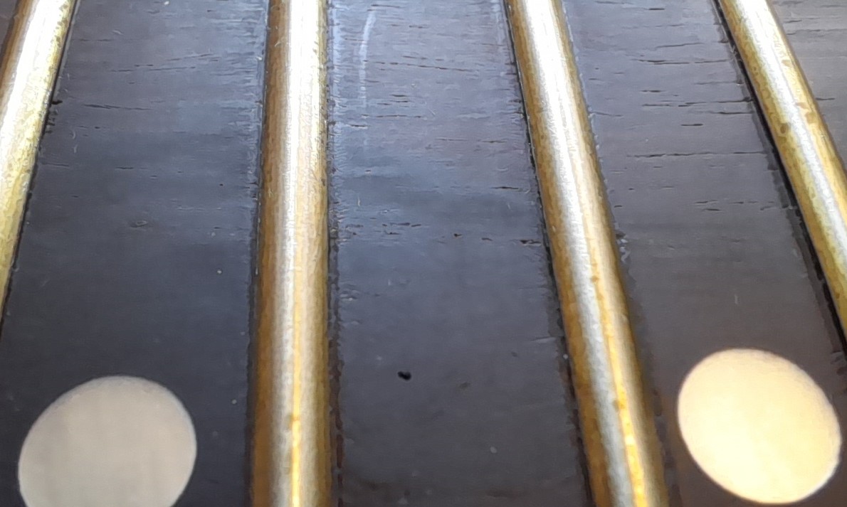

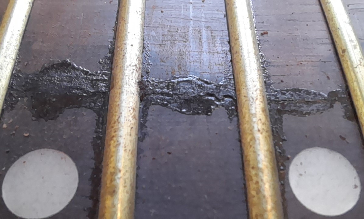

    I received the neck a few days after Christmas. Found it had glue in the truss rod pocket & inside the head of the truss rod nut. Was able to pick this out & gave a tiny Lanotec spray to free up the thread. Seems okay. The fingerboard had a crack in the grain in frets 19, 20 & 21. Following a Stew Mac video I repaired this with Zap thin CA & some jam (acacia acuminata) dust. Very pleased with the result.

    Thats a very good repair on the fretboard!

    Nice repair
