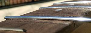

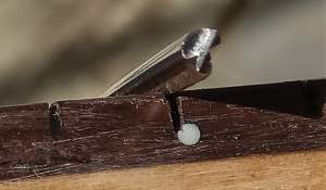

    Hey,
    I've been re-fretting an Ag-1 neck with larger, stainless steel frets. Using a radius block from pitbull, I sanded down the fretboard to remove the chips made by removing the frets and in doing so, made the fret slots shallower. I have a fret saw and have been trying to cut the slots deep enough but I'm having trouble getting it right. I have a spare neck I'm testing on but no matter how I try to saw, the frets aren't sitting deep enough, the crown sticking up from the fretboard too much.

    I've tried sawing deeper, sawing less and smashing it in with the hammer but it doesn't seem to do much. The neck pictured is my spare, already damaged neck but the result is very similar on the actual neck. What should I do? Am I doing something wrong?
    I'd suggest the saw simply isn't wide enough for the tang width the frets have. The width can vary between fret types and you need the right width saw. The tang looks significantly wider than the fret slot in the picture and it obviously doesn't want to go in as you've bent the crown of the test fret over.
    I agree with Simon on the tang/slot width relationship. The slot looks more than deep enough.
    I can't tell if the bent crown is a result of trying hammer it into the slot or if it has been deformed by your nippers when cutting off the wire.

    I found measurements for the saw width (.58mm) and the tang width (.6mm), so a .02mm difference. Is that enough to cause issues?
    Yeah McCreed I think you're right, I think it was the cutting that caused that, I reckon I should cut parallel to the tang
    It shouldn't be an issue, the slot needs to be very slightly smaller. But you really need to measure the saw blade and the tang width rather than read a spec. And if you are twisting the fret by cutting the end off, then you may as well throw that fret away, you can't use it and expect a good result. It need to remain perfectly T-shaped. Are your cutters designed for stainless frets?

    You need stainless steel fretwire to be radiused to the same radius as your fretboard prior to hammering or pressing it in otherwise it's just not going to seat properly and you'll continue fighting it as you have been. Have a look online, there are plenty of ideas for cheap fretwire bending jigs.
