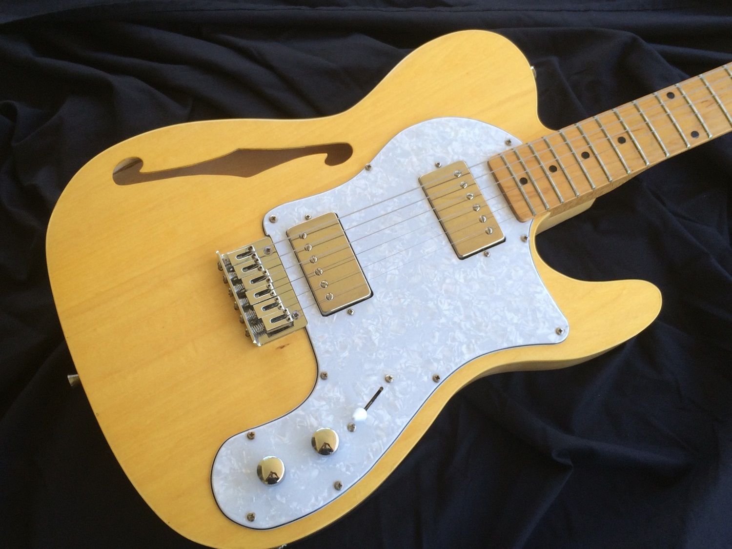

    Before

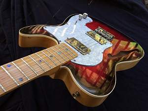

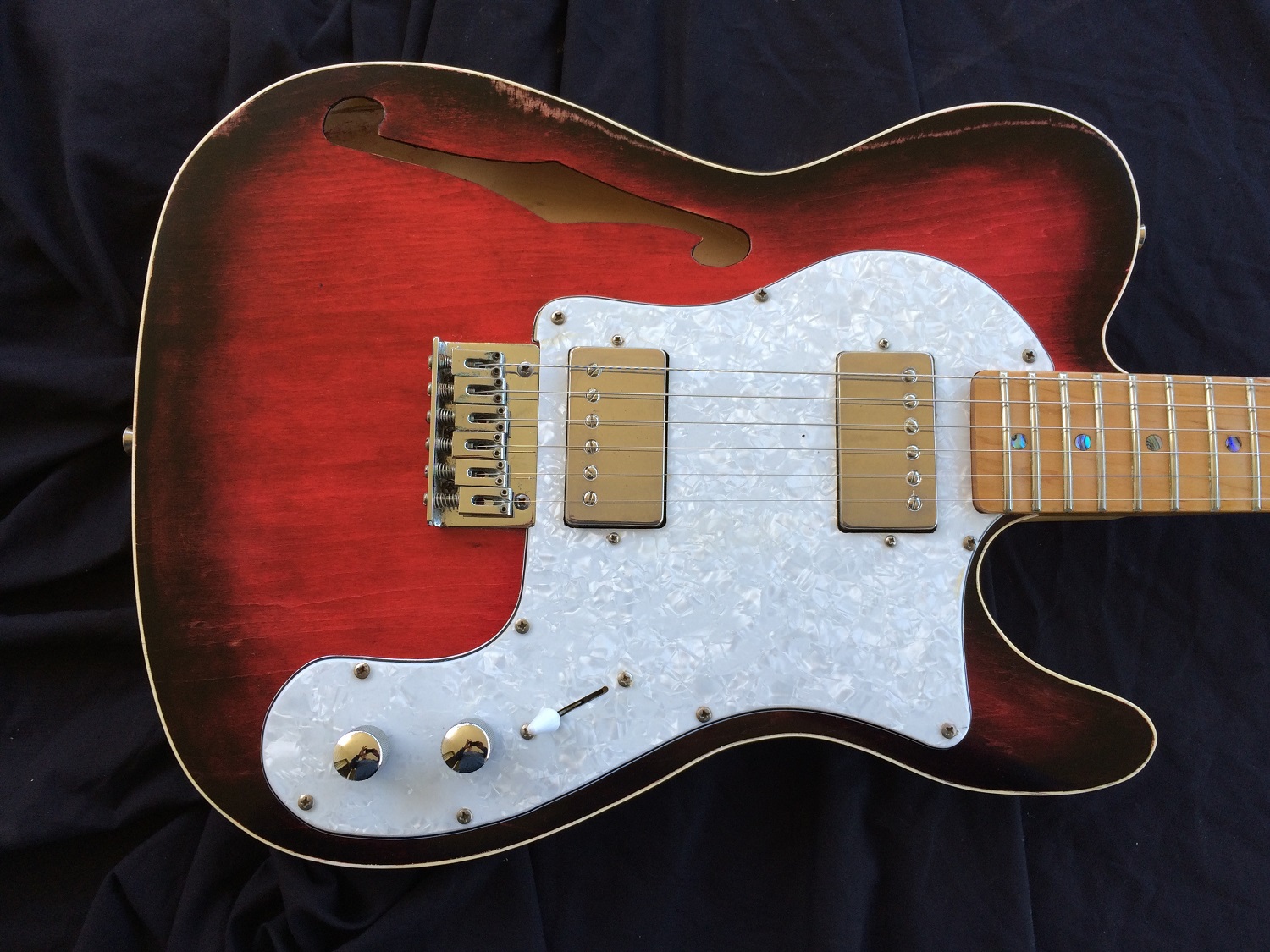

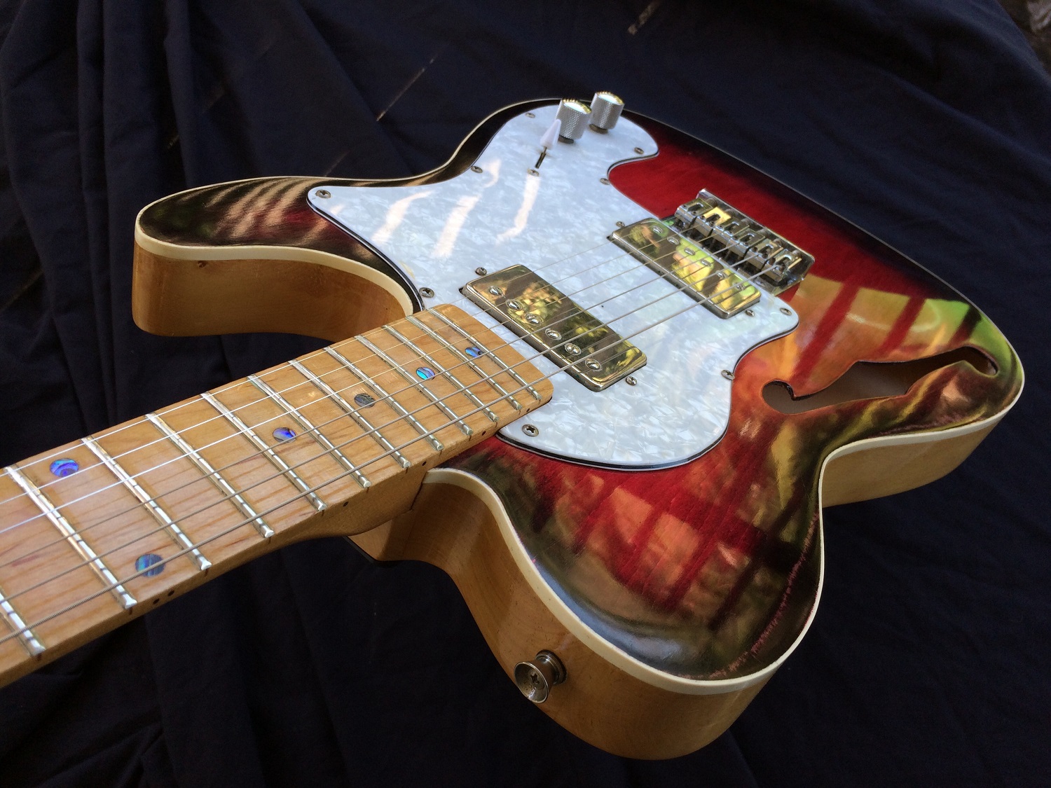

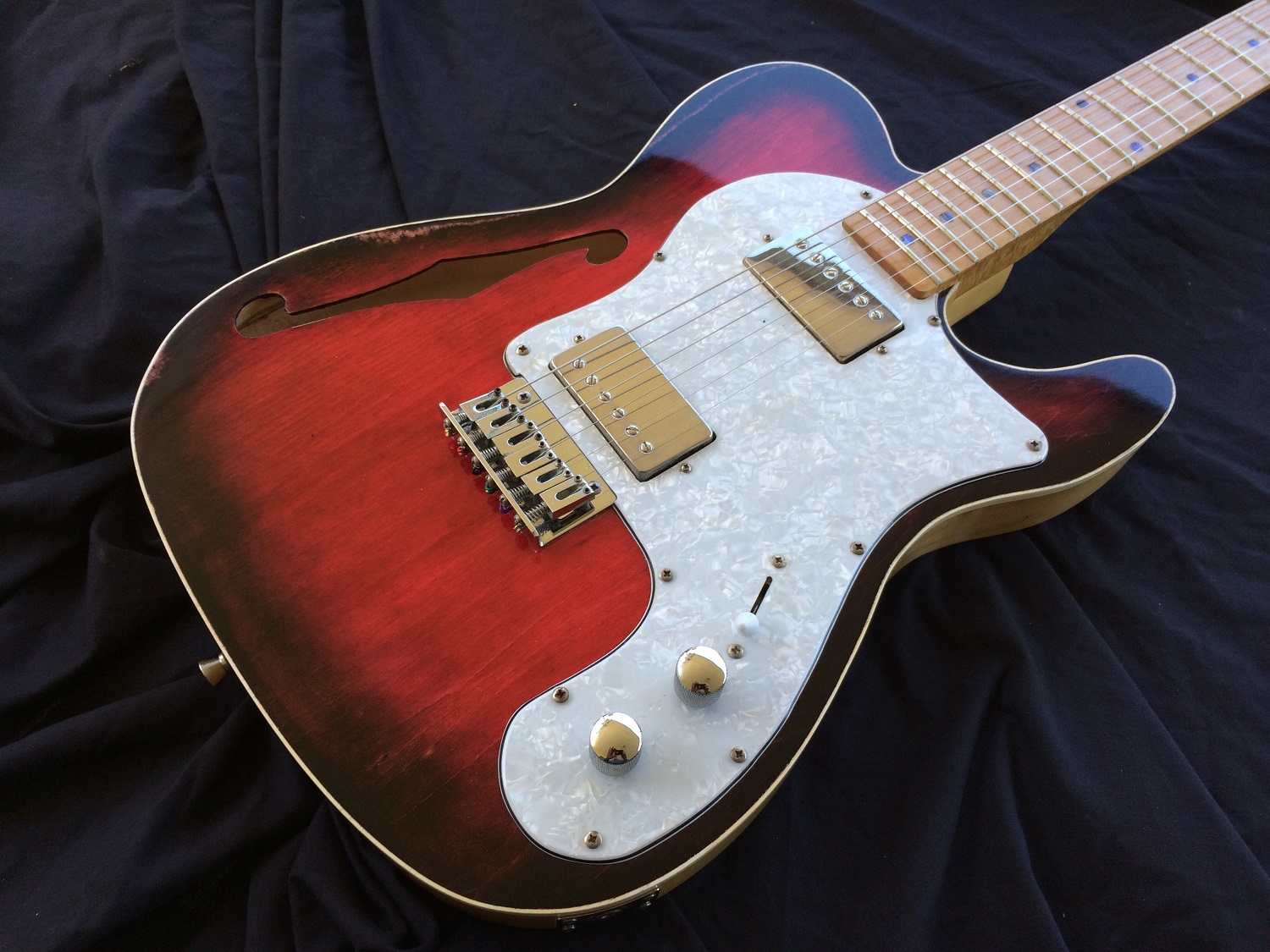

    After
    Cheers guys and thanks for dropping in.
