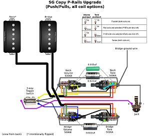

    A pair of inter-linked push/pulls (vol & tone) for each humbucker will give you all four options on each: series humbucker, parallel humbucker, inner coil, outer coil. It’s a good way to experiment with different combos to work out which sounds work for you.
    Then, if needed, you can potentially tweak and simplify the layout to focus on the variations you like/use, ie. neck series/para and bridge series/inner coil etc.

    Thanks WeirdBits, that sounds like what I need. Do you have a diagram I can follow? The closest I can find is a jimmy Page mod
    This will hopefully have you covered:
    It’s a layout using P-Rails with standard SD colours: black +, white/red, green -. The neck pickup has a little extra with capacitor switching: series humbucker & P90 uses a 0.015uF and it swaps to 0.022uF for the parallel humbucker & rail. If you don’t want cap switching just use the bridge pup configuration for the neck as well. Here’s the relevant post in my build thread.
    If you need something more specific for your build, just ask.
    Linear pots on the volume, Weirdy? Not normal. I’ve got one P-rail pickup on a guitar and that works just as expected with audio/log taper.
    Yep, not normal... was experimenting with older style values, flatter curve pots etc. I actually forgot the B volumes were spec'd on that diagram, thanks for pointing it out. Jon, if you do go for something like this, stick with the standard 500KA push/pull pots for both volume and tone.
