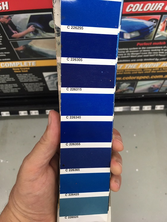

    Welcome Andrew. What Sonic said is sound advice, and FWIW, my local SCA has a swatch booklet (for lack of a better word) that I used to compare colours with. Like SM mentioned, you could use that to do a visual comparison to your PMS book.
    I don't know if all SCA stores have these or not old school books or not.
Name:	blue blue blue.JPG

    You could always try emailing SCA’s main office (as they are more likely to have the reference books) and ask them what their closest match is to the Pantone colour. I’m sure they will have done this before with Pantone and RAL colours. Then when you have the SCA paint number, you can get that from your local outlet.
