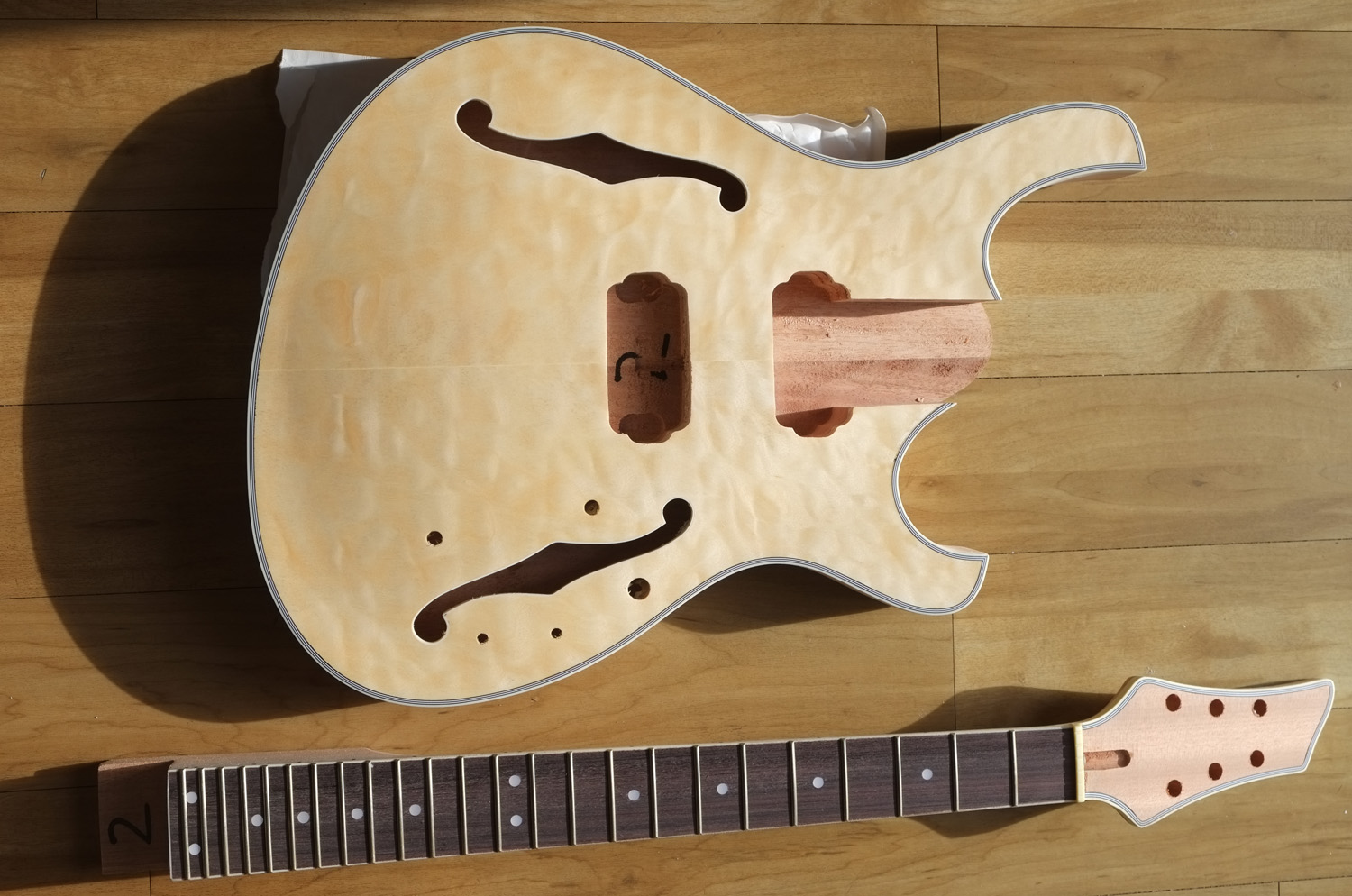

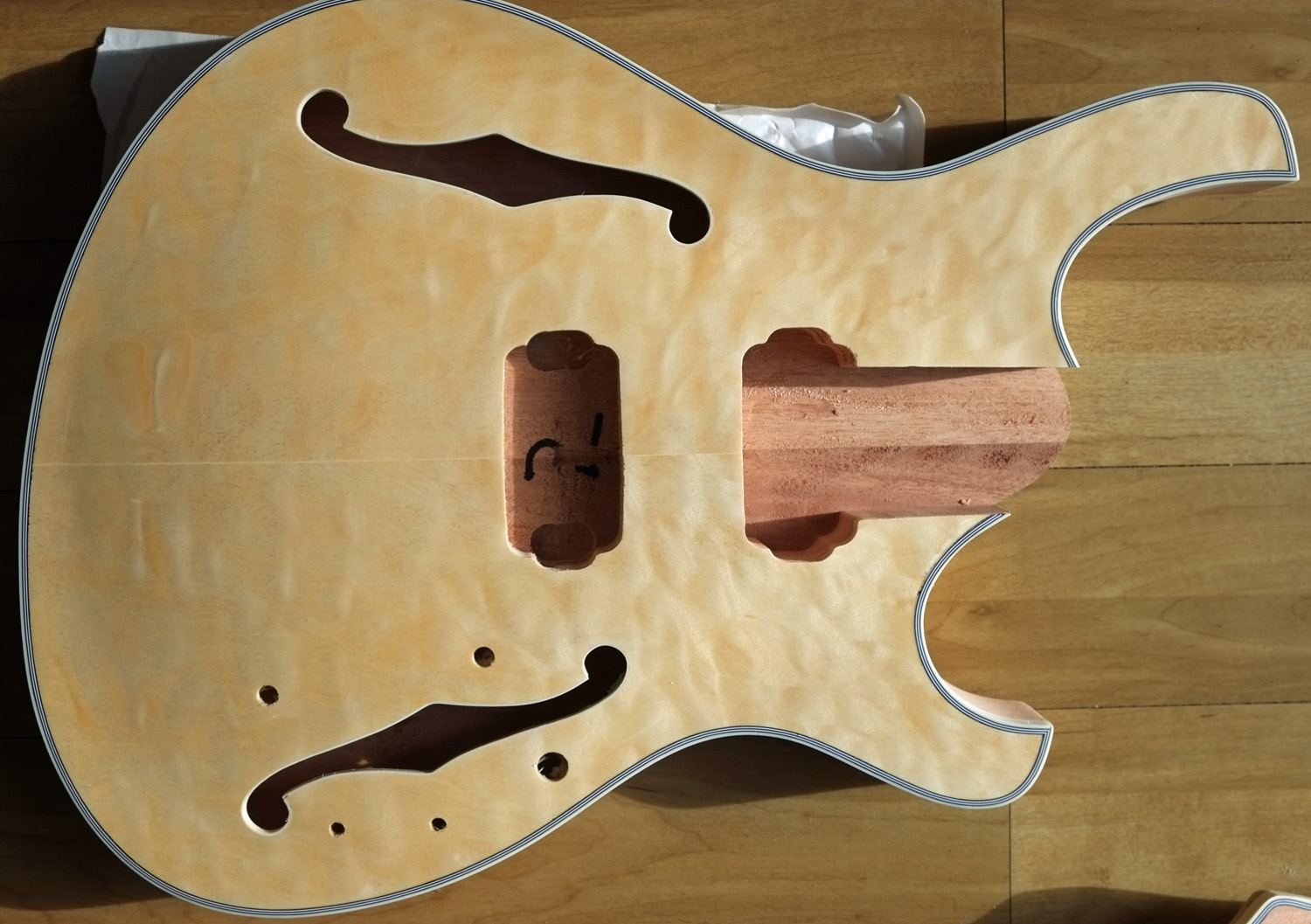

    So this is it, newly arrived and with the body having been wetted with turps:
Name:	GPR 1B neck body small.jpg
Name:	GPR 1B body small.jpg
    No obvious glue spots apart from a white line where the veneers meet. I've already had a go with some glue remover on this and will have a couple more goes once my old electric toothbrush is recharged (easier than brushing the join manually!).

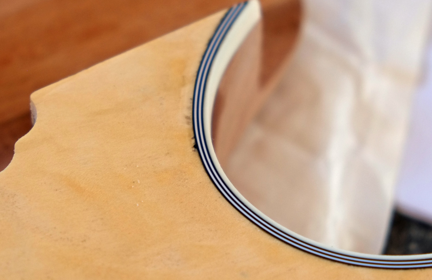

    There's a bit of a mess in the veneer/binding interface in the bottom cutaway:
Name:	bottom horn binding small.jpg
    Hopefully this can be made good with some maple-coloured grain filler.

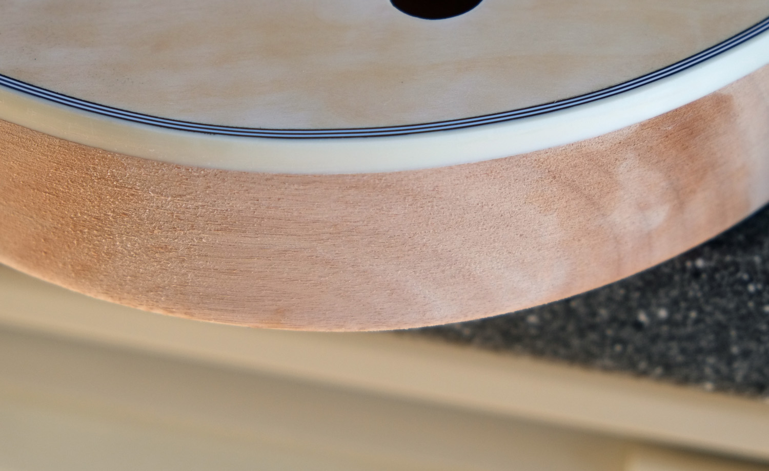

    The binding in general is quite rough and has a lot of machining marks on it, which will have to be rubbed down smooth. Even the F-hole binding is rough, and I've never had that on the three existing kits I've got with F-holes. Still, its only a bit of scraping and sanding.

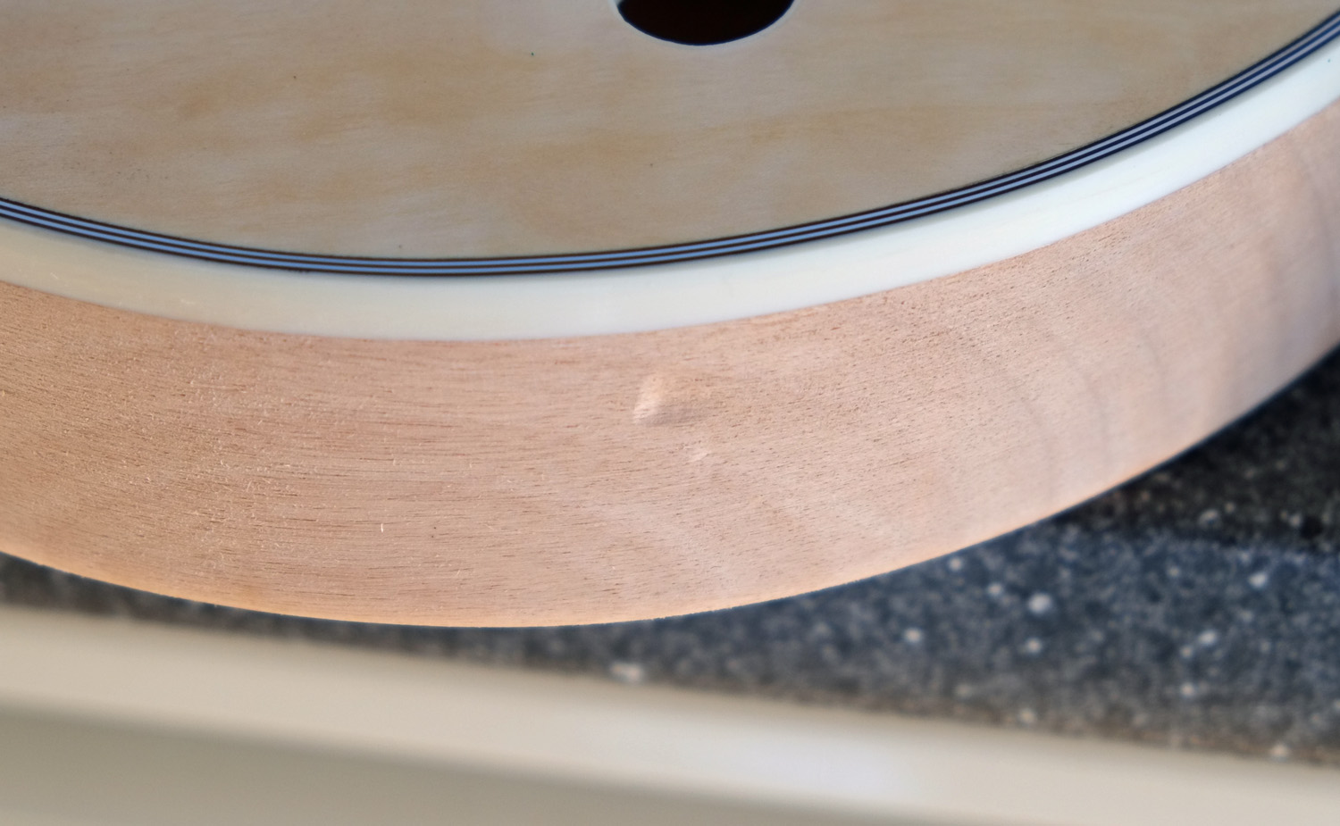

    I was less happy with this dent in the side:

    But my first ever go at steaming out a dent worked well (first use of my dedicated for luthiery $15 iron from Amazon) and now you'd never know it was ever there.

    Apart from a bit of raised grain (and the body needs sanding anyway) it's now fine.

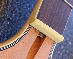

    Here's the headstock gouge by the nut. I think I'll stick some veneer over the whole of the top of the headstock, then just do an angled scrape of the edge so just a very small part of the cream binding shows.

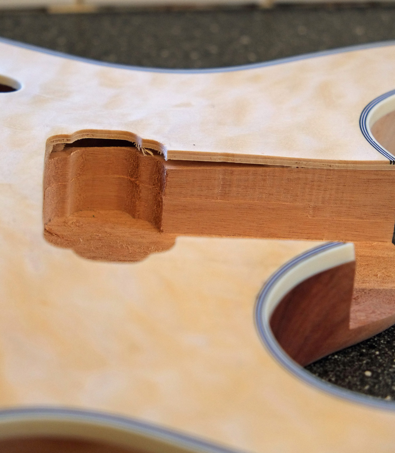

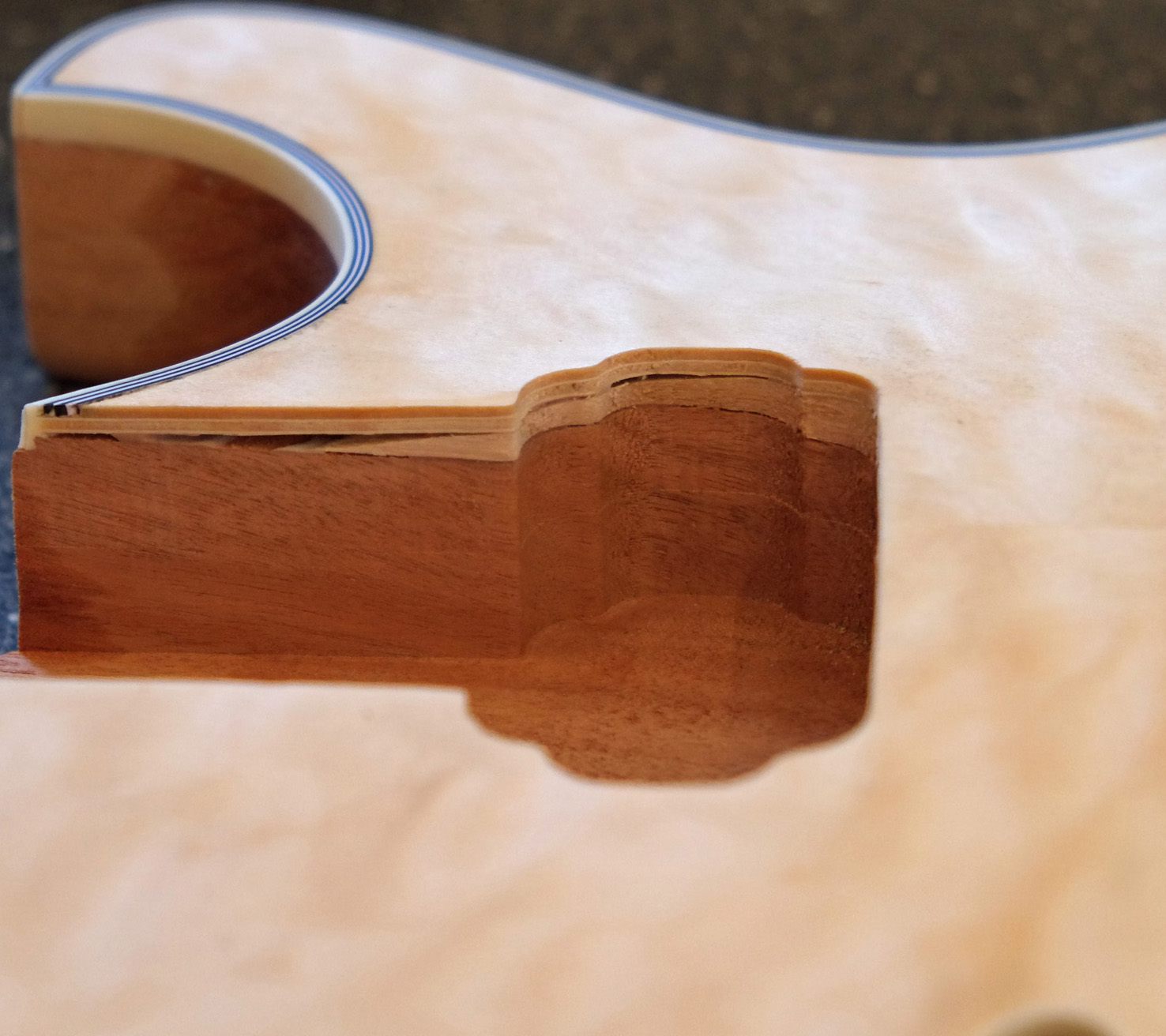

    Then there's a few more items I've just noticed. This took me back to my first electric guitar, an early '70s Columbus LP copy. Its plywood top also didn't touch the body in a lot of places either.
Name:	top gap small.jpg
    The other side of the pocket is a bit better, but still not perfect.
Name:	bottom gap small.jpg
    So those gaps are going to need filling with something solid to provide proper support for the pickups.

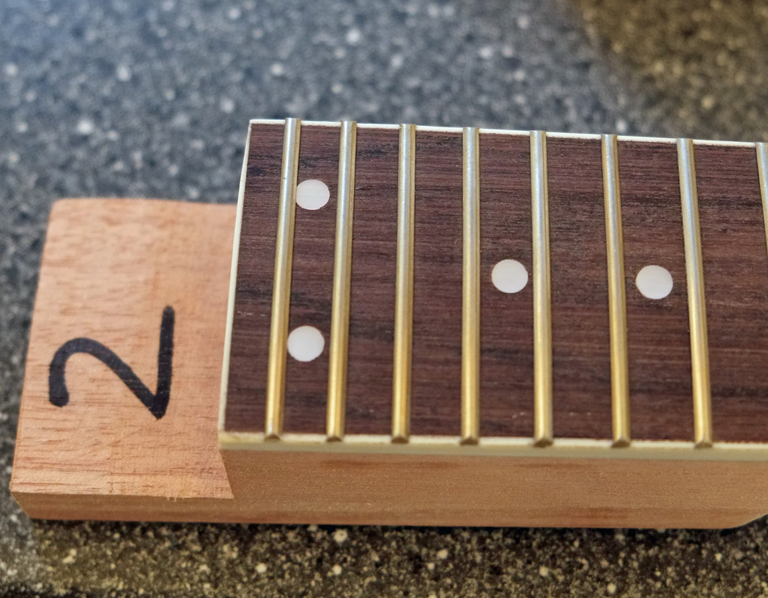

    The last two sets of fret markers are a bit random in positioning as well.

    Apart from the fret markers, there's nothing that cant be fixed. Even the fret markers could be replaced with bigger ones throughout, allowing them all to be centred. But I'm not 100% happy about drilling one of these Blackwood Tek fretboards as they do seem prone to bits splitting off, and I could just make things worse.

    A little bit of a buggar needing to cover the binding on the headstock, and that gap between the ply and the body is huge....

    Hi Simon, what about glueing and clamping, will that top pull back down or will that warp the shape? It’s a nice looking grain in the top, should be amazing with a light color.

    Hi simon could you put some expanding foam glue in those gaps it looks more like a bit of veneer missing underneath than the ply wood letting go
    The treble side looks like it may pull together with a clamp, less sure about the bass side. My experience of the foaming glues is that they are good for small gaps, but where it's been squeezed out of a joint and expanded a lot, the 'glue' is very soft indeed. If I can't manage to clamp the gap tight, then I'll slip some veneer in the gap and glue that in.

    My stair case guy has got one that comes in a silicone cartridge ive used it to put steel bolts into timber to hold a glass handrail and those bolts are never coming out id have to cut the timber to get them out, i cant remember what it was called but it was an expanding glue not foam
    Well, expanding glue = foam. It produces a gas as it sets which produce small bubbles in the glue which in turn expand the glue. If it's not constrained from expanding too much by the materials it's sandwiched between, then the gas bubbles will get bigger, reducing the relative amount of glue in the gap and making the bond weaker. So it really needs to be used where gaps are small, and then it is very strong.
