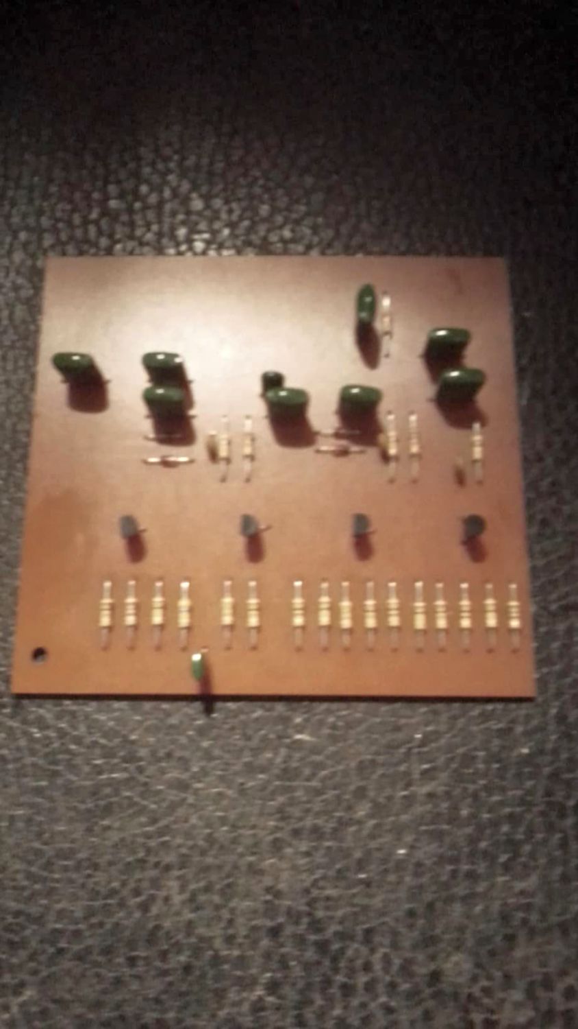

    I'm currently working on a custom Big Muff pedal build, using a phenolic Big Muff PCB I ordered online from PigeonFX which is based in the UK.
    I've already got the PCB all populated with parts; I'm in the process of making a case for it out of some sheet aluminium I bought from my local Jaycar Electronics shop.
    Here's a pic of the completed Big Muff PCB.

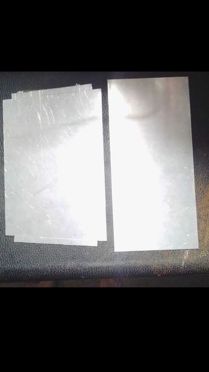

    Here's a pic of the two pieces of sheet aluminium I cut for the two halves of the case I'm making for my custom Big Muff build, left is the bottom half, and right is the top half, I need to mark-out and drill holes for the in/out sockets, footswitch, and the three pots, luckily enough I have enough sheet aluminium left over to make a clip to hold the 9V battery in position, and I also need to figure-out how I'm going to make the 90 degree bends where they're needed.

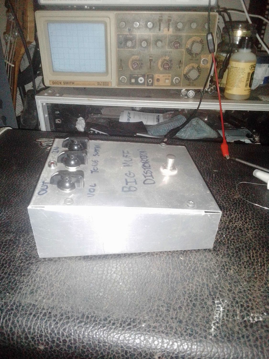

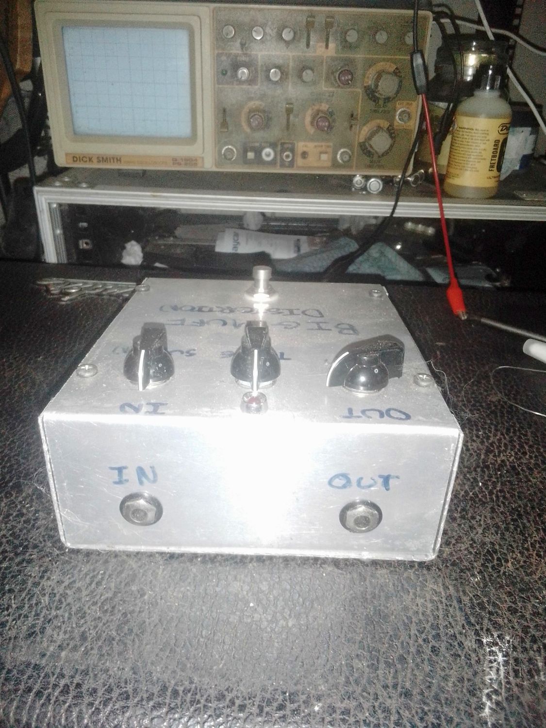

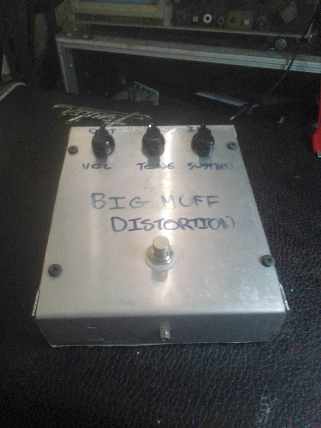

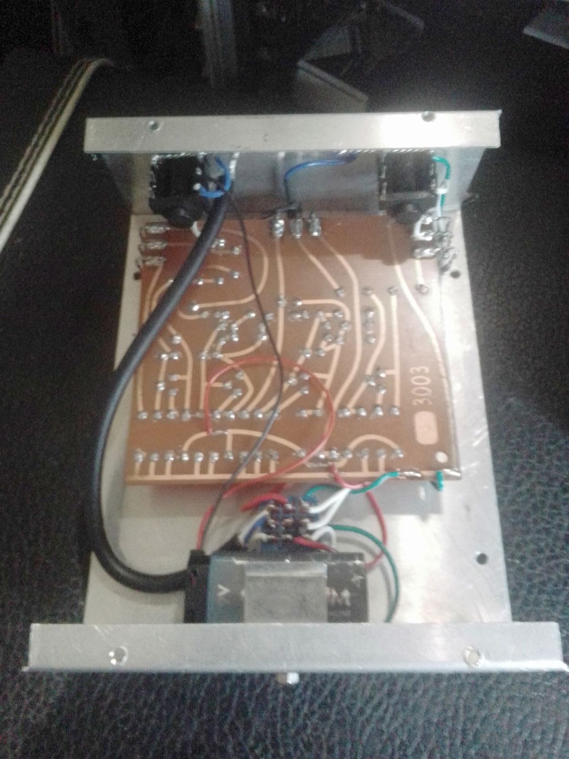

    Quick update on the Big Muff pedal build, I managed to finish building it and it worked perfect first time, had to swap two of the wires going to the tone control because it worked backwards, but, it's all sorted now, sounds great.
    I managed to take some pics of it so I could upload them to this thread, here you go, I still need to spray-paint/label/clear coat the sheet metal casing, but it is all working.

    Yeah, I'm very happy with how it sounds, seems to have more mids in the tone than a lot of the Big Muffs I've heard, which tend to sound mid-scooped, I went with the Ram's Head four-transistor circuit, but used four BC547C transistors, which seem to work fine, all four clipping diodes are standard 1N4148 small silicon types.
