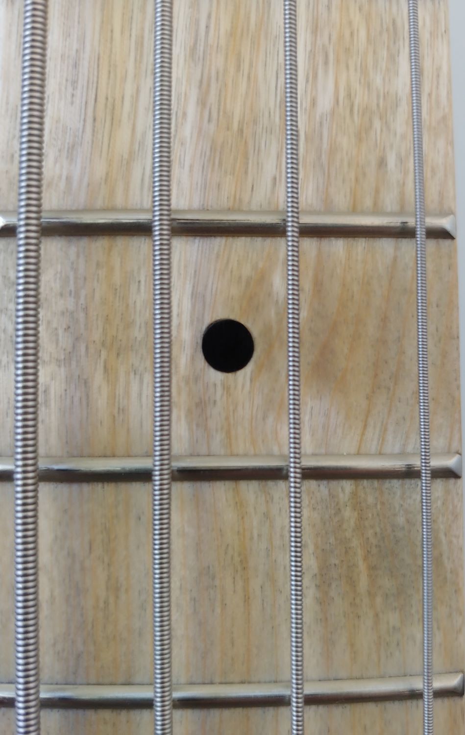

    First, the strings are wearing grooves in the frets really fast! An ideas on how to remedy this?

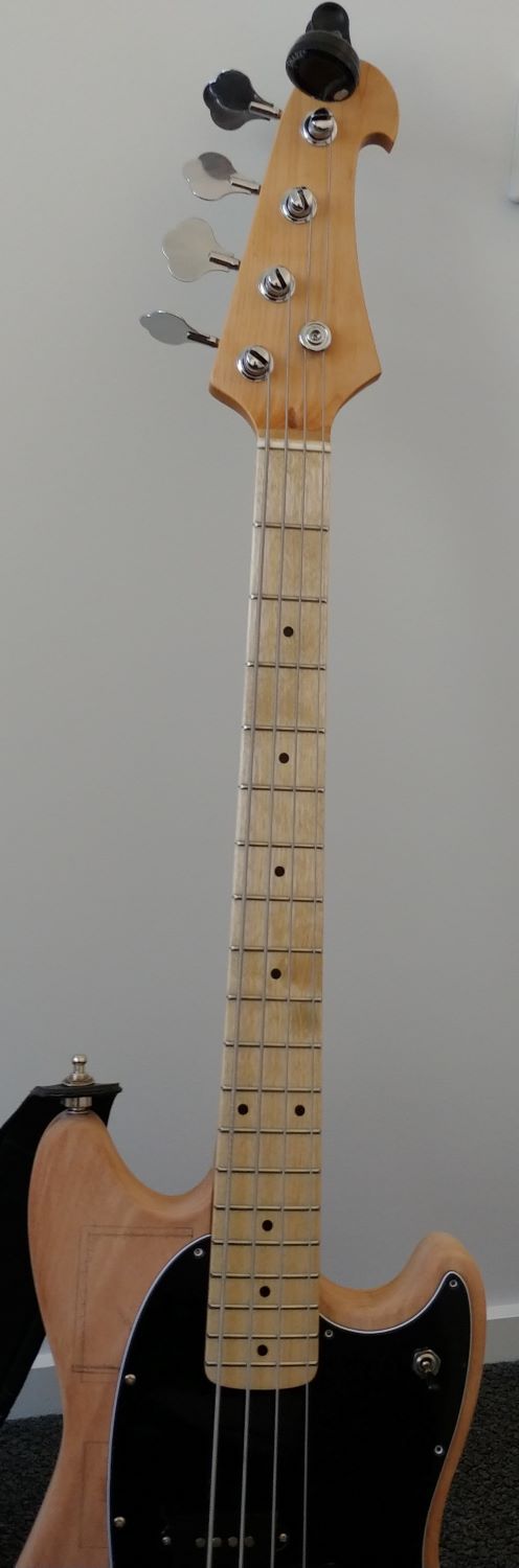

    Second, I did the fret job, then tung oiled the fret board. I did not do a good clean and the dust from the fret board got into the grain. It left the fret board a dirty grey. Frustrating. My own fault. Any thoughts on a remedy?
Name:	DMS-4 Photo2 resize.jpg
Name:	DMS-4 Photo1 resize.jpg
    Body is not yet finished. I am going to try including an Arduino based tuner and paint it surf mist with matt clear.
