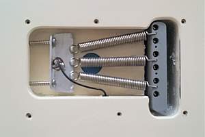

    Just Google for Strat trem cavity and you should get hundreds of pictures showing how the trem goes together. e.g.
Name:	Strat Trem Cavity 01 DSC_0081.jpg
    It needs the strings fitted before you can set it up at all, so it's one of the last things you'll do.
    You'll need to solder a ground lead to the trem claw in order to ground the strings and reduce electrical buzzing.
    Of the six screws holding down the front of the trem plate, only the two outer ones do the real work. The other four are really redundant and should be set a turn higher than the outer ones so they don't interfere in its operation.
