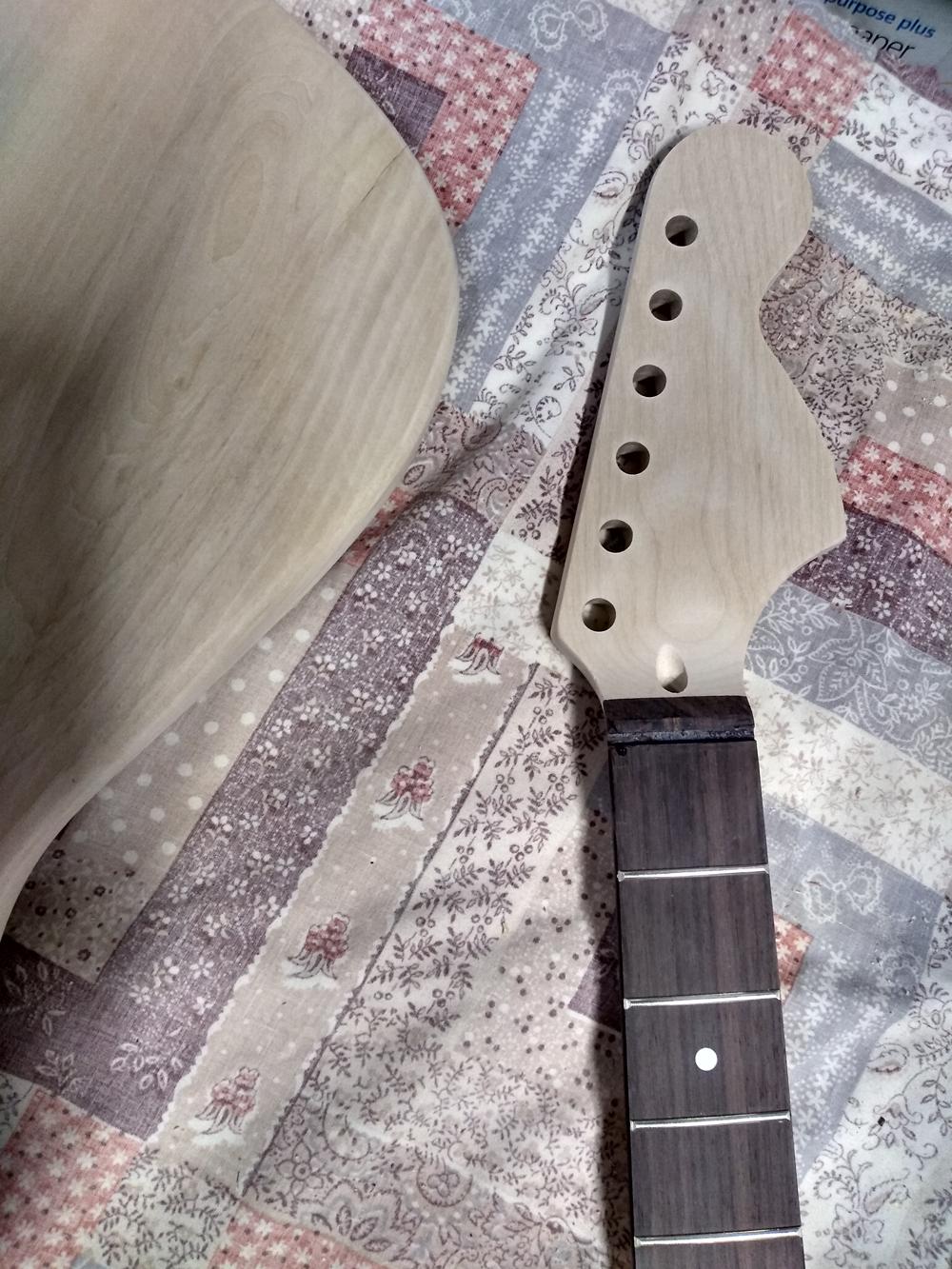

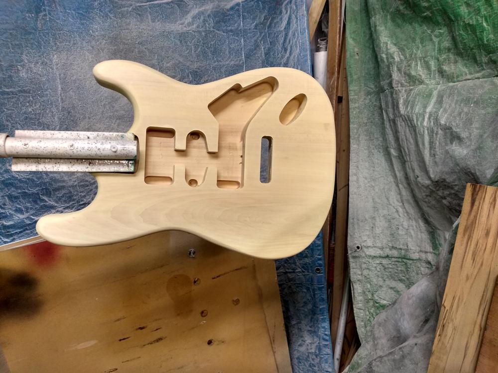

    A friend of mine is retiring at the end of this year. He is a guitarist and used to have a strat but it was a heavy ash one and he didnt like it. I have decided to make him a strat and picked the lighter basswood option. I also have an ulterior motive as I would like to test out a vintage butterscotch finish using tinted F&W liming paint. Keeping it standard at the moment and may upgrade things later. The neck fits quite well and the body is good. Here are some pics.

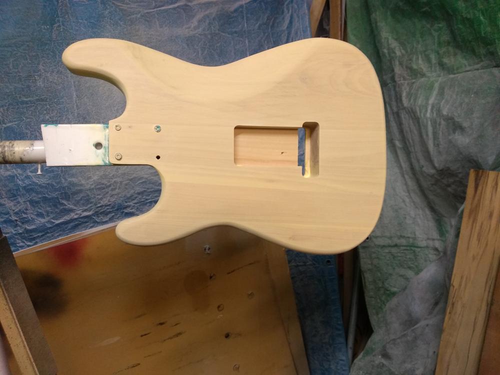

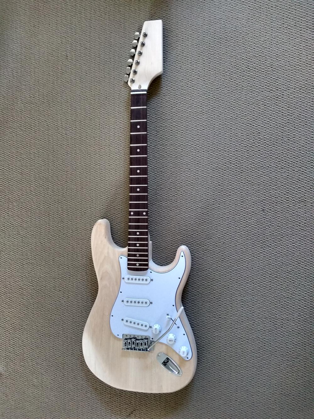

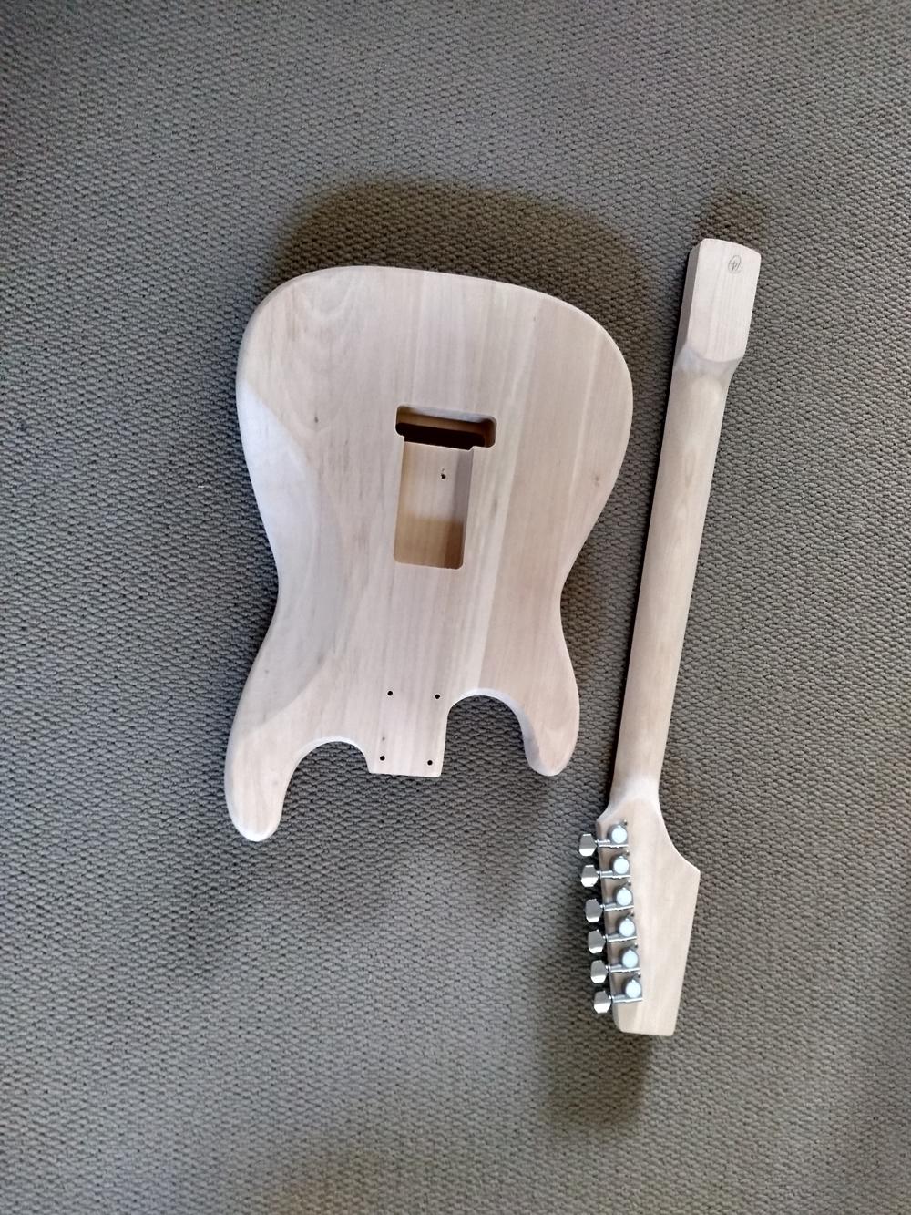

    Headstock shaped to roughly a strat but with a slight look of a tele. I hate removing those plastic nuts even though I take extreme care i always chip a bit of rosewood off which I have to supaglue back on.
    3 coats of FW liming paint tinted with FW golden teak. You leave the coats on for 5 to 10 minutes and then wipe off. It is sort of a blonde/butterscotch colour but I am happy with the result. Wont know until the the final acrylic clear goes on.
    Neck will have wipe on poly for a natural look.
