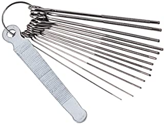

    You'll need to cut slots. I confess that I am about to do my first guitar nut. I have done bass nuts up to this point. I used needle files like these to cut the slots.
    This worked great on bass. Very easy and quick to get the slot to the right depth and unlike other files the bottom of the slot is round. Also I think these are pretty much the cheapest option. That said, my success with them may be because I was cutting bass nuts. Bass-sized files have more girth than they would for guitar. I worry a bit that when I do my first guitar nut (sometime this month, probably) the files may be a little too skinny to cut well. Will know soon ;-)
