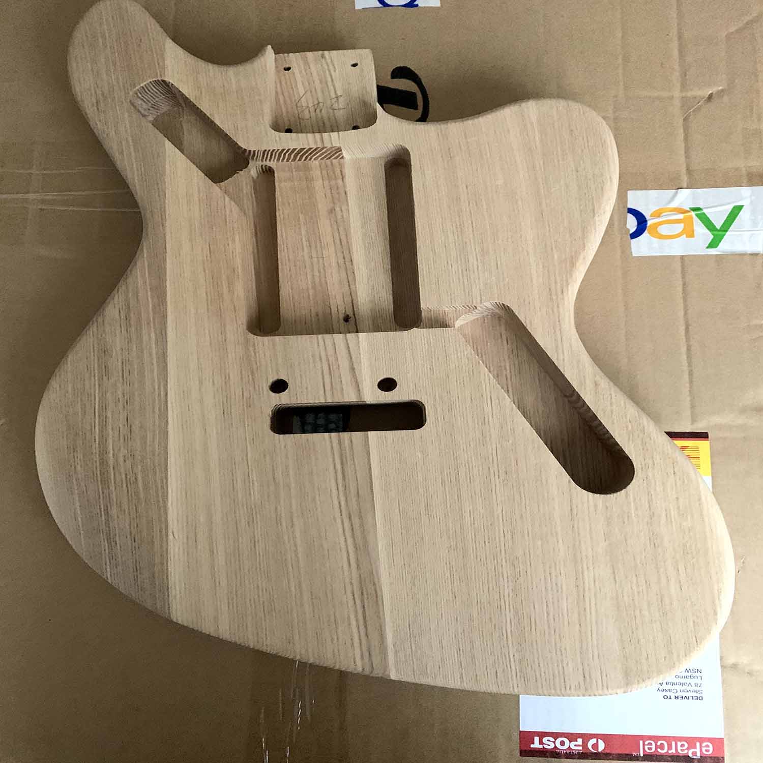

    Grand ideas, NOW I can always say "recommend a dry build first" because while I had ALL the parts, I realised Dum DUm Duuuuum. Missing pre-drilled post holes in the body for the bridge.
    Action: Contacted PB and almost an immediate response. New body is on its way should have it in a few days. Adam rang me back and asked for some pics to be emailed for the factory to see. Boom, sorted.

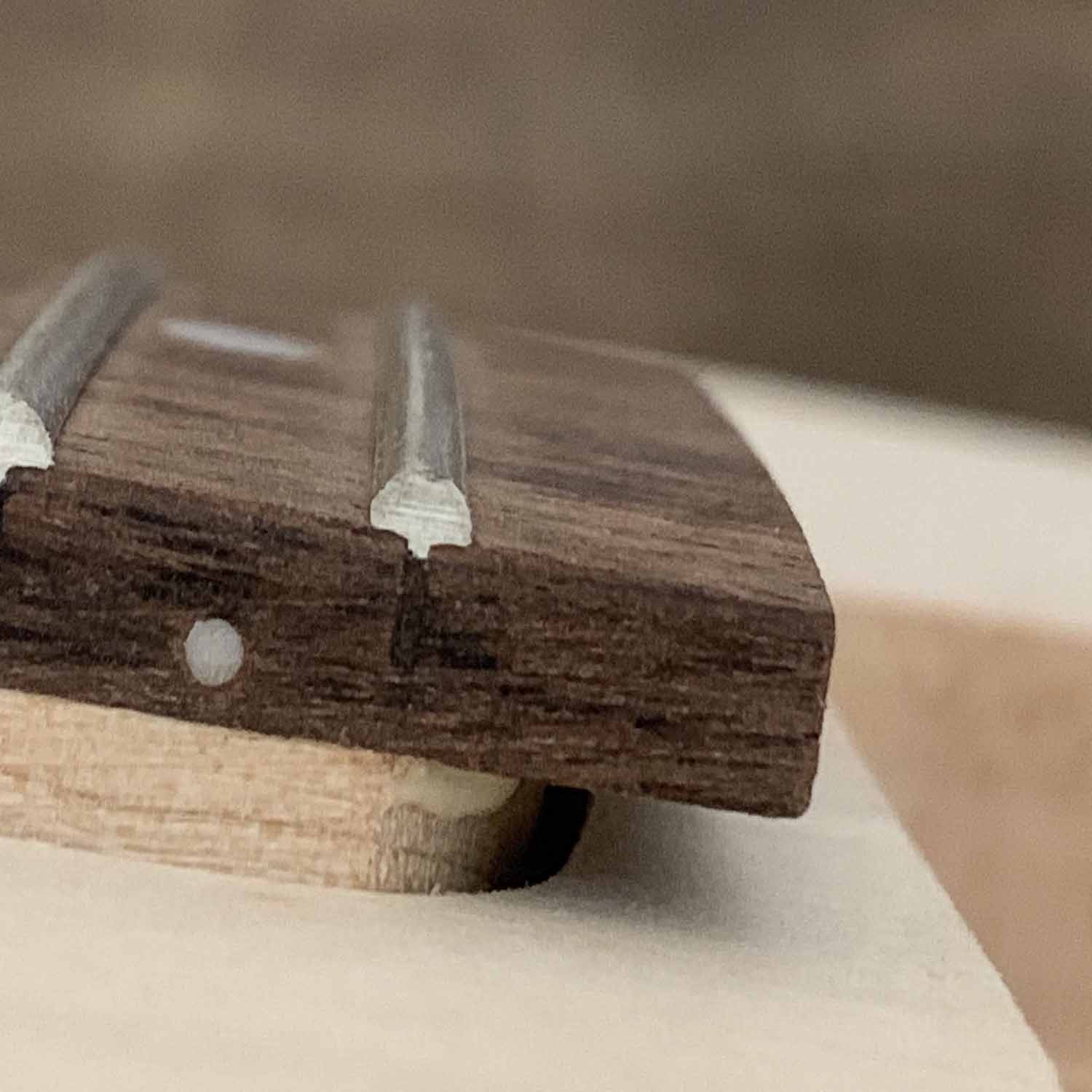

    Something else I noted immediately was that the neck does not sit snug all the way back in the pocket. After some quick forum advice (awesome forum by the way) I realised I have to sand the pocket. Now, Adam from PB wants the original body and neck back as a return, I won't be sanding anything for at least 2 more days.

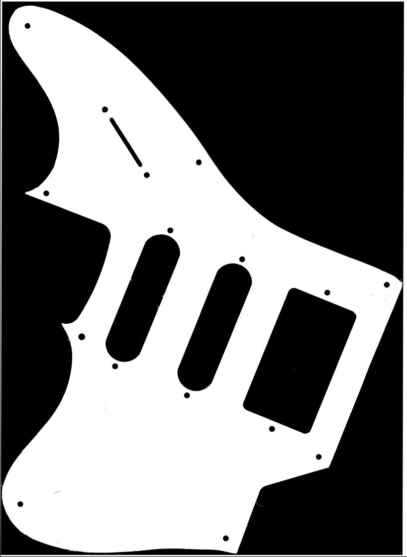

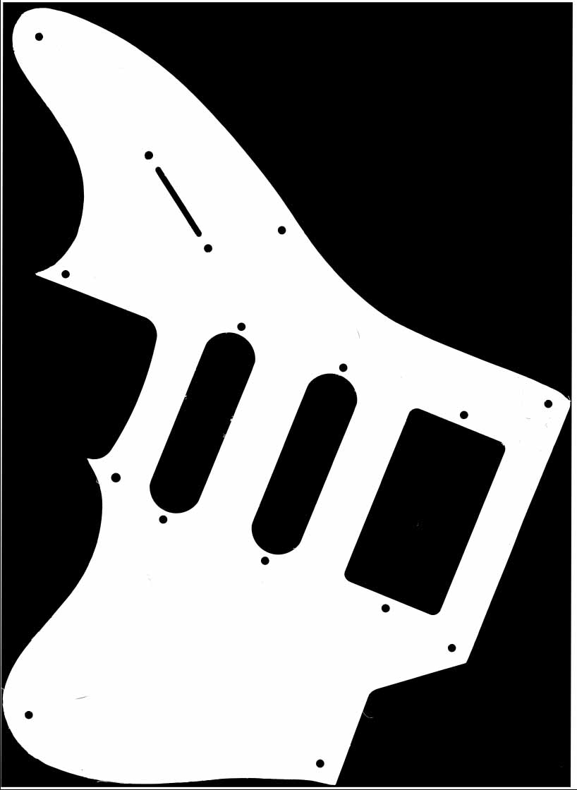

    PROBLEM: acrylic is hard to cut without making a chip in the edge, I had a quote to laser-cut a pick guard from a local guy. $240AU, that was making a Vector file, making a few prototypes in MDF and then the final cut. The cut itself was $20. Everything else was experiment and tracing.
    SOLUTION: It just so happened my Father in-law has a laser cutter...I know, don't ask.
    Anyway, he told me if:
    1. I scanned the underside of the guard, with a black piece of paper on top of it, I will get a really clear white image to cut. I scanned it and created a JPG and a BMP.
    2.I imported these into InkSCAPE (often used for 3D print rendering) and then took physical measurements of the centre of the screw holes on the guard from numerous points across the guard for reference.
    3.I then used the ruler function in InkScape to cross check the measurements I had made with my straight edge to the image in InkScape. InkScape works 1:1 ration export, so once I exported it to the LAser Cutting program, in this case "K40 Whisperer", it should be apples.
    4. After I opened the image in InkScape and made the image 1:1, I traced every screw hole and every pickup hole and the guard edge and the slider-switch hole as accurately as possible, within about .03mm in the colour red, because that is the colour "K40 Whisperer" identifies as a cut vector not an engrave vector. (Now this just made me think I can engrave a design in the pick guard also that will come through the mirror, anyway I digress.)
    5.Saved the file as a .SVG file and then imported it into K40 Whisperer to test it's load-in. BOOM, magic.
    6.Emailed to Father in-law and he will cut some MDF as a prototype while I wait for my acrylic to arrive.

    If you can use illustrator that’s ideal for creating laser cutting files. Just need to export as DXF- although it the cutter recognises SVG you save directly in that format as well. Generally scanners are 1:1, so I use that method a lot for making templates.
    Member caseyone1's Avatar
    Jan 2020
    St George, NSW
    42
    Hi Sonic,
    Yeah, I found the Illustrator really had a more simplified approach, it selected all teh vectors and I just changed their colour, then erased all traces of dust that were accidentally picked up in the scan. That said, my In-law was adamant I follow his method. I don;t think he was aware of the file type and illustrators power etc.
    Live and learn I guess.

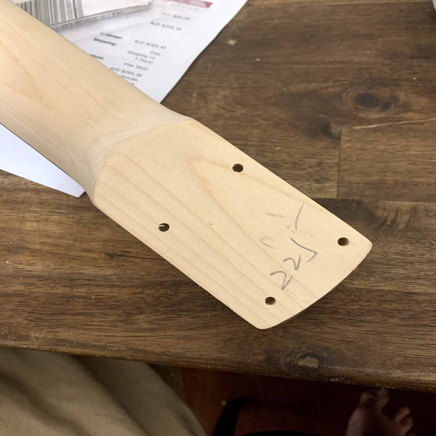

    I followed the instructions online, and while I was happy with the new body it wasn't as snug as the last neck and body. I did the dry build...
Name:	dry build.jpg
    ...it all matched up, the string distance to the edges of the fretboard were pretty consistent and so I drilled my neck bolt-on holes...
Name:	neck holesdrilled.jpg

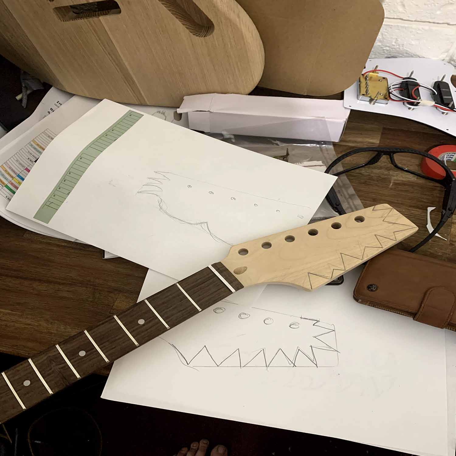

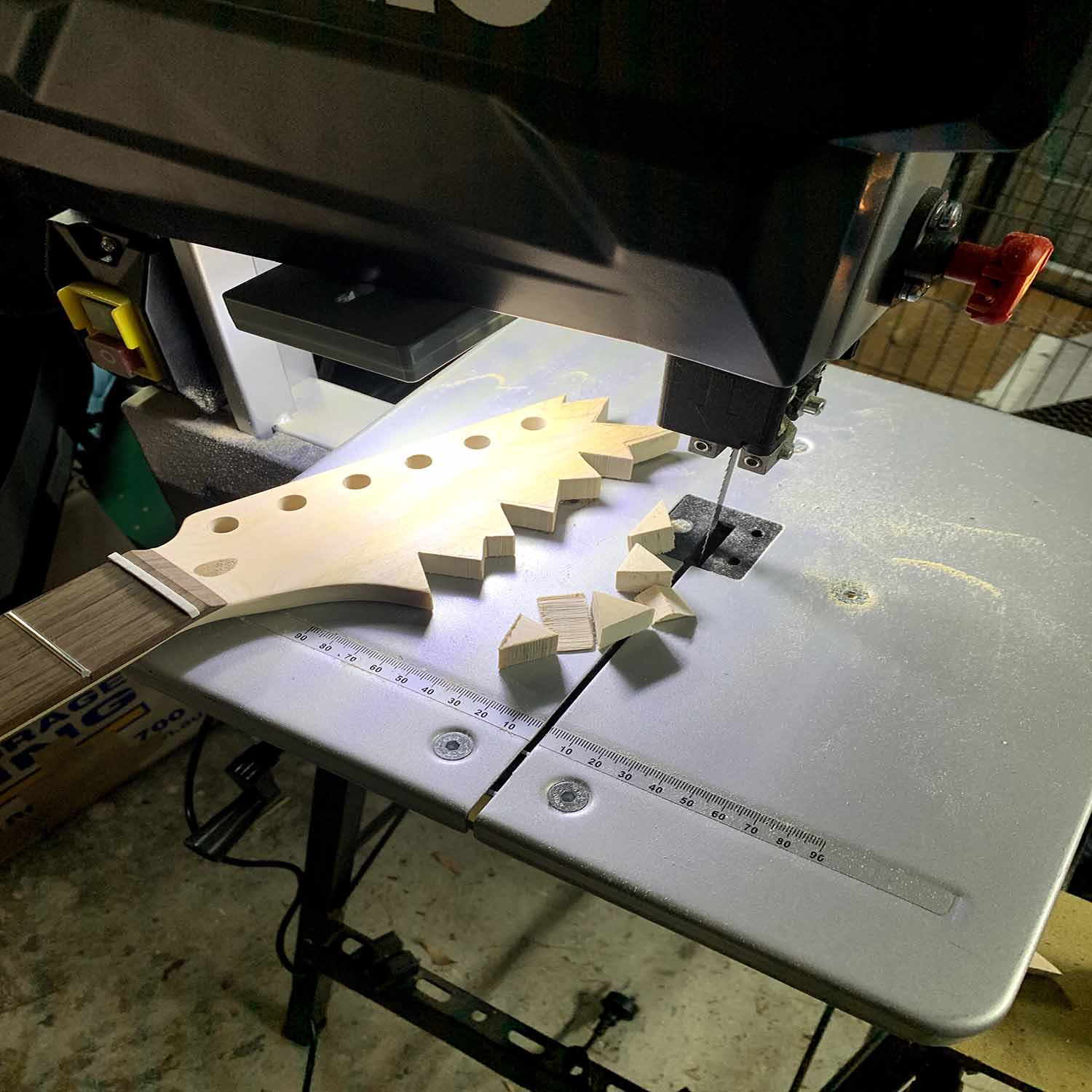

    ...I designed a machine head and pencilled it in and cut it.
Name:	machine head design.jpg
    ...Click image for larger version.

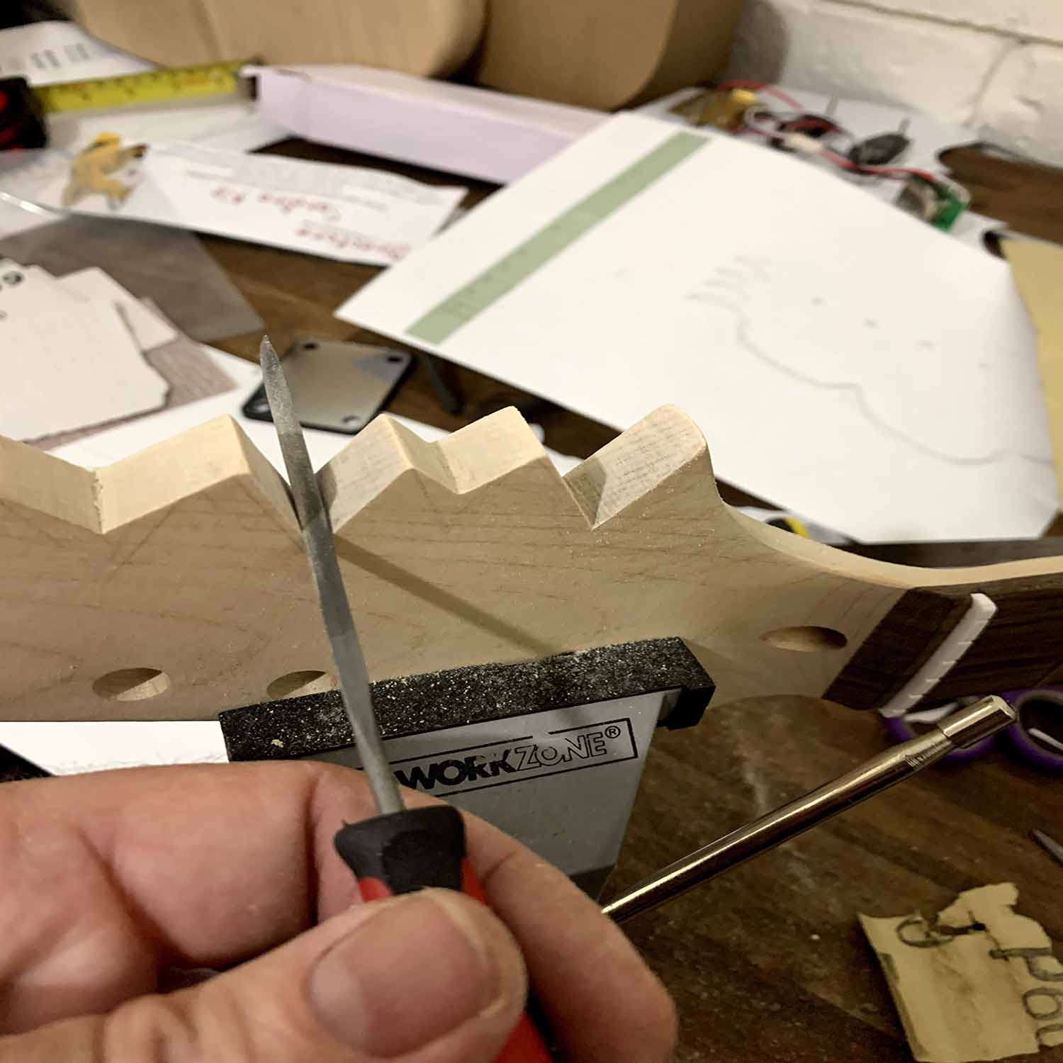

ID:	33293..So here is a tip, if you go for a sharp look like I did, you are going to have a heap of sanding away tool marks on lots of edges.
    Issue #1, getting in all the crevices deep enough to sand away all the tool marks...I had to wrap the sandpaper around some small jewellers files and also do stuff by hand, I will put the pics in the following post...

    ...So here is the sanding stuff for the machine head...Click image for larger version.
Name:	filing out deep tool marks.jpg

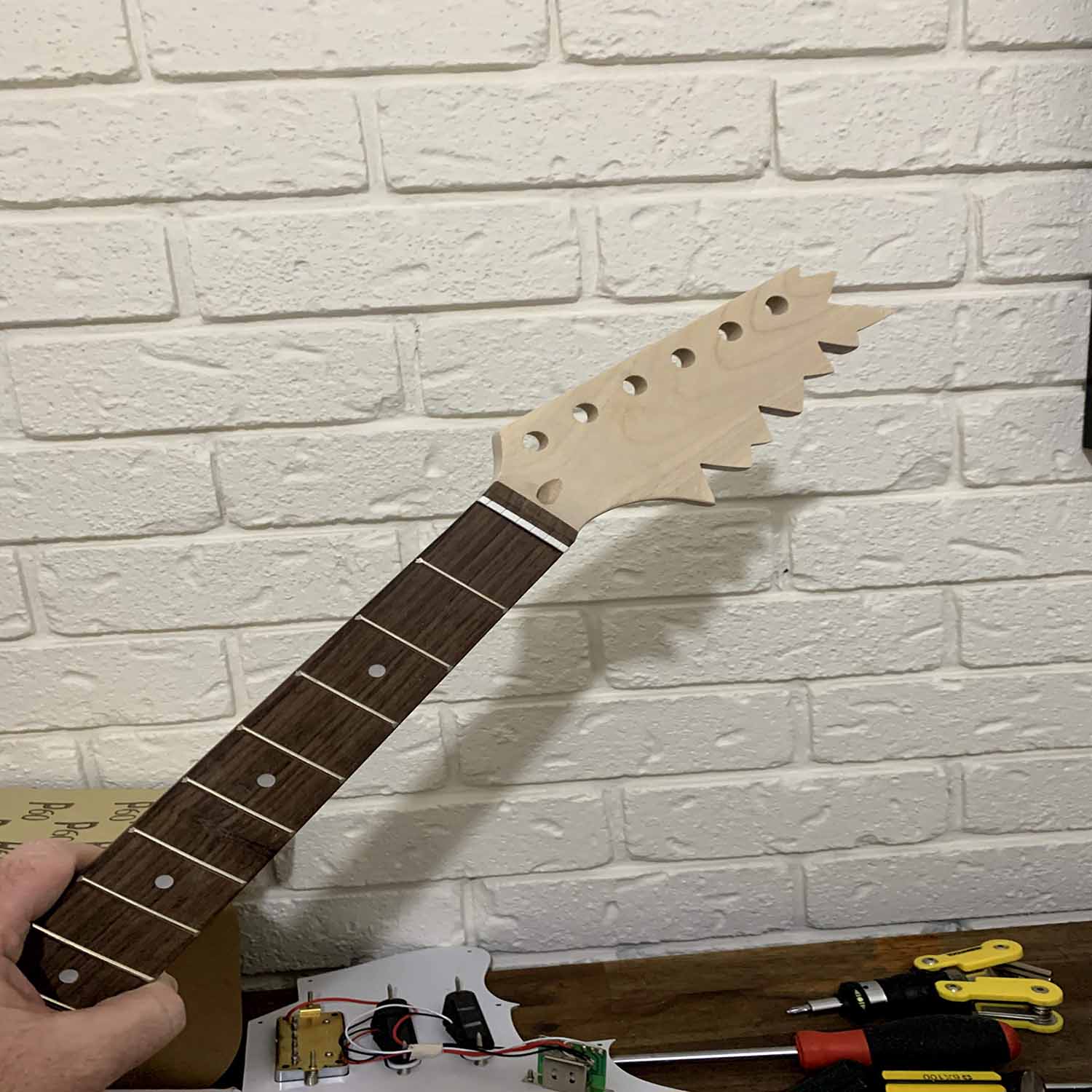

    Eventually I got to finish it up.
    Another tip: sharp little points can be chipped off and made blunt. Probably wouldn't choose this again as a method of shaping.
    So what was once clean sharp cuts and points, some are a little blunter...
    Finished machine head and sanded.Click image for larger version.
