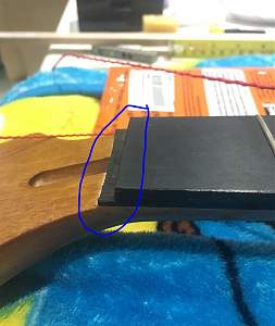

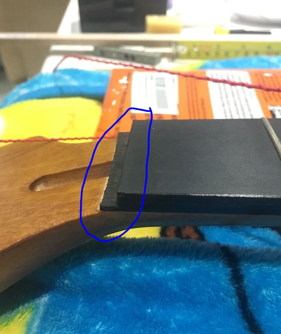

    1. I have been meticulously getting everything ready for tonight and the body is all wired up and ready to go. I installed the machine head and neck this evening and while I was getting ready to string I noticed something that almost made me cry ....
    The nut is missing (((( I had a good look through all the remaining parts along with the box that it came in and cant find it anywhere .... (see pic below).
    Does anyone have any ideas on how I can make one, or do I need to buy something? Sooo sad right now ... boooo ...

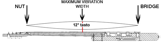

    As Brendan says, action is really down to the player's preference. I'm a low action person and I play fairly gently. But some players really like to pluck hard at the strings, which gives them a lot of amplitude. The bigger the amplitude, the more neck relief you need to stop the strings catching the frets, and the higher off the fretboard the strings need to be.
    The amount the strings vibrate is very exaggerated in that diagram, but you can see that the bigger the amplitude of vibration, the more the neck needs to curve for the middle of the vibrating part of the string to not hit the frets.
