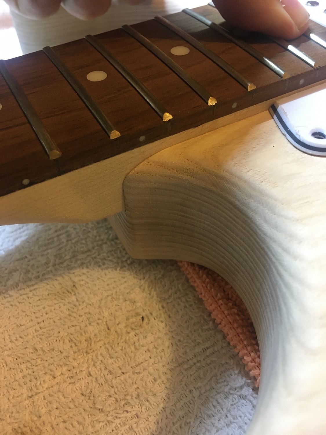

    Hi all, so I'm about to start my first build, a lovely GST-1 Strat kit. So far I'm pretty impressed with the quality of the Pitbull kit. I'm slowly stepping through the build manual that I found on the Pitbull site. Is there any further info for the ST kits themselves?

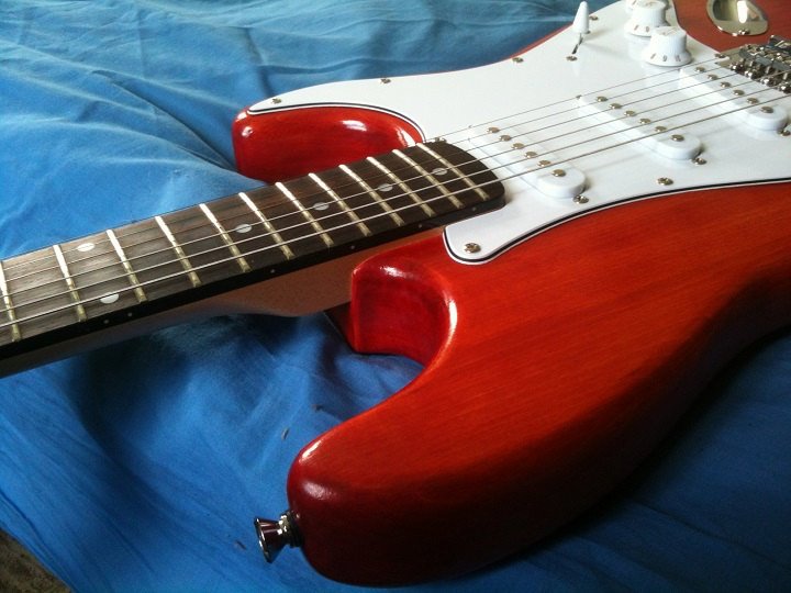

    I also have some questions regarding what to use for finishes. Below you'll see a couple of pics of my kit, and then one which I found online (on this forum somewhere a while ago if I remember correctly) that shows the look that I want to achieve. Essentially I want to get a colour close to the Fender Hot Rod Red, but still want to allow the pattern of the body grain to show through, and then have a nice smooth glossy finish over it. I'm thinking of using FW's Tung oil, then a stain, and then FW's Wipe on Gloss Poly. Thoughts on this? There seem to be so many options for finishing, so looking for some good advice on this one.

    Hi and welcome.
    Your finish plans seem a bit strange to me. You'd normally use either tung oil or wipe-on poly, but not both, And you'd certainly stain the wood first otherwise you'd just put stain the top of the tung oil.
    You've got an ash body, so that will definitely need grain filling if you want a smooth shiny finish as shown in your photo. Grain fill, stain, then apply either tung oil or wipe-on poly.

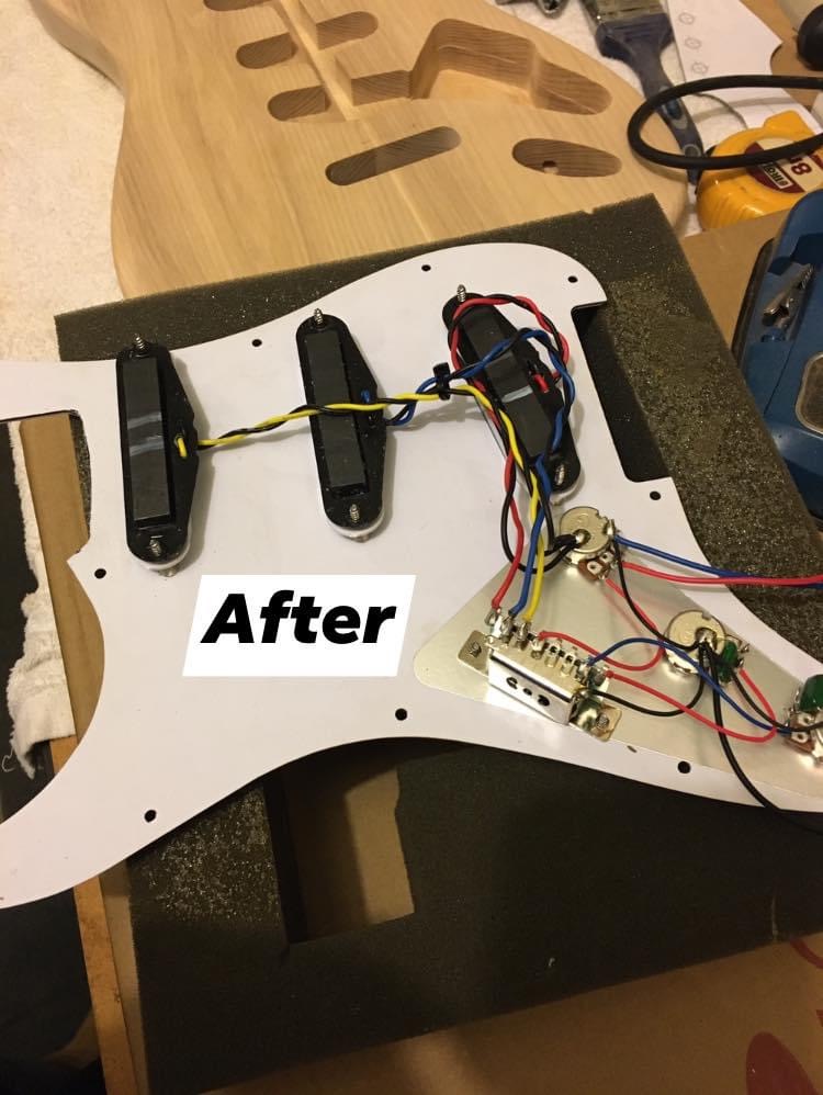

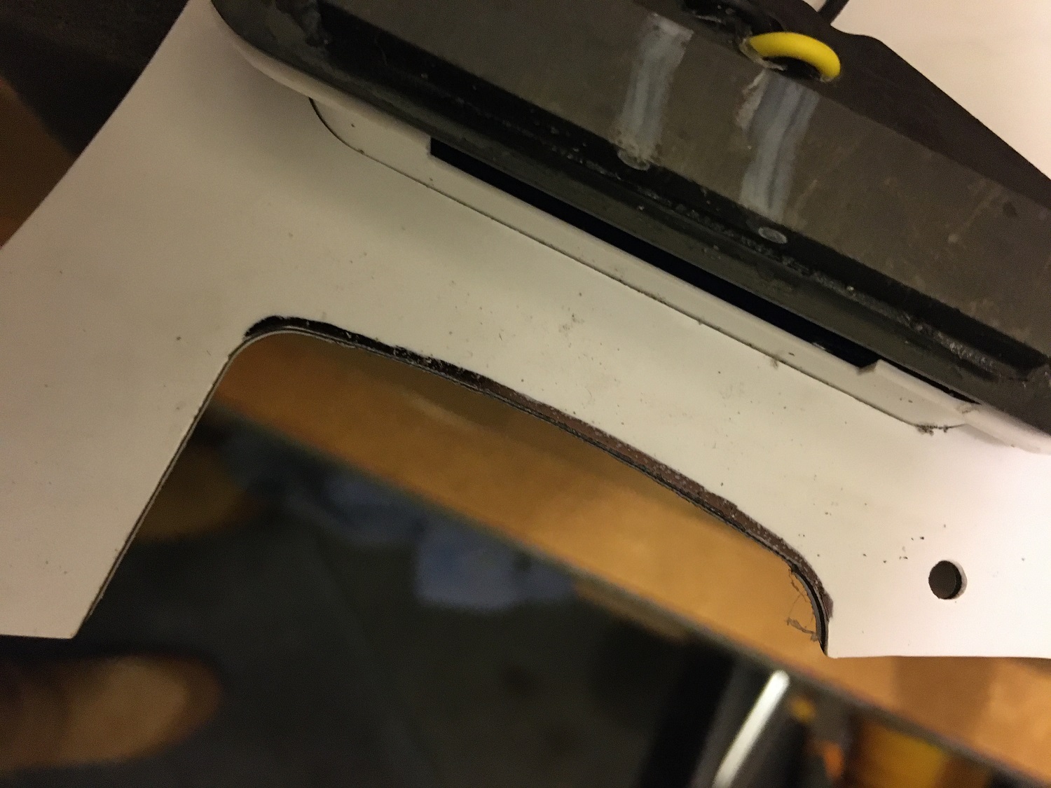

    Got a small amount of time to work on the kit last night. I decided to do a bit of tidying up of the wiring on the pickguard, as well as shaving (filing) some off around the heel of the neck, which should allow me to get the guard situated a bit better to completely cover the pickup routes and give the bridge a little bit of room to move.
