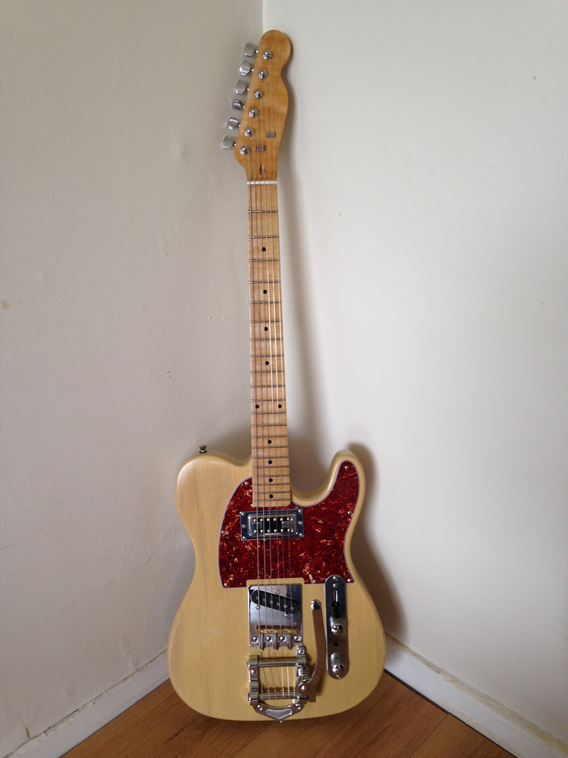

    I have built a Tele from a kit before which went through a few manifestations before ending up like this:-

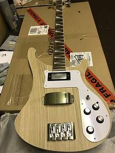

    Obligatory test fit pic :-

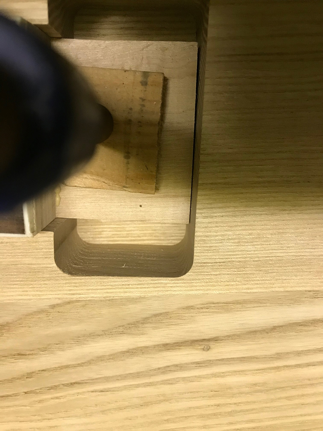

    Quick question - I have had the neck clamped in place to make a start on locating the bridge.
    I know some people had problems with the end of the heel being out of square and needing some remedial work.
    I have this problem but only to the tune of around 1mm resulting in a small tapered gap like this:-

    Anyway, is this worth worrying about or will the gap just fill with glue when I come to fit the neck properly.

    Hi Gary,
    First, I'd like to say that I have not done a RC build. so my comments are quite general.
    The square of the heel does not need to butt up against the pup rout. That being said I would probably shim it with pieces of veneer because I am OCD like that.
    I also don't think that how square it is to the pup rout is a good indication of whether the neck is in line. I would first make sure that the positioning of the neck does not impede the neck pup surround and that pickguard. then get the bridge placement right in accordance with the scale length. maybe sit it there with some double sided tape

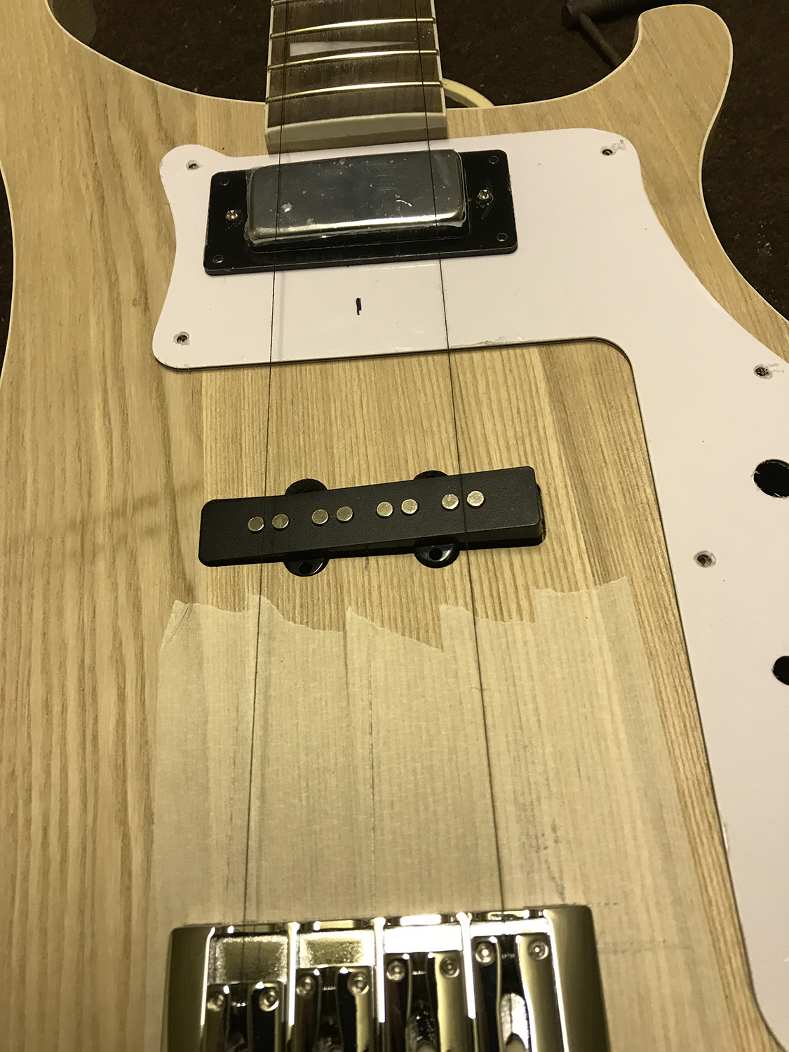

    I would then use two pieces of string (or fishing line) in the high and low string saddles to run from the bridge, through the nut and to the machine heads. then use that method to align the neck and the bridge so it is square and the the high and low strings run equally down the neck.
    Theres a good photo of this method on Marcel's black SG.
    Thats one way of doing it, happy to stand corrected on a better method.

    I did test fit the neck pup and pickguard. As it happens the neck can only move a few mm backwards and forwards as I think the heel and socket are slightly tapered. It is a very nice fit. The pup has plenty of room to adjust to suit wherever the neck ends up.
    Having offered everything up again it looks like the neck is best moved further from the body as the pickguard then follows the body shape better and looking at photos of other builds the frets meet the body at the right spot.
    Having done that I then did what you suggested and lined the bridge up using some cotton thread.
    Everything seems to line up sweetly :-
