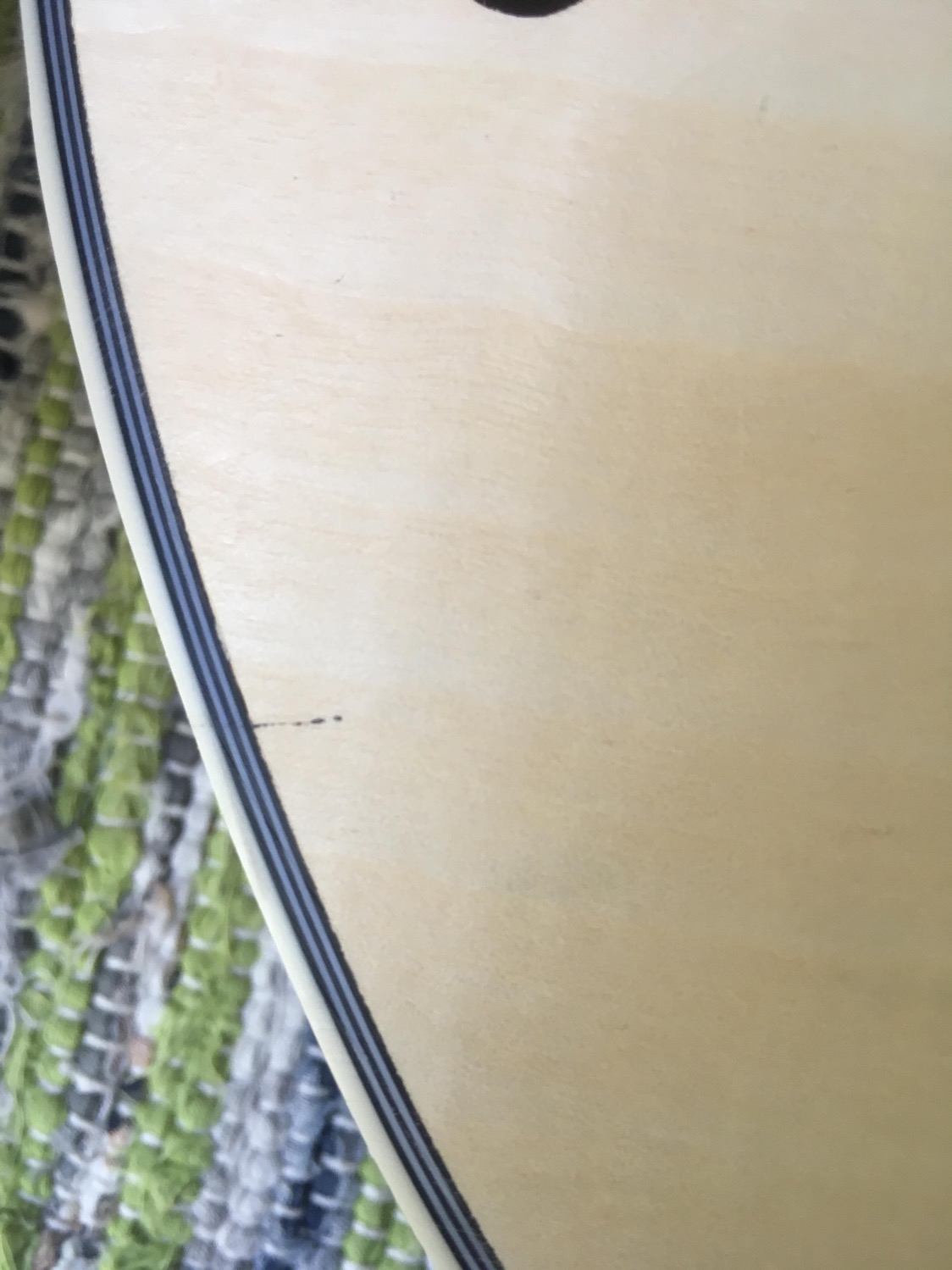

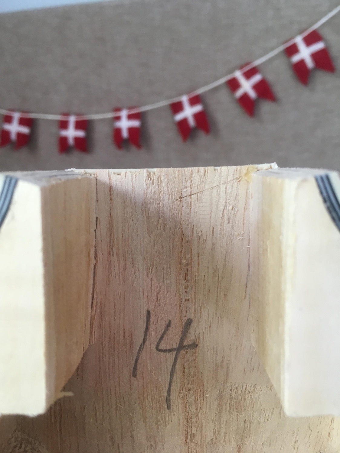

    The neck seems to slot in pretty tight, looks pretty right to go...but before I start sanding...anyone see something I don’t? Is that neck pocket unevenness okay?
    Some people use a G-clamp holding on to the inside faces of the two pickup routs and suspend the guitar from that. It is still a bit of a balancing act. I just did one side of the body at a time on mine. A bit slower, but easier.
    If you build a wiring harness using stiff wire with no excess cable lengths, you can put the electrics inside the guitar using just your fingers and some needle-nose pliers. I've done it. Some cotton around the toggle switch helps but it's not really necessary.
    The neck really is simple as you can't go wrong with position.
    I'd smooth the bottom of the pocket out a bit, but not too much. The small 'wings' on the top of the neck cut-out by the fretboard will hold the bottom of the neck off the bottom off the pocket if you aren't careful are remove too much wood just in order to get it smooth. Which is why you need a few good clamps to hold everything together when gluing it in, and leave it for the full 24 hours before removing them as the neck joint will be under tension.
    If in doubt and there is a bit of a gap, you can stick a thin piece of maple veneer in the bottom of the pocket first and sand that back a bit if necessary. But make sure that gets the full 24-hour clamp treatment as well.
    I've just glued the neck in on my ES-1 and it's fine.

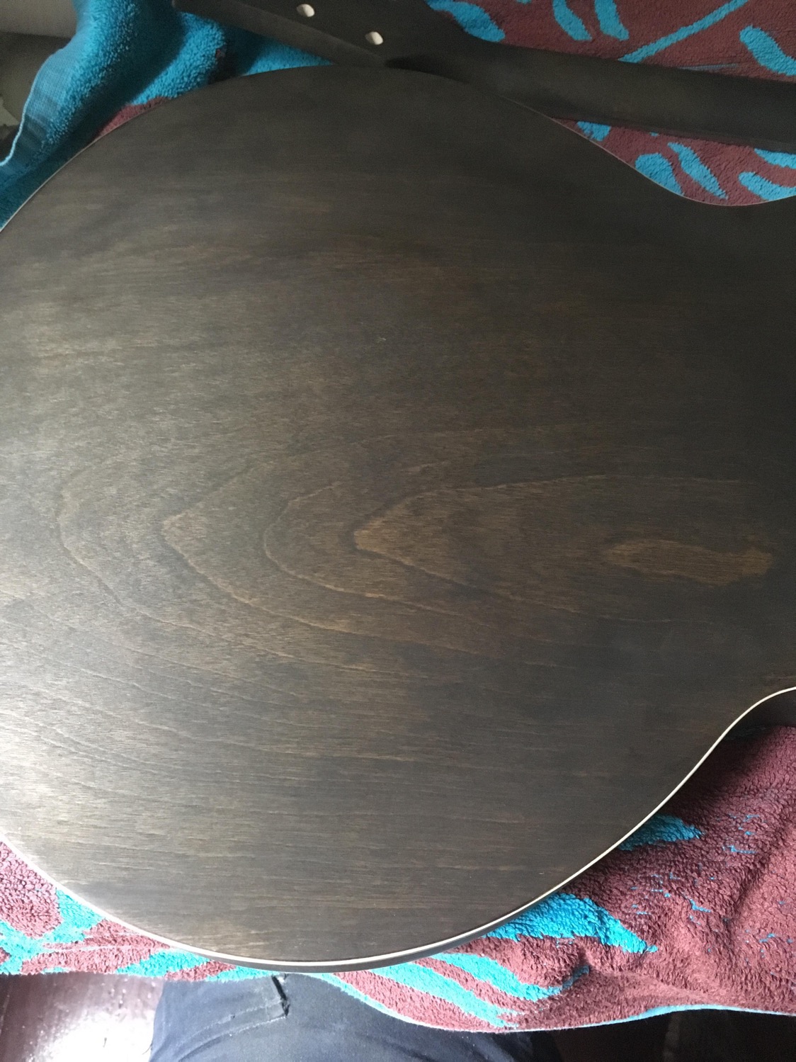

    I’v been making a real hash of it.
    At first all was well, didn’t think there was much in the way of glue marks....obviously I was wrong.
    Sanding went well, staining on the back went well. Really happy with it.

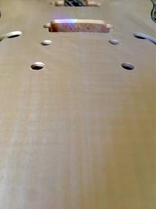

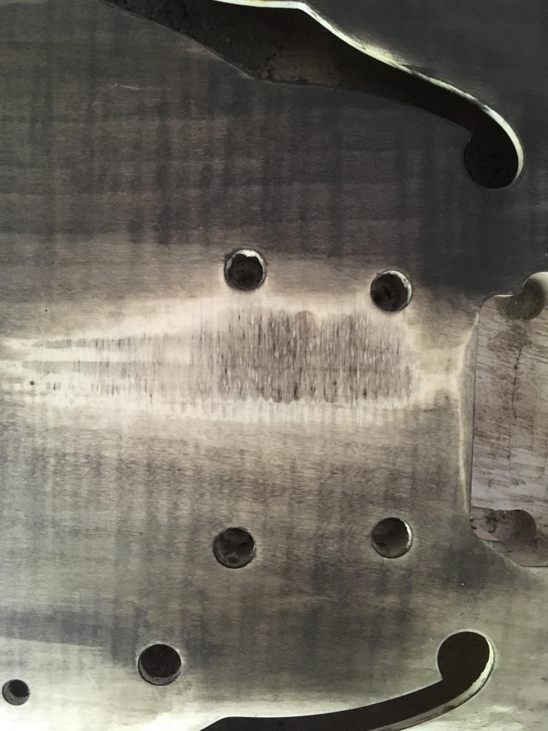

    The front showed some really messy glue stains pretty much all over, heavy through the join in the veneer, then splatters pretty much everywhere.
    Okay I thought, I’m not attached to the veneer and I actually like thhe figuring on the back better any way...I’ll just sand through.
    Now...this was going okay getting a nice grain coming through....but then these shiny patches emerged that seemed to be under the grain or something.
    Now...is this glue that I should just sand through or remove in some way? Or am I know in ‘find out how to paint solid colours’ territory?

    Well, you have sanded through the veneer, so this would have been the glue holding the veneer to the top. If you keep sanding the veneer off it will be sanded off.
    Had a go at it....think it might be completely soaked into the timber underneath.

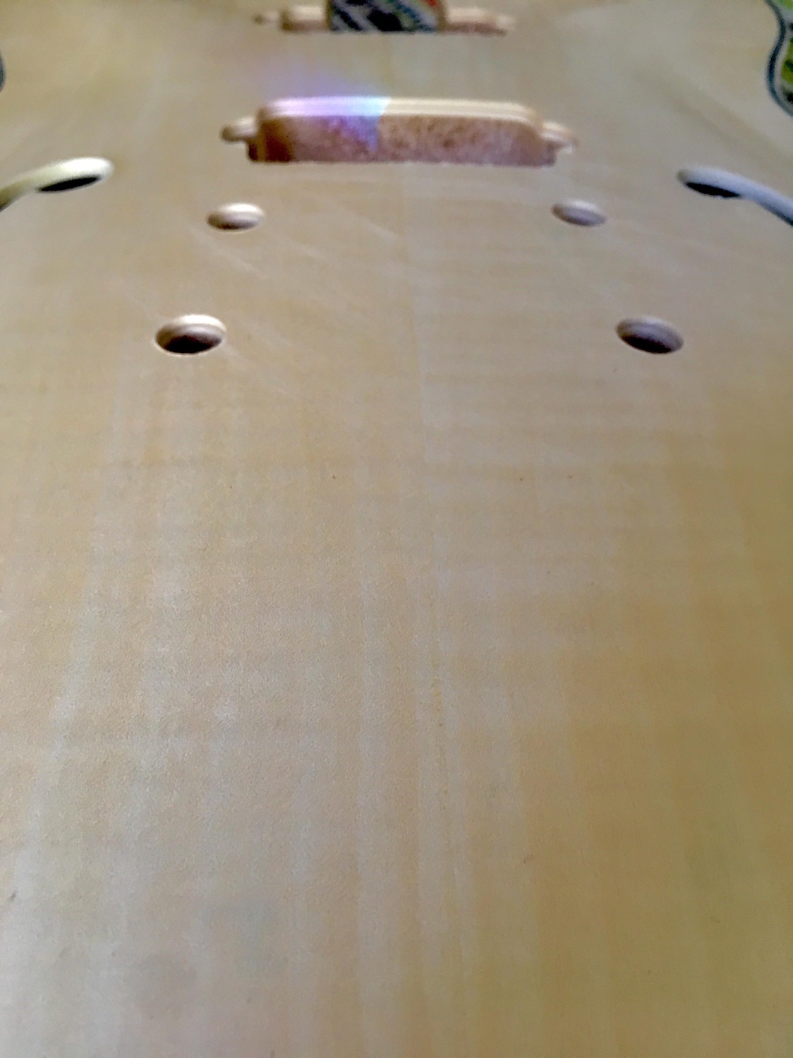

    Anyway, warming to the idea of a gold top, so went and picked up some grey primer, aurora gold, and a couple of cans of clear. Now for a warm day. Don’t know...might be waiting a while in the hills.

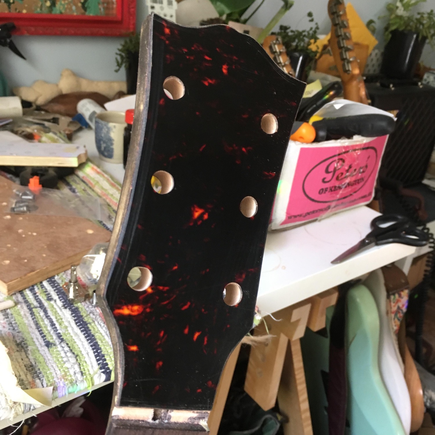

    In the meantime I’ve had a go polishing up the headstock with 1500, 2000 then turtle wax polish.
    Looking pretty good.

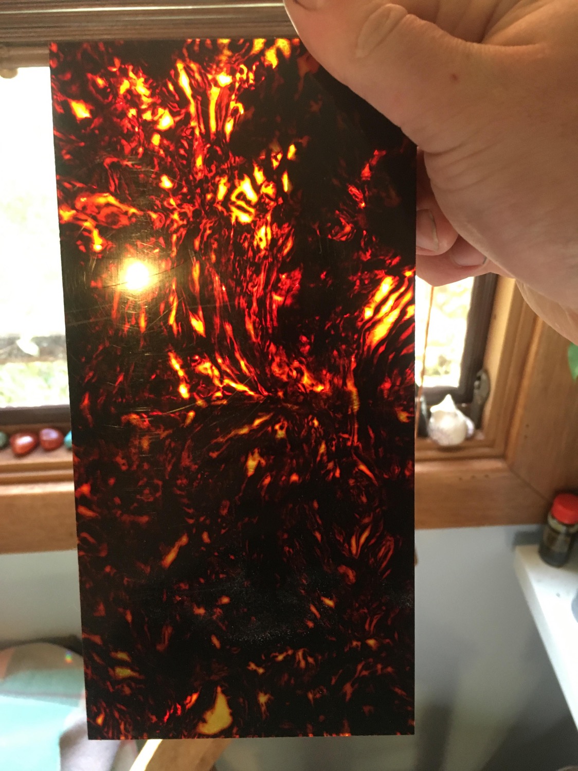

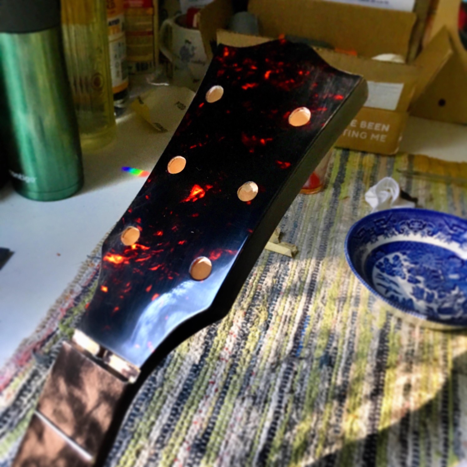

    Decided to abandon the front for the moment as my headstock veneers came early.

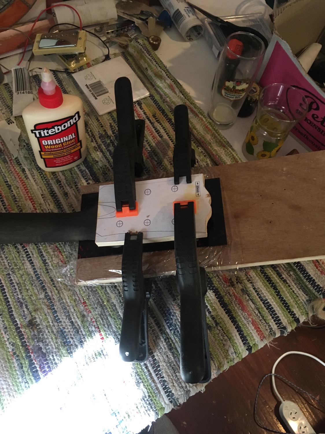

    This went a lot easier than last time with timber.
    Just gotta cut the hole for the truss rod and polish it up now. Heard brass polish is good for this....anyone else done it before?

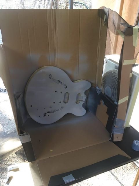

    My thinking with the body is to leave the sides and the back how they are and do a solid gold top.
    Never done this before so any advice would be welcome.
    Thinking it is a 1. Sand it smooth. 2. Prime it. 3. Colour it. Clear coat it. 4. Wet sand. 5. Polishing
    Think im going to with just acrylic from duplicolor.
    Might do some kind of gold glitter clear on the back and sides too.
    Oh, yeah, headstock looks nice
