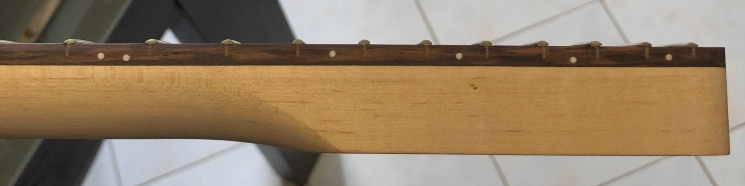

    Also, has anybody else experienced the fret markers on the edge of the fingerboard being installed at random heights across the board? I would imagine that this is something I'm going to have to learn to live with but was a bit of a shock when I opened the box.
    This is the fellow that used to drill the headstock tuner holes, so in that regard I guess you could count yourself lucky?

    The side markers offer you your first choice. You can buy a set of fine drill bits and drill them out, centralise a new set of holes having filled the first ones, and glue your own new ones in. Or, your can shake your head and just move on.
    Building is full of these frustrations. Kits are made to a price point and you will find lots of these little things. Sorry.

    That’s great feedback about the dots though, I hadn’t thought about drilling them out and putting slightly larger ones in. I’ll see how much it bothers me down the track and have a crack at it if I can’t live with it.
