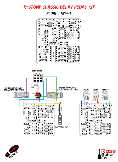

    I'm totally new to this, and bought this cheap delay pedal kit off eBay for the soldering practice. I had a pretty good run at soldering all the components to the PCB, but I'm totally flummoxed by this wiring diagram they included.
Name:	R Stomp delay pedal.png
    It's pixelated to buggery, and I don't know enough about wiring to understand what I'm looking at. This is what I THINK is happening, but if someone could correct me I'd really appreciate it...
    The three lugs on the left hand side of the 3PDT switch are circuit input, guitar input and a jumper
    The three lugs on the right are circuit output, guitar output, and the other side of the jumper
    The middle three lugs confuse me. There is obviously a connection from the DC jack through the resistor and the LED, and then I'm assuming red lines are power connections, so the red line to the circuit is taking power from the jack (or battery) to the circuit?
    Then the battery connections and grounds completely confuse me. I think the black battery connection is going to the top most lug on the input jack (yellow line)? And the red battery connection is going to the DC jack? Then I assume all the green lines are ground wires, and they all connect to the input jack?

    From what I can tell by using Windows 10's Photos application to enlarge the photo, the middle solder-lug of the 3PDT Footswitch is connected to the circuit-ground connection of the DC In socket, the other solder-lug directly below it is connected to the Led via a current-limiting resistor, hope that helps.

    One more question, but should there be a connection from the 'out' of the circuit (top right of PCB) to the 3PDT switch? I hadn't noticed there wasn't one listed as I was so caught up trying to figure out what the lines all meant, but now I look at it, surely there needs to be some output from the circuit, right?
    I noticed that too, so I think you're quite correct, it looks to me that whoever drew the wiring diagram forgot to include a wire going from the output pad on the PCB to the spare un-used solder lug on the 3PDT footswitch, so, if you connect a piece of wire up between those two points it should work fine, just remember to solder the wire to the signal out pad rather than the ground pad.

    Out on PCB is connected to the bottom left unused lug on the switch.
    The middle unused lug on the top row of the switch becomes 0V or earth when the switch is off or in bypass mode. That switch assembly is actually three vertical 2 position switches with the common of the switches along the horizontal centre line. When the switch is OFF the input jack is connected to the output jack via the jump wire thus creating the 'true bypass'. When the switch is ON the input jack is connected to the input on the PCB, the output of the PCB is connected to the output jack, and the 0V or earth is connected to the LED turning the LED on as it has the Red battery +ve or 9V plugpack connected to its other side.
  10. Liked by: JohnH
    Worth checking the track side of the PCB to see if the two holes that seem to be labelled 'out' are connected to the same track. If they aren't, then you might need to trace or use a multimeter to test if one of them is connected to the board's common ground, in which case the other is the one to use.
