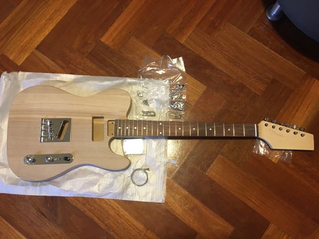

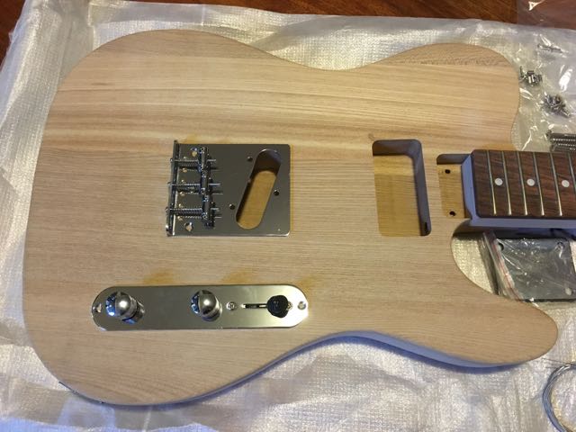

    Replacement kit has just arrived from PitBull (from the previous build that was not so successful) - a nice TLA-1 kit with a maple neck with Rosewood fret board.

    The kit has chrome hardware and the plan is to use the Bondi Blue dingo tone for the body with a black burst using Black Stump dingo tone. Hopefully I will have enough left to do a second build. Actually I will have to drop dingobass a line to see if DT2 is compatible with DT 1.

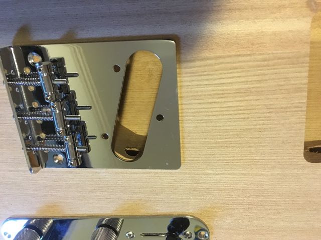

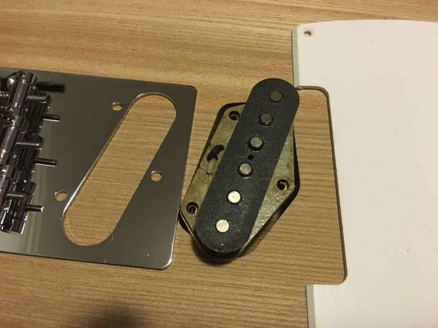

    There are a few corrections needed on close inspection. The bridge pickup route needs to be expanded to fit the Tonerider pick up and clear the cut out in the bridge.

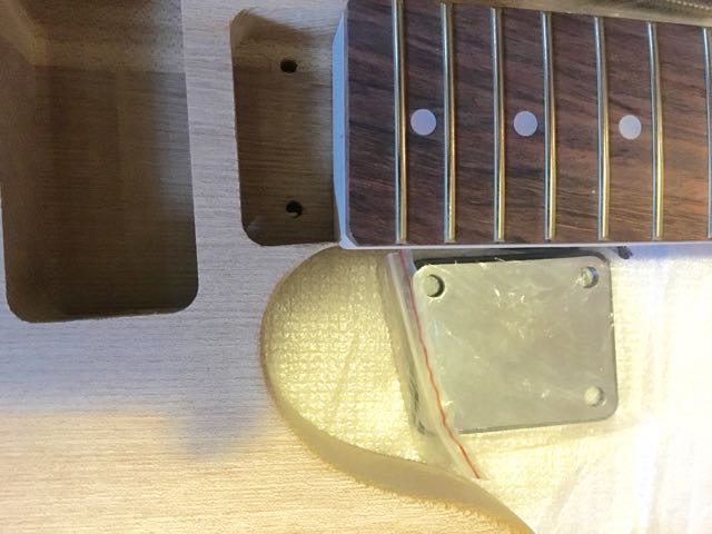

    The neck is also bigger than the pocket so I will need to chisel/file out a fraction on either side after finding the centre line of the guitar.
    The neck is in good shape though, compared to the last one which ended the previous build. Frets are well seated, fretboard is even and nicely arched.

    May I suggest that it is better to remove a touch off both sides of the neck heel rather than attacking the pocket..
    Not only is it easier to do this you have less chance of taking too much off.
    And no worries with MI and MII compatability.
    good stuff Marze, how much wider is the neck than the pocket ? maybe you can sand if its 1mm of less. Be careful not to take too much off with a chisel or split the timber.
    Be worth doing a mock build once you got the neck in the pocket and bridge pup and bridge in place. Majority of the tele kits the bridge pup cavity is about 5mm too far south
    Thank for the suggestion DB, I was thinking of doing this as well. So I will look at this first.The neck looks to be about 1.25 mm too wide. I was a little concerned about buggering up the frets, but it will be OK with sanding I guess.
    As DB said - SNAP.
    I will check the position of the bridge pup cavity as well once the neck is in place. Off to start the sanding ...

    good stuff Marze, won't take long to take off about 0.6mm of each side of the neck heel. 80 grit paper will rip it off pretty quick.
    Good tip is to test the fit in the pocket regularly so you don't take too much off - I good tight neck heel will give you good sustain.
    If you are using the PBG bridge the intonation may work out ok. They have pretty long saddle screws.
    Anyway good luck with the sanding - think the ash grain should come up really nice on this kit !
    Are you going to grain fill it with Timbermate ? for the maximum popping factor we recommend ebony timbermate !
    As the fret board sits higher than the body you won't have to touch the frets, just the timber of the neck. I used sand paper, it's slower and less chance of "oops"
