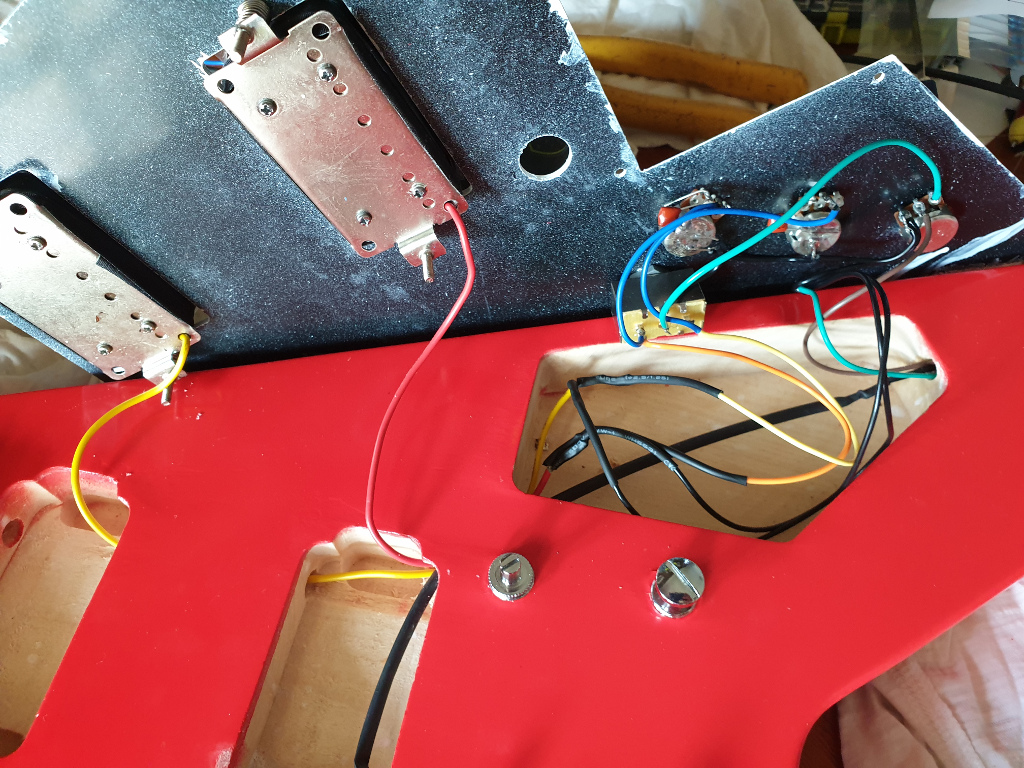

    I've already got it assembled, but can tell you that it did come with two caps and I've wired it as two tone knobs. That said, I'm probably going to have to pull it apart again as I seem to have a bit of a buzz/hum which may be some sort of grounding issue. Weird thing is that I don't have it all the time. I get it all the time when using the bridge pickup, but if I flick the switch to both pickups, and turn the tone pot to minimum treble, the hum goes away - but it comes back if I adjust the tone pot with more treble. It's a strange one. Possibly grounding issue on one of the tone pots but I'm guessing. I don't believe I have a ground loop but I'm going to have to draw out my wiring because I can't remember exactly how I did it. I've definitely got grounding from the bridge to the jack, so it's something else.
    Here's a photo I took just before I finished putting it all together, but it doesn't show the kind of detail you're after.

    Think I may see the problem (or at least one problem). Haven't pulled it apart yet, but zooming in on the original HD version of that last pic and I think I may have forgotten the earth on the switch. Hopefully that's all it is. Should be an easy fix, but couldn't be bothered tonight. Time for beer.
    The tone pot simply sends all the higher frequencies to ground, and as the noise is mainy higher frequency noise, that's why it seems to disappear. If it was mains induced 50/100 Hz (or 60/120Hz) noise, it would be too low a frequency to be affected by the tone pot so you'd still hear it. I doubt it' s just down to the switch not being grounded.
    Have you grounded the bridge or tailpiece? I can't see a ground wire in the picture (unless it's that long black wire running from the jack socket to the bridge pickup cavity)?
    Otherwise the main culprit is getting the connections swapped over on the output jack.
    2,999
    I don't see a wire that looks like it comes from the bridge. This would usually be from one of the posts. Easy to check without opening up the control cavity. Plug in a short cable, and put a test lead from an ohm meter on the shaft of shaft of the jack that is not plugged in. Put the other test lead on a string. If the meter jumps your bridge is grounded. If it doesn't jump, then try putting the lead on the tip. If it jumps the bridge is grounded but the jack is reversed. Since your pickup covers are metal you can use the same test to make sure each pickup shield is grounded.
    Also, you might add some shielding. Even with humbuckers you can get noise when unshielded.
