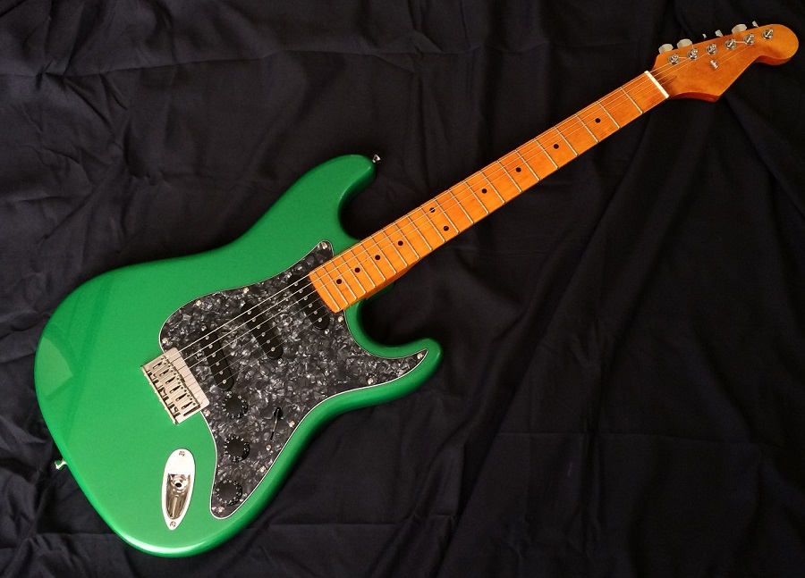

    Also further to what Simon mentioned about using "tinted" clear coat, this method will provide a more even colouring as opposed to staining the neck timber.
    It's not that you can't get an even finish staining, but it can be hit or miss depending on the timber itself.
    And to further quote Mr Barden:
    Bright yellow or orange isn't a good look for a neck!
    I learnt this the hard way... not one of my better finishes, but it plays like a mofo!
Name:	Poison Ivy HT-ST 900x664.jpg
