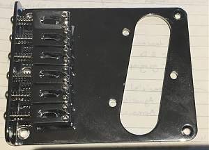

    I have received an ATL FB/15 as a present. I have measured the inside of the nut to the middle of the 12th fret and have measured 324mm. Apparently this is what I should have been expecting. I’ve then measured that distance from the middle of the 12th fret to the middle line of the guitar body and tried to line up the supplied bridge saddles to sit at that distance. From what I can tell, the bridge piece will need to be in a position such that I will need to rout more of the wood of the body.
    My question would be, where do you measure to on the bridge saddles?
    Also, there seems to be contradicting information from Pitbull in how to set up the saddles when measuring. In a video it is suggested they should be as forward as possible but in the PDF manual it suggests they should be in the middle. Any definitives?

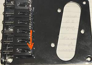

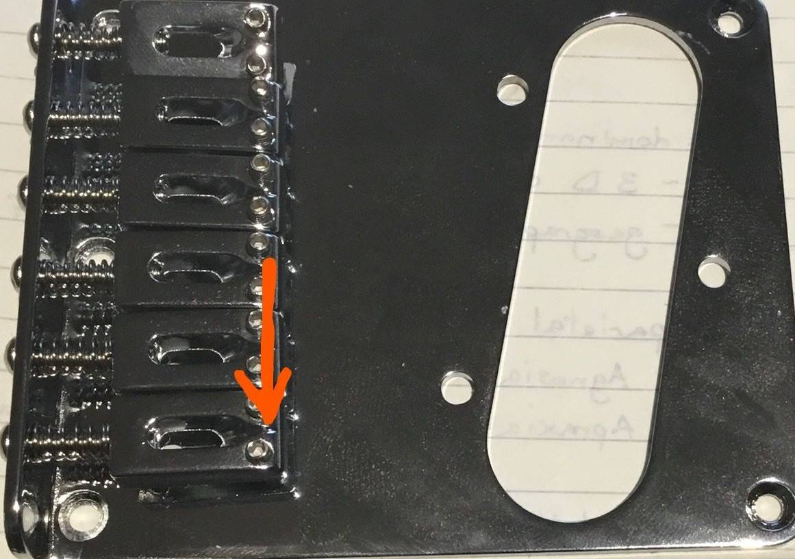

    You need to measure from the face of the nut's top E slot to just behind the front edge of the top E saddle (see arrow).

    Saddles should be almost fully forwards for measuring and positioning (though you only really need to do the top E as it will always be the furthest forward saddle). I'd turn the intonation screw so it's just disappeared into the hole at the rear of the saddle by about 0.5mm. You'll move the saddles back from here a bit once you intonate the guitar. If the bridge+pickup will now fit in the rout happily whilst still meeting the 25.5" scale length, then you can of course wind the saddles back slightly. But that overall distance of 25.5" (or 647.7mm) of nut to saddle is the important one. Much better to measure from the nut to saddle than from the 12th fret to the saddle as you cut down on errors.
    Sometimes with the Tele kits s, you will need to enlarge the bridge pickup rout a bit to get the pickup sitting nicely. Easily done with a drum sander attachment on a Dremel (other small rotary tool makes are available). Just keep the rout inside the outline of the bridge plate and you'll be fine, even if it looks a bit rough when exposed.
