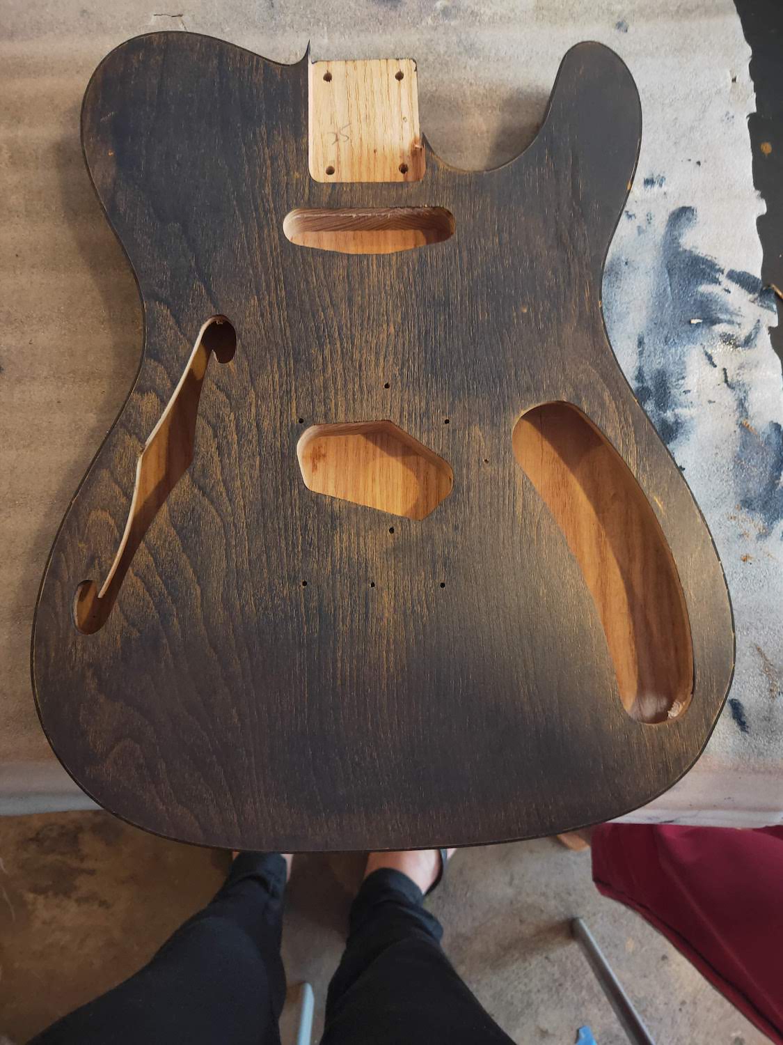

    I've started my first build on a gorgeous spalted maple thinline tele. The kit is absolutely beautiful and I've had such a good time so far! I bought it in anticipation of being told to stay home, and managed to get a few things I'd need before society started shutting down. I'm also a teacher, so my two week break starts next week and I'll be pouring many hours into the guitar. I also haven't done much woodworking ever, so this is a whole new adventure for me.
    A few things:
    1. My plan is to dye the guitar blue, and then use a gold Rub'nbuff wax to fill the wood grains. I'll use teak oil to pull of the excess wax, then tung oil to finish/seal the whole thing. I am quite confident this will look incredible on the sides/back due to the open grained ash, but am less convinced on the front with the veneer. Will the effect still work on the maple veneer?
    2. I've spent about 8 hours sanding so far, and have told myself at the end of each hour that it isn't enough so that I follow the advice that is everywhere on the forum. The back and sides are now much smoother than when I got it, which is quite pleasing. The veneer is super thin so I haven't sanded the front at all, but it is quite rough. Is there any way I can make the front smoother without saying goodbye to the veneer? Or will this happen naturally when I finish the guitar with tung oil?

    You can 'drag sand' the veneer lightly, with something like P400 grit. You can probably just feel some loose fibres, which a very light rub over should remove. But literally really just let the weight of the sandpaper do the work and just pull it across the surface. Water based dyes will raise the grain, so best to do any sanding until after dyeing. Spirit/alcohol based dyes won't do that, but they do get into the near-invisible stress cracks in the binding (from bending) which are impossible to get rid of, so definitely mask the binding. 3M do 3mm and 6mm pin-striping tape which is ideal for this. I know the bindin's black, so it will be far less visible than on white binding, but better safe than sorry.
    Whilst you want to get the rest of the body as flat as you can before applying finish, the veneer is one area which should already be smooth enough. You''ll achieve the really smooth finish with the tung oil.
    What you don't want to do is sand the finish too smooth and 'polish' the wood before staining. Otherwise the stain take-up can be very patchy. So once the surface is flat and you've got any machining marks out, I'd go over it with P180 at most, maybe just leave it at P120.
    If you haven't read about it already, you'll need to check the veneer for glue marks, as any of these will stop the wood taking up stain. Wipe the body over with turps, turps substitute or metho/meths as these will wet the body but not raise the grain. Any glue on the body will stop the wood taking up the fluid, so show up as lighter areas. You'll then need t use a glue remover such as Goof-off. to get rid of the spots.

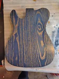

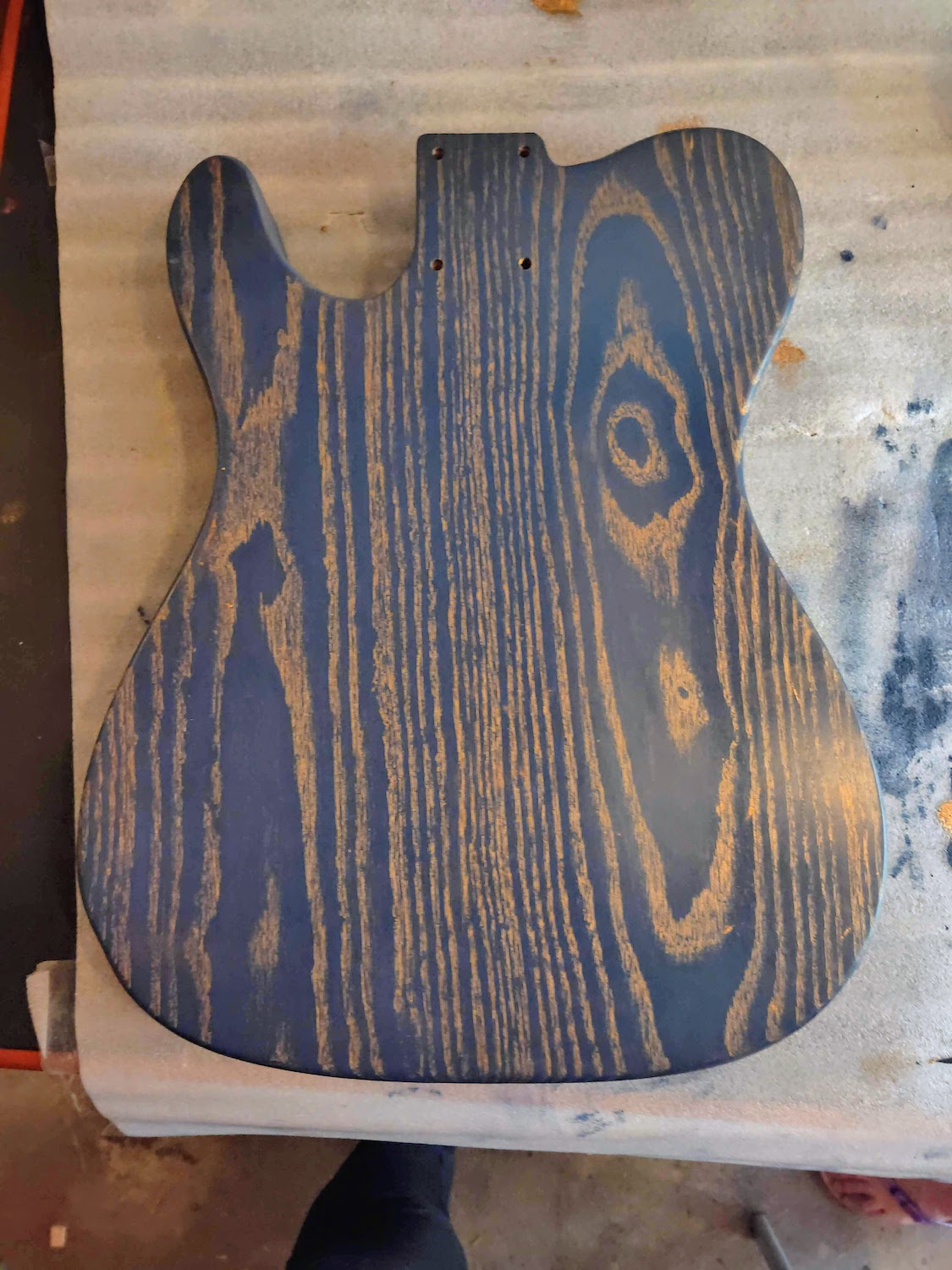

    Thank you Simon for your insights; they've been very helpful! A couple of updates:
    I spent the last few days working on the finish. I did about 3 coats of blue dye, and then used the gold wax/teak oil to highlight the grain. I got a bit too keen before I posted this on sanding it, so the dye was a bit more stubborn than I was expecting. A few extra coats did the trick, and I am so pleased with how it turned out. I love the way the grain is highlighted, and there are so many spots that have a little extra character. I'm hoping to pair it with some gold hardware and maybe even a black pickguard.
ID:	34540Click image for larger version.
    Turns out the bridge has holes for either top loading or string-through, and I think for simplicity sake I'm going to go with the top loading.
    The next job is finishing off the frets. They're levelled, but I did a very poor job at crowning them. Once that is done, I'll begin finishing it with tung oil.
