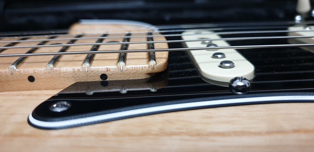

    Your question, "Is it normal for the neck to have some distance from the pickguard?"
    Yes on a 22 fret neck it's normal.
    Its more of just the neck clearing the pickguard and not flush with it

    This is a genuine Fender 22 fret Strat. Hope that helps.

    it does! Thanks for settling my worries
