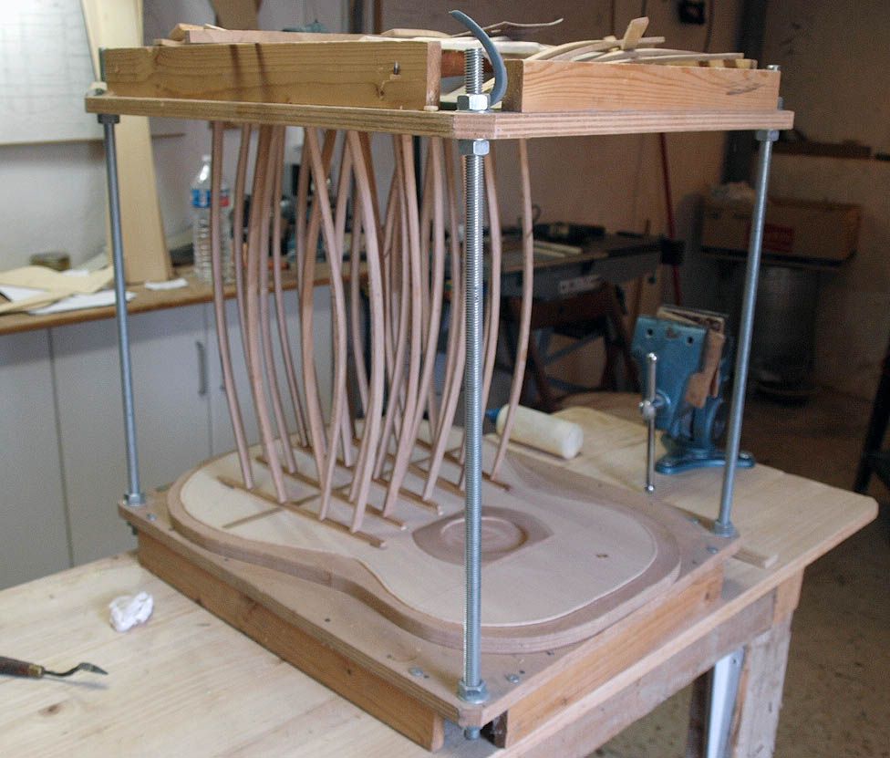

As I said, my first thought is that I need to get some flexible wood or plastic rods to act like 'go bars', which I'll bend into position so they push outwards between the underneath of the top and the bottom brace.
Standard 'go bars':
Attachment 32907
I'll need to find something that's reasonably flexible because there's not a lot of distance between the two surfaces.  I can then put some heavy books on the top of the guitar to counter the upward thrust of the 'bars'.
