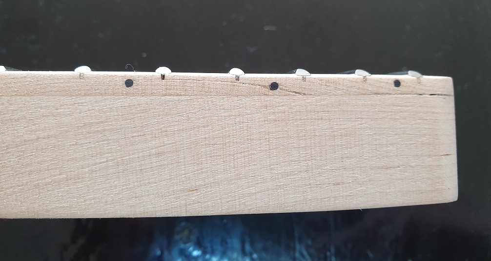

First think I notice is that the maple fretboard thickness has major discrepancies. Closer to the nut it is just about 4mm and at the bottom of the neck it is about 2.5mm. That one is pretty obvious. I am not too sure whether this is expected.
Then the frets... There are a couple of frets for which I could question how they were installed. There is a clear gap underneath those few frets and the maple fretboard, as if there is some missing material on the fret itself. And the gluing of the fretboard at the bottom of the neck looks suspicious.
Attachment 31888
Attachment 31889

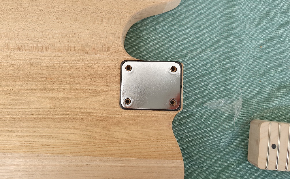

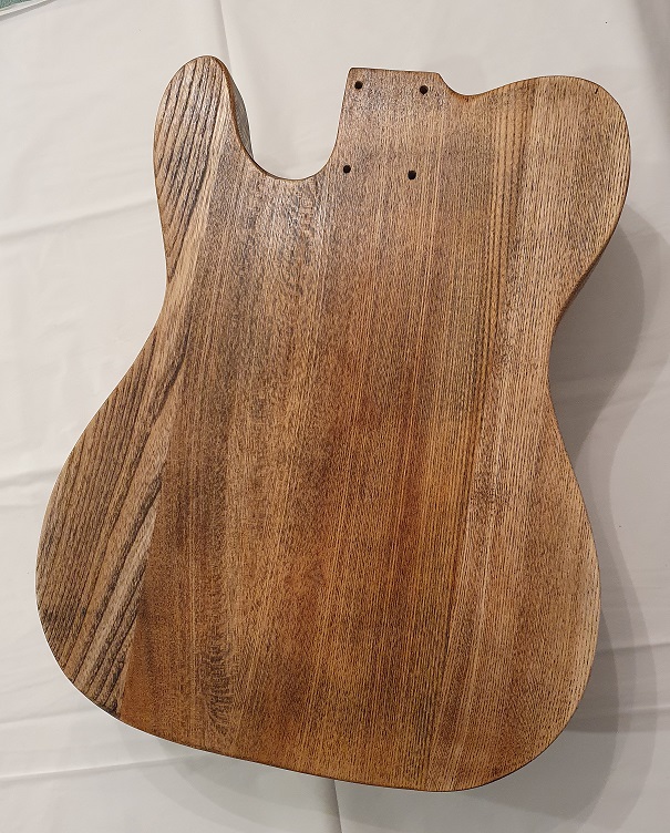

The neck pocket is too narrow by a couple of mm, but as I understand it this happens quite often. And I guess sanding would solve this.
Sanding the top side of the pocket seems to be the only way to proceed though on a TL-1 neck pocket?
Attachment 31890
The holes for the neck plate are quite misaligned. If you want to have the drilled holes match the wholes on the plate than you end up with a tilted plate.
Can this be solved as aesthetically it is not really nice?
