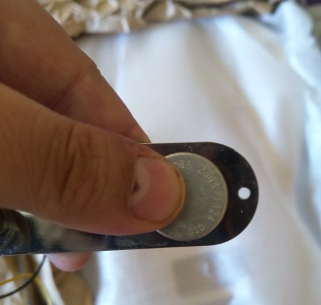

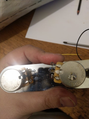

2 - A lot of people use both for P-90 fitted teles. A 500k for volume and a 250k for tone. It's ultimately what sounds good to *you*.
As Mark said, control cavity will require widening if you use 24mm pots. This may open a can of worms but, there's nothing wrong with mini pots if they're good ones. It's more about the quality of the pot, not the size IMO. So if you're not prepared to widen the cavity, maybe look at buying good quality minis.
