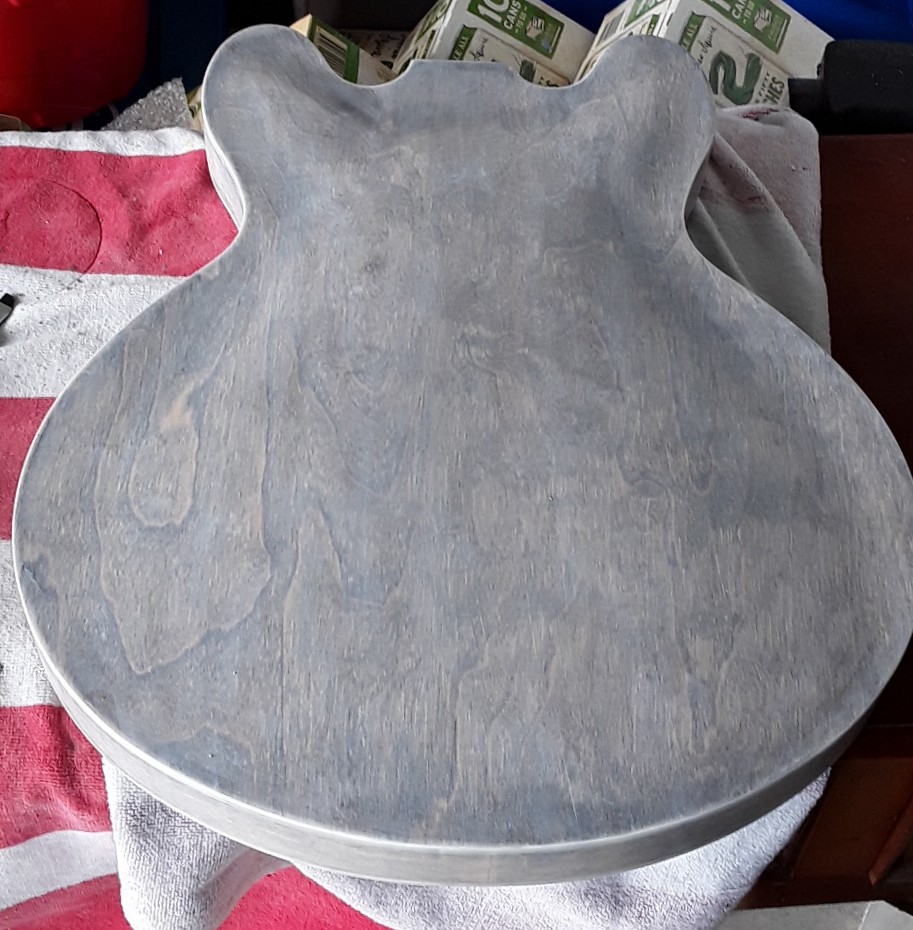

I’ve been over the forum for a few days and can not find anything on a bleached floor board type finish?
Does anyone know how to achieve something like this???
https://uploads.tapatalk-cdn.com/201...35d4a5c484.jpg
Not exactly the same but this was my grain popping phase.
Stained with jarrah and sanded it back. https://uploads.tapatalk-cdn.com/201...51c82a9528.jpg
If you can find something a bit greyer then it may achieve what you want to do.
Yours is also ash which will look a lot nicer than mine which is a basswood body
Hey OliSam
It sounds like you're trying to achieve a whitewash finish, here's a video that might help:
https://www.youtube.com/watch?v=e4uI68pFzUg
Also, to give your grain that grey-ish colour, I suggest filling using something dark like ebony Timber Mate, sanding it back and then whitewashing overtop. Hope this helps!
