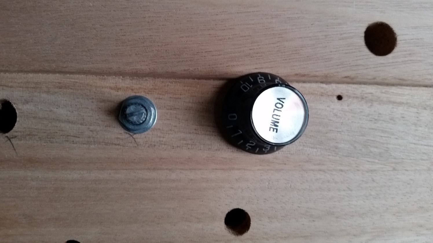

5 Attachment(s)
Still not sure about the stain....the back is the one I think may need some sanding.
Hmmmmmmm.......I just don't know. Love the flame the Tru Oil found near the controls on the front.
Sanded and Tru Oil began again.
Sanded the timber mate off....used the 30 degree day to dry it all out.
One big soak coat of Tru Oil last night.....one more this morning early....looking great.....may sneak another in tonight.
The body appears to be two piece....not centred. The bottom bouts are all one piece and there is a section of lovely tiger flame that goes from just under the raised section on the front of the body....down and around the edge and up to the opposite spot.
Looks so cool. I love how oils pull hidden grain....figure....out of wood.
