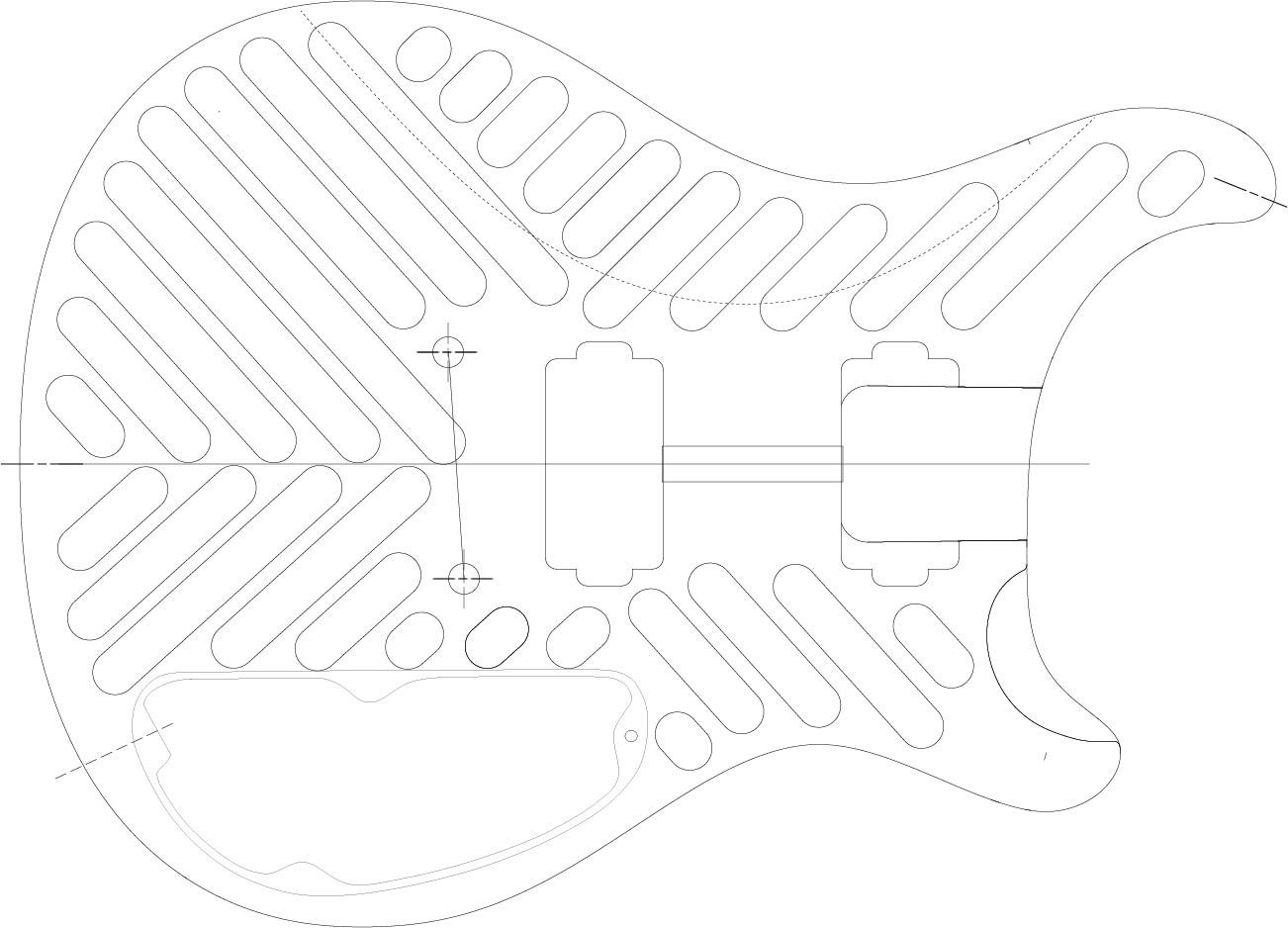

The most work i've done is getting the chambering plan sorted out for this thing
Attachment 31197
As with all the FrankenLab builds the final execution may in no way reflect the plan, but we'll live in hope :)!

It's going to be light as a feather. Do you think neck dive will be an issue?
It might be TK, I was thinking of ways to lighten the headstock as well, potentially some lighter tuners and through holes. Perhaps a slightly off set rear strap button etc. The body blank is some fairly weighty African Mahogany, it will be getting a 12mm Blackwood top (or zebrano) which might offset tings a bit
Plan looks good. Just wondering if there's any benefits in chambering versus going hollow / semi-hollow. I know there's a semi-hollow Les Paul without f-holes. Not sure what sort of chambering or hollow pattern they use.

Well that wasn't hard to find....
https://espanol.gibson.com/News-Life...ht-Relief.aspx
Sent from my LG-H930 using Tapatalk
Thanks for that KuanJB, I'd not seen that, nor heard the G rationale behind their systems.
It raises some questions about what I've designed above, and i think i might go back to the drawing board and rework it somewhat.
I'm thinking:
- Pull back from the Post mounting locations for safety's sake
- Reduce chamber number, but increase size, currently drawn as 5/8" might go up to 3/4" or 7/8" (15.8mm, 19mm and 22.2mm for the non imperial speakers)
- Rework the control cavity to reduce in size/match the lower bout curve.
We shall see, first we draw, then we measure, then we measure again, and again, then we pontificate, then we dither, then we cut. after which we say "Awesome!" Or we say "@(#&%!!".
No worries. I also had not seen it. Might convert it to a PDF for future reference.
It is interesting that they slightly modified the routing in the latest iteration. Really curious now what effects they found by the slight modifications.
