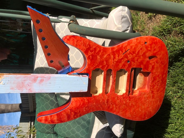

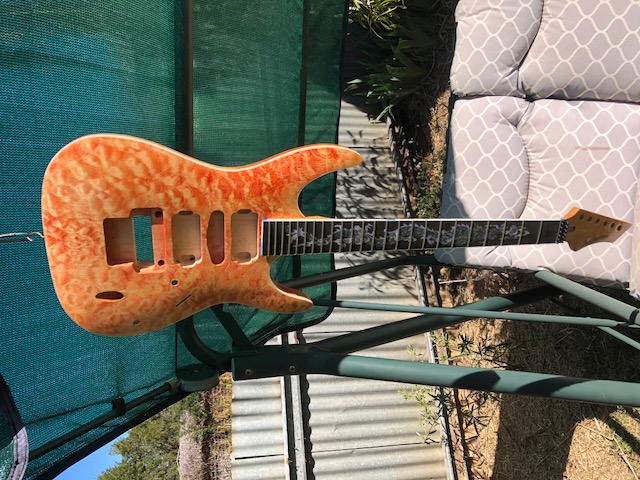

First couple of D/tone
It's a bit brighter than I was expecting
Any suggestions on how to make it a bit darker, (not keen on rubbing it all off again)

By darker I presume you mean of the same colour tone?
If so, just keep adding more base stain however if you mean a different colour shade darker, welcome to the unpredictable game we are addicted to called kit building. Rarely does a colour scheme in theory end up the same in reality as the timber used will dictate a lot towards final outcome. Your headstock looks more orange than red which could be lighting in that shot, but if it is a different shade or colour it will need more coats than the body to even things up a bit.
Unfortunately trial and error may be required.
Cheers, Waz

Thanks for the advice.
I was hoping for a darker shade & that some one out there had added a tint to D/tone before.
But the more I look at it the more I like it. So I'll give it a couple more coats & see what happens.
Yes the head stock photo was a lighting thing
Cheers
Ron
The overall depth will improve a lot with clear coats as well. But as Waz said, I'd probably give it another stain pass if you want it darker.

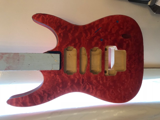

Gave it a couple more coats today & the depth improved heaps. (even though it doesn't show in the photo)
The intensifying coat next
Attachment 27621
that top is starting to look TASTY! Really nice work Doubleedge!
4 or 5 coats of base stain brings out the best in DT in terms of depth of colour but if happy with 2 or 3 coats no point going any further.
A few coats of Intensifier brings on an amazing appearance, hard to describe but you will know what I mean when you see a couple of coats done.

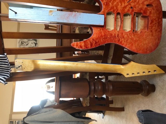

2nd intensifying coat today. Starting to look pretty good I think. ( Lots of character lol )
Only decision now is whether to give another intesifying coat or go to the finishing coats.
Attachment 27725
Generally the colour does deepen over a few months as the finish totally cures. Not a lot, but a little. If truly in doubt, leave it a week and you may find patches you have missed that convince you to do a further coat.

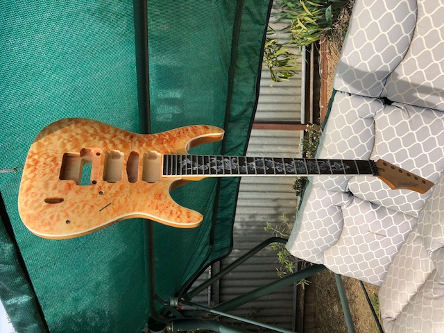

The 3rd intensifying coat finally dried so applied the 1st of the final coats today
Attachment 27878Attachment 27877Attachment 27879
Looks great... The photos give it almost a beaten Copper sheet look...
Nearly had enough of thie D/tone! Bloody stuff never seems to dry!

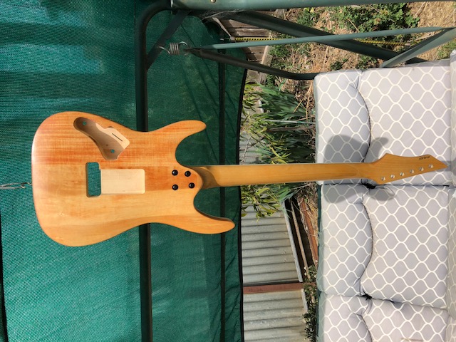

Applied the final top coat about 2 weeks ago. The colour had faded quite a bit from when the 1st coat was applied (see photos below)
Attachment 28188Attachment 28191

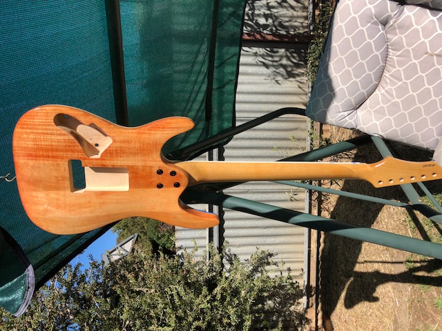

Left it to dry for the last 2 weeks & it's faded a heap more (see photos below).
I've been putting it out in the sun each day. Could that be why it's fading so much?
Attachment 28189 Attachment 28190
Certainly possible that the UV light is breaking down the pigments.
