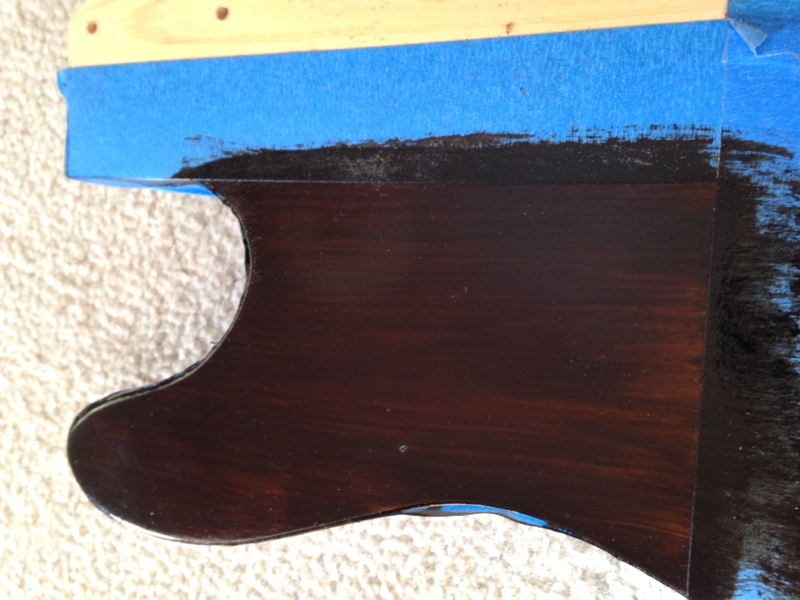

1 - 240 grit sand, shellac (thin coat), light sand, then applied a coat Brown jarrah (brush..not a good brush) - don't mind a bit of the hue of shellac coming through however will need a further light sand and diluted coat of stain before approaching any final finish layers.

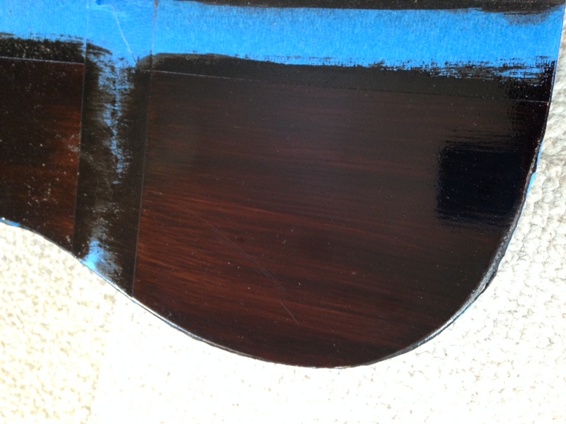

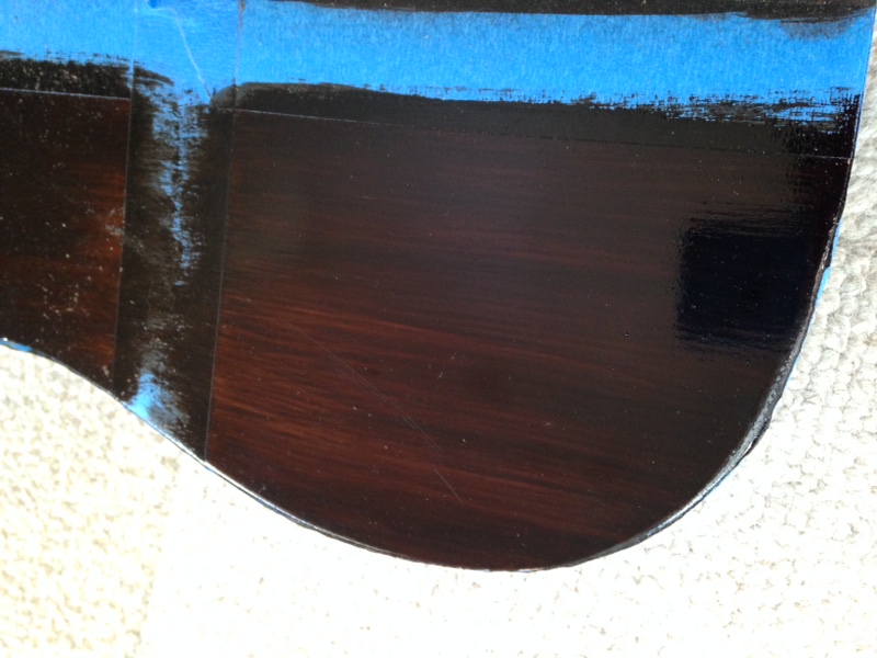

2 - 240 grit sand, proof sealer (now did a sand on this - some say don't but I opted to) coat of shellac, light sand, coat of brown japan (brushed on)

For each of these there will be quite of bit of sanding required to achieve a very smooth finish and invest in a good quality brush or using of a lint free cloth for application.

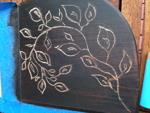

3 - 240 grit sand, tint directly applied (far out this wood is like a sponge), light buff then...yep tried a rough free hand dremel. The wood doesn't have too clunky a texture to dremel on however steadiness of hand is needed as the wood can burr a bit. Haven't done a light sand over yet.

OK...I may have gone a bit out there and this is only first paint (swatch) ...but the dremel pic stained in earlier thread I have sanded back, then engraved again with slightly larger burr, diluted brown jarrah (light wipe on) when dry sanded again with a 400 over dremel, 240 and then 320 then 400 remaining body. Reason I didn't go higher is more I'm still testing effects. I then applied an oil sky blue with a tiny brush..to see effect and do love the contrast of blues and browns..thoughts? am I crazy.. :) Attachment 25509
