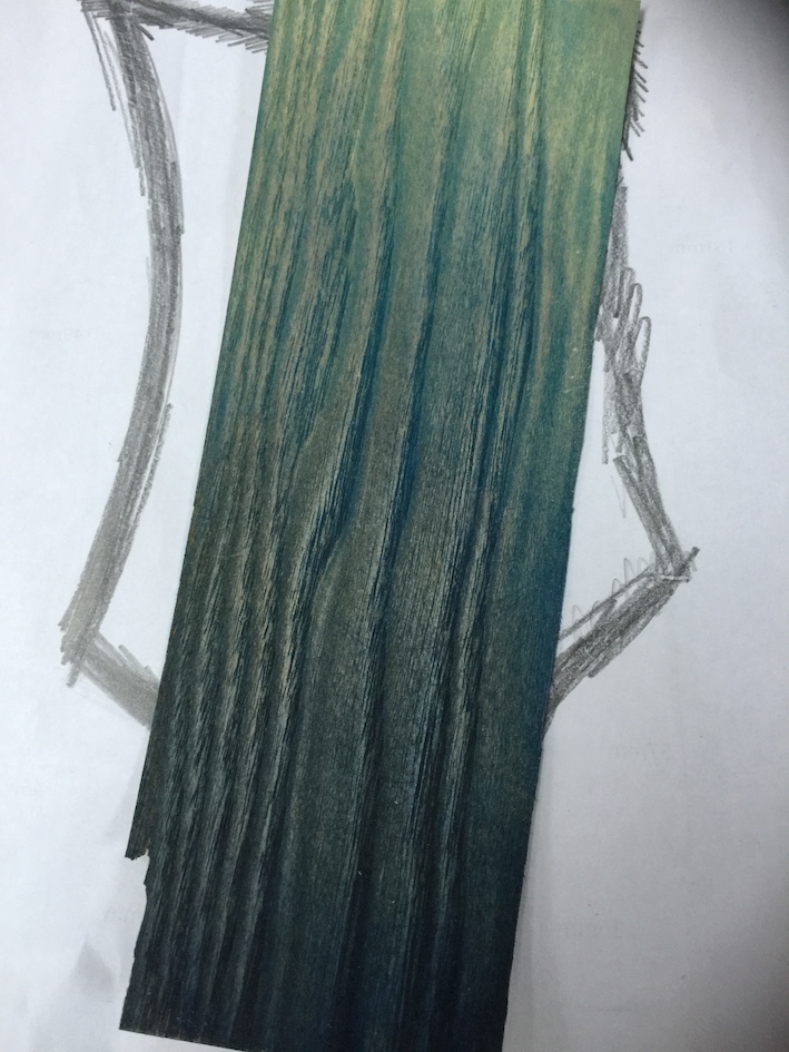

Some progress but without the kit yet. Headstock extension but may still go with stock kit and sell RIC tuners and a little practice with oil paint on some ash veneer.
Attachment 25428
Attachment 25429
Is the veneer buckling under the moister? Or is it looking that three dimensional?
Also, great work on the headstock expansion. Not sure why the kit comes with such a minimized headstock.
It’s just a test on a bit of ash veneer
Just read your question again, the veneer is a bit wavy but it does look like that if a little greenish
