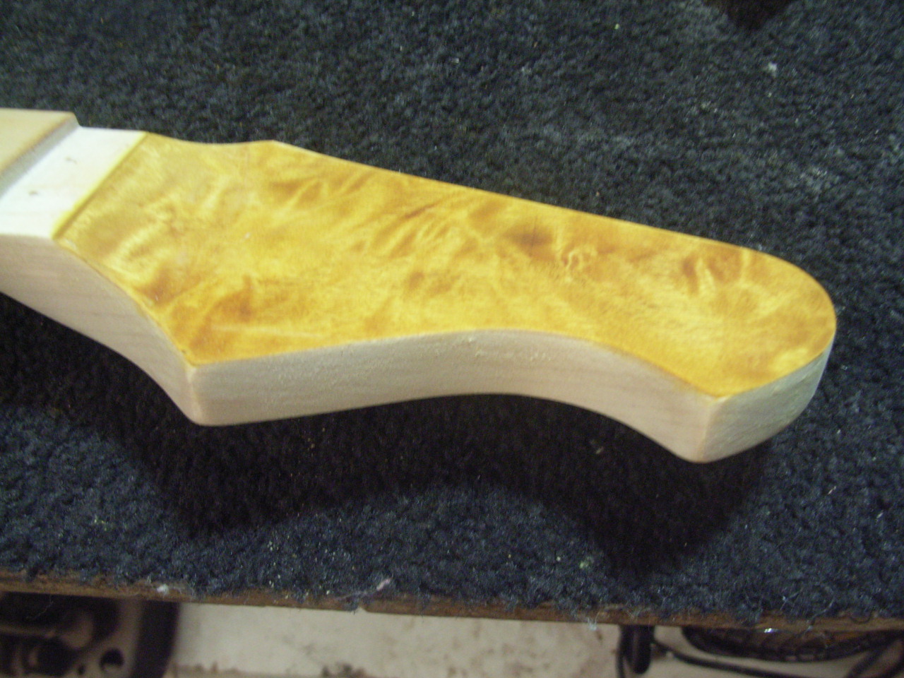

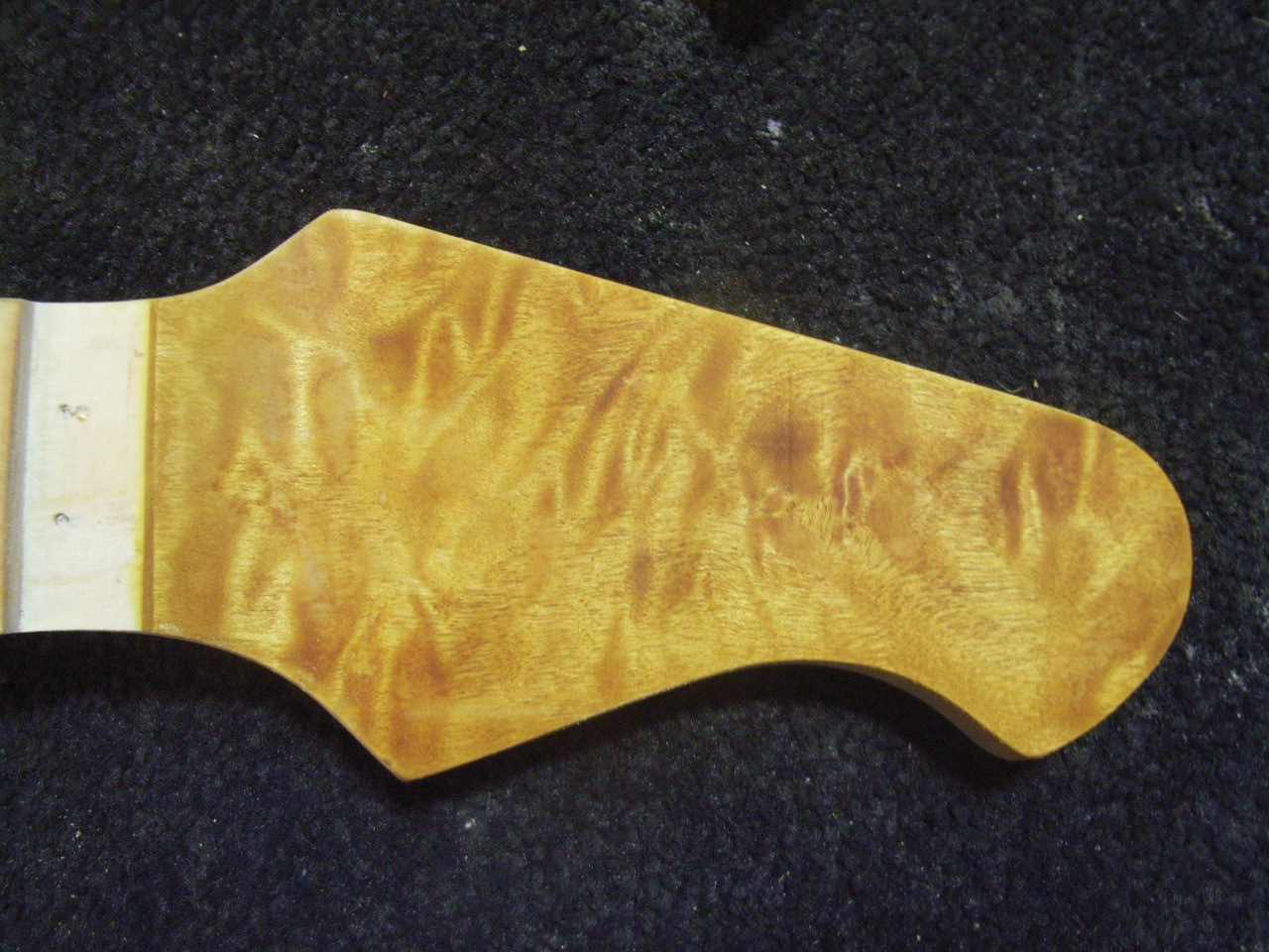

So I ordered a piece of quilted maple veneer and glued it to the headstock face. Trimmed it up and gave it a coat of the DT "Coolongatta Gold" no dark grain filling or such like. I think it has brought up the quilt just fine, especially for a first coat. I'm thinking the intensifying and final coats will make it even better.Attachment 24202Attachment 24203

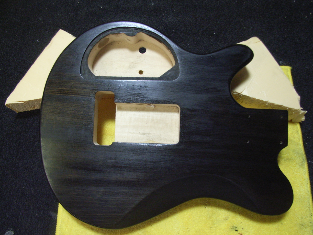

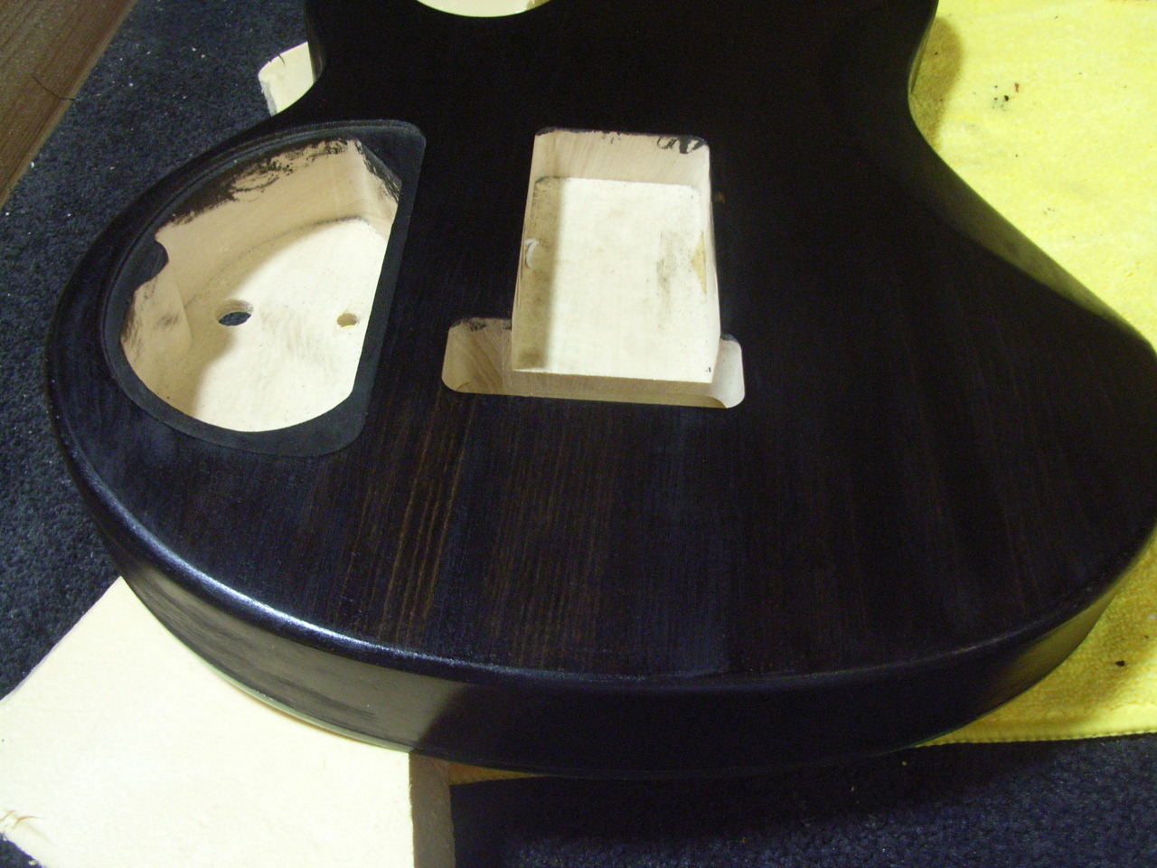

Got some "Japan Black" onto the back of the body. About 4 coats of TO. First 3 went in like a spongeAttachment 24211Attachment 24212
Lots more to go I figure
Oh nice. Black stain is just so....black isn't it?
It has a faint brown hinting through which I like
Stain looks good JB
