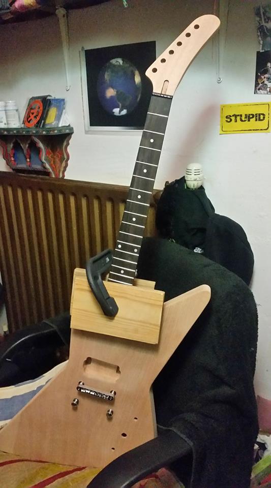

So, got a 7 string explorer kit on the way.
Rough specs;
Ash body
24.75" scale
Maple neck
-below are things I asked for as custom shop additions-
Maple fretboard
Reverse headstock
Black hardware
Plans for it?
At this stage, pickup choice is changing on a weekly basis, as one day somebody will link me another cool set and I'll think that sounds rad after listening to a bunch of demos.
But otherwise;
-Paint the body Mitsubishi Stratos Grey
-Sand and oil neck (or satin clear, I dunno yet)
-Either black headstock face with grey wording OR plain maple face with grey wording (still deciding on what to put. Thinking exploder in the fender font)
-Seymour duncan black winter pickups (at this stage)
-Seymour Duncan liberator volume knob for easy swapping out
-Some form of push push tone knob for easy coil splitting. Or push pull, see how we go
-Depending on quality, replace the tuners. Would love some open gear ones, but probably not happening
-Probably replace the input jack as well.
-Probably also replace the pickup switch, depending on how it goes, and if it's black in the kit
-Black tusq nut
-Probably try and find some boutique/ low profile top quality pickup surrounds (I'm majorly picky when it comes to surrounds, and not usually a fan, but found a decent ltd with some nice looking ones in a local store)
Otherwise just body mount the pickups
-Will likely be giving the neck to a local luthier to give the frets a good loving, just to make sure it's all g (will see how it feels first/ give it a quick rock, so I can tell if it needs it)
Basically the aim for it is to be a rad metal guitar with a bit of versatility, with brutal gain sounds, and dark/ warm cleans (though dirty cleans, because I love me a bit of a bitey clean).
Will update with a pic of it just kinda slapped together when it gets here, then will slowly start working on it. I'm horribly impatient when it comes to painting and working on stuff, so this will be a challenge for me, but fingers crossed it works out
