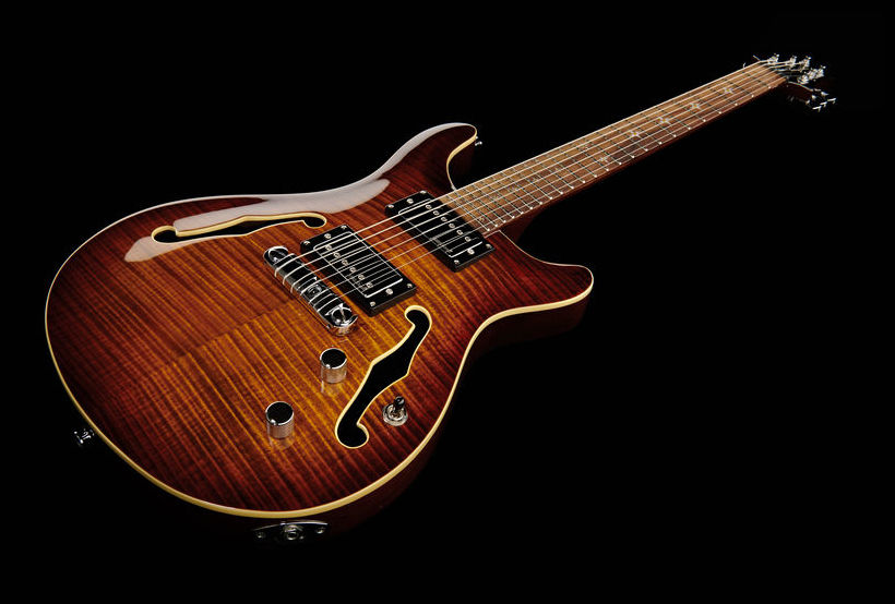

Attachment 22749
Is this what you have in mind? The Harley Benton has smaller crosses for fret markers but tend to reckon they will look ok with the right colour combo.
Thats right Waz. Thats the one. but I am wrestling with the stain colours...still havent decided

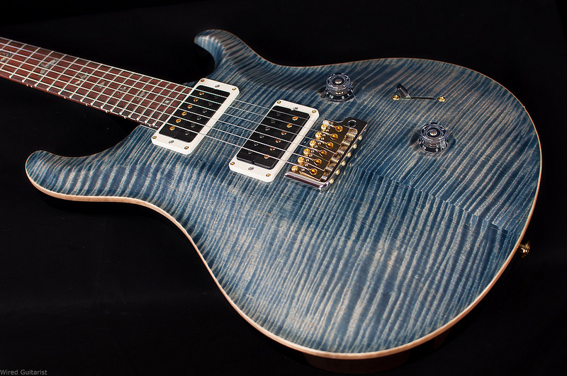

Anyone know how i would achieve a PRS Whale blue style with it?
Attachment 23777

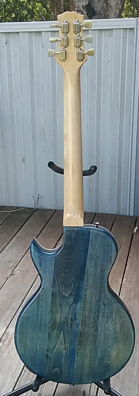

The back of my es2v was pretty close to that if you wereto sand the stain back a bit it would be pretty closeAttachment 23779

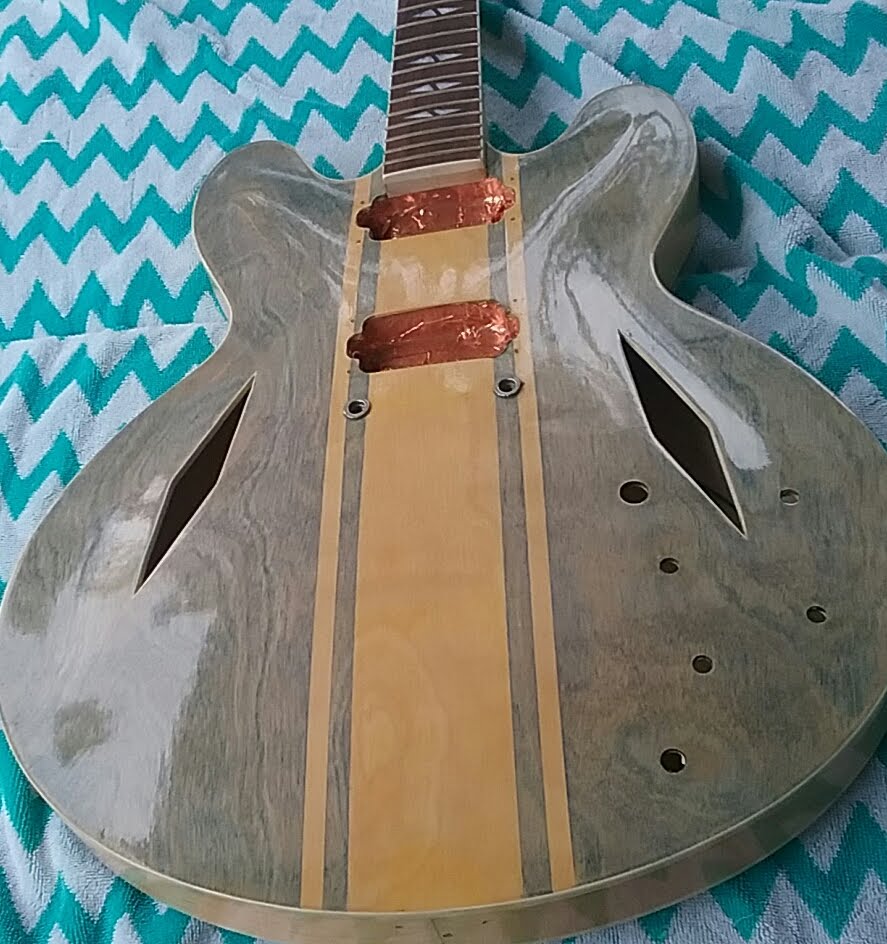

Hey andy was going through some old photo's bondi blue no ebony timbermate, and wAttachment 23853ith ebony timbermate Attachment 23850
Big differense in colour only the timbermate underneath, both are basewood bodies

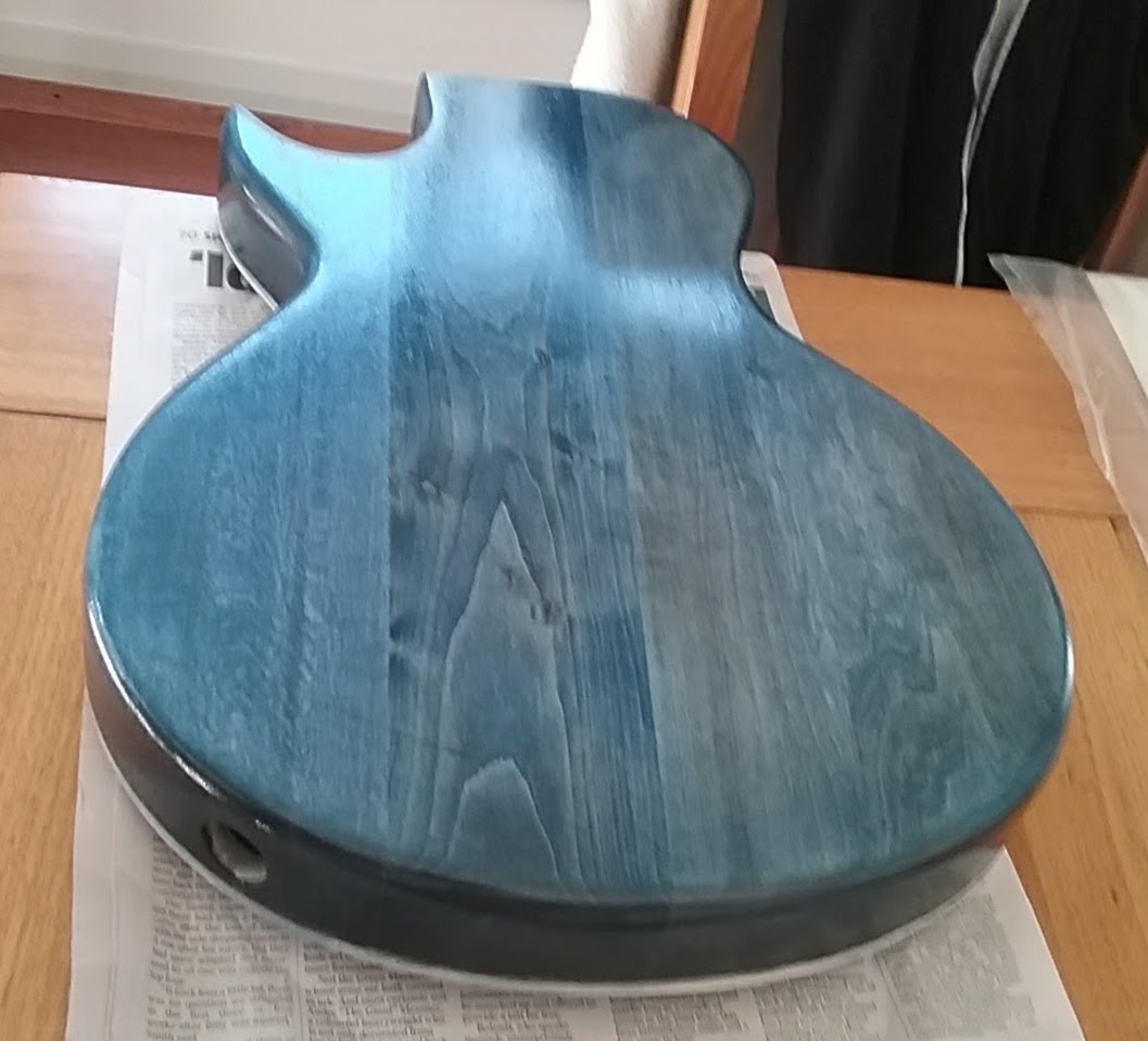

Reminds me to do an update. This is after two stainless coats of Bondi blue and colourless on that sides and backhttps://uploads.tapatalk-cdn.com/201...20a4d96274.jpg
Sent from my Pixel using Tapatalk
That looks very nice
