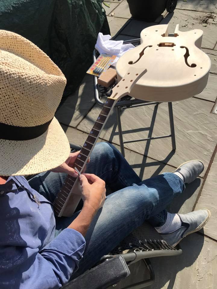

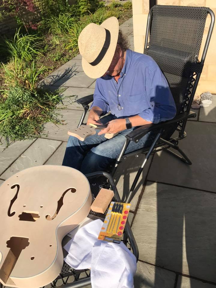

Spent a nice sunny day sanding and taking burrs off of frets.

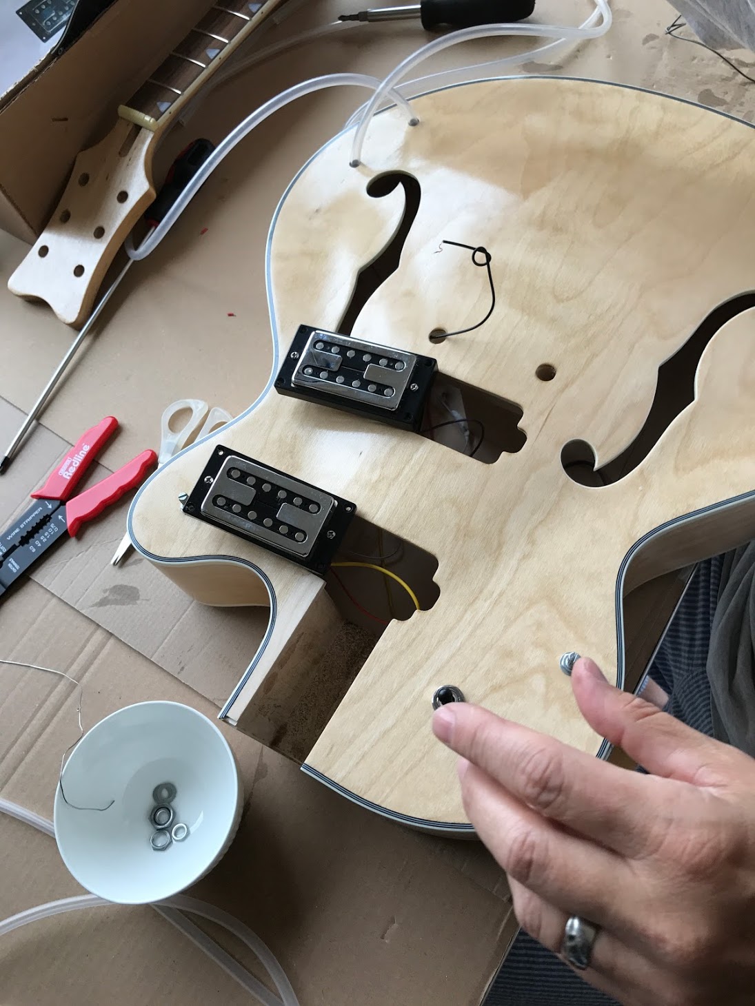

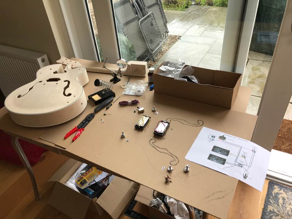

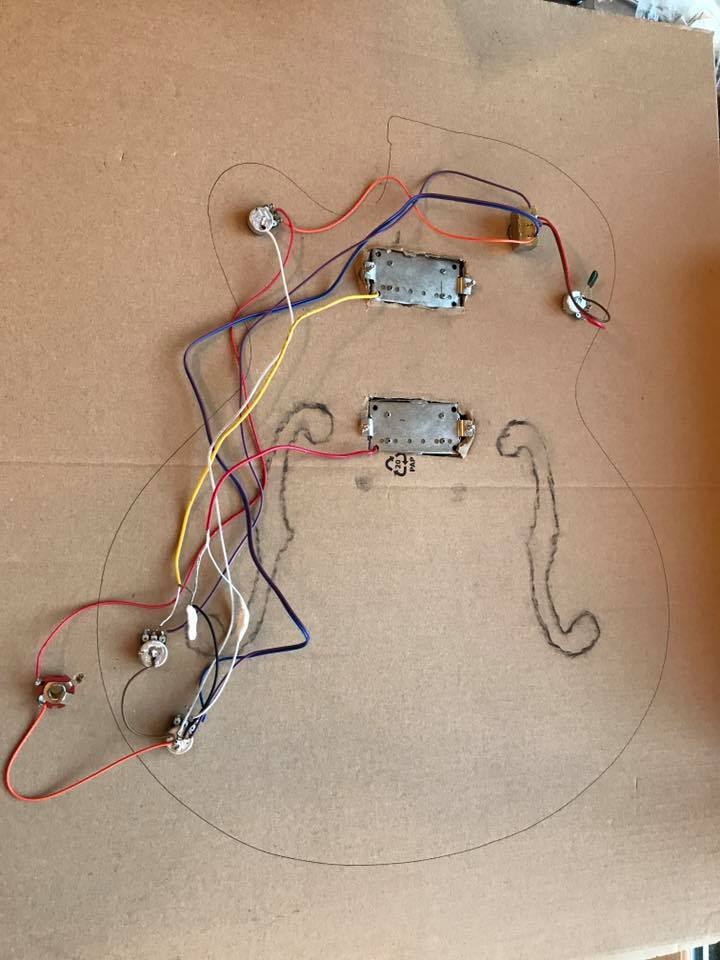

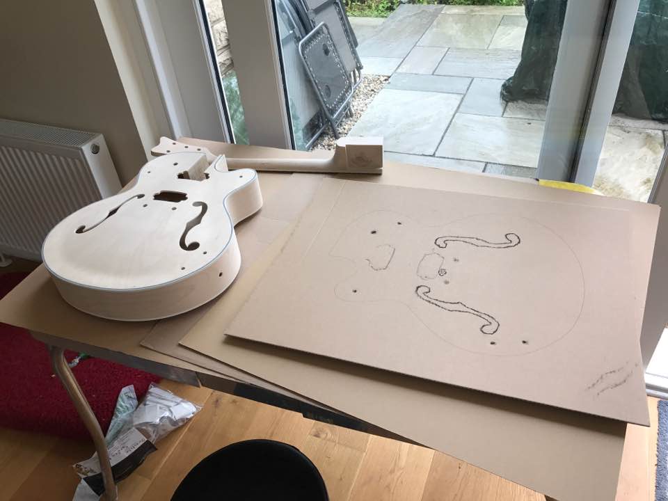

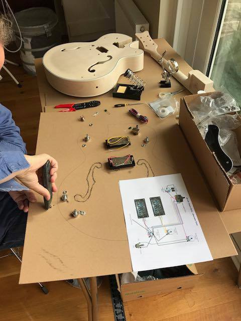

Getting the electronics ready. I used some vellum and a HB graphite pencil to make a rubbing, then created a cardboard template to assemble the loom. I used the alternate tone wiring scheme found here. Although I was too lazy to do the ground jump on the third pin of the pots (we'll see if I live to regret that.) I've plugged it in to my amp, tapped the pickups with a file, and everything works! No hums or buzzes either. It's been a long time since if done any soldering, but it all came back to me. I used to solder my own MIDI cables because I liked to have custom lengths, so this was familiar to me. Next step is the finishing. I'm going for natural with Tru Oil. Depending on the drying time, I might be finished by the end of the week!

Nice thinking with doing the rubbing! I lived in the UK for a couple of years when I was 7 and thought going to churches and doing brass rubbings was the coolest thing.
After doing the rubbing with an HB graphite pencil, I went over the lines with charcoal - that way it was easy to transfer them to the cardboard simply by flipping it over and rubbing over the back of the vellum.
This site is a wonderful source of information - I learned why I should ground the third pin in this thread: http://www.buildyourownguitar.com.au...704#post146704

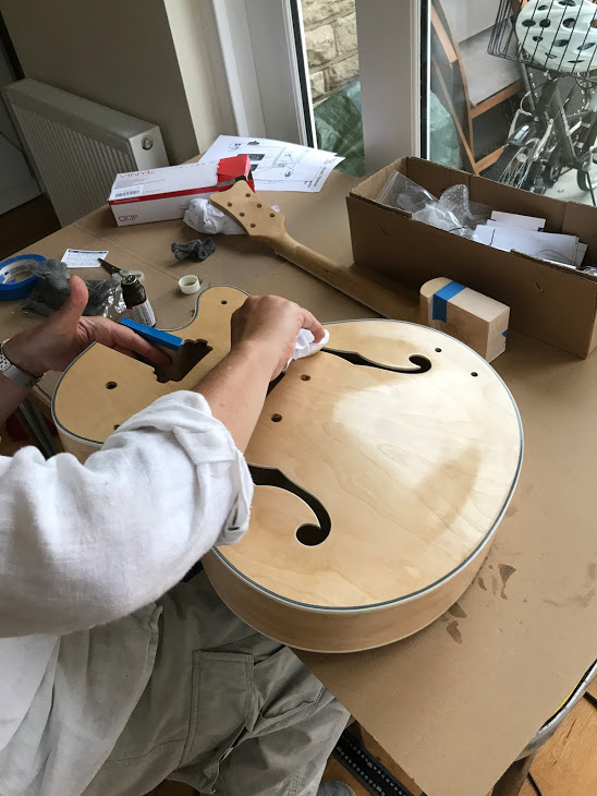

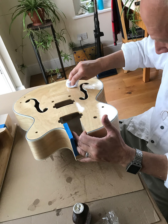

In the final stages of finishing. I'm amazed and pleased at the results I'm getting from Tru Oil. The neck is finished in just three coats. I've done four on the body and will decide tomorrow after 24 hours of drying if I need any more.
Putting the 4th coat on the body:

Looking good.
You might want to put a few more coats on, though it partly depends on how shiny you want it to be. Each coat is very thin, so with 4 coats there isn't a very thick protective layer on the guitar. People here (I have no experience with TO yet but plan to later in the year) generally think that 20 coats is about right to be able to sand it down flat and then polish it for a really glassy finish. If you like a more satin finish without sanding, then maybe 10 would do. But it takes very little sanding with 1500 grit paper to get through 5 coats of finish.
So whilst it may look good now,the thinner the coating, the quicker it will rub away and parts will be back to bare wood. You can always re-apply the TO, especially if you leave it as a satin finish, but it's likely to start looking patchy if you do so as some dirt is bound to get rubbed into the wood once it becomes exposed unless you reapply some TO very quickly. Probably not a problem on the back of the neck, but less so on the body.
There's always a compromise on finish thickness between very little and letting the wood vibrate more, and a lot thicker protective finish that dampens some of those vibrations. It's your guitar, so the choice is up to you; but unless you just plan to play it a bit then hang it on the wall, I would keep going for a bit longer.

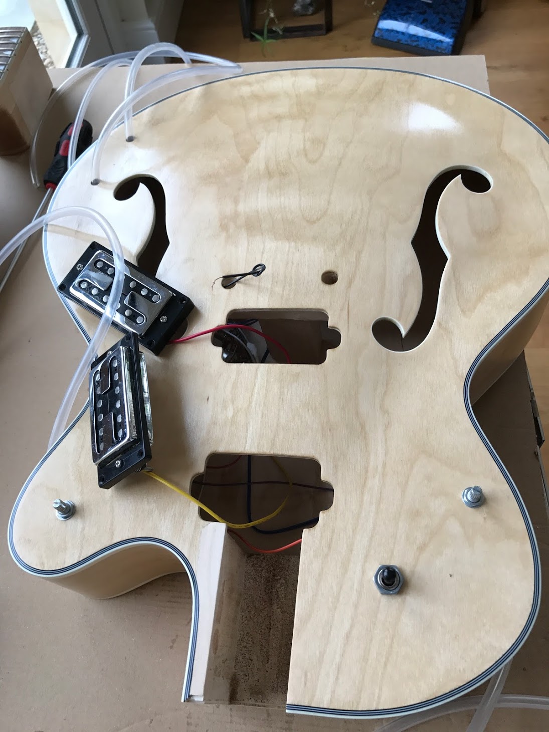

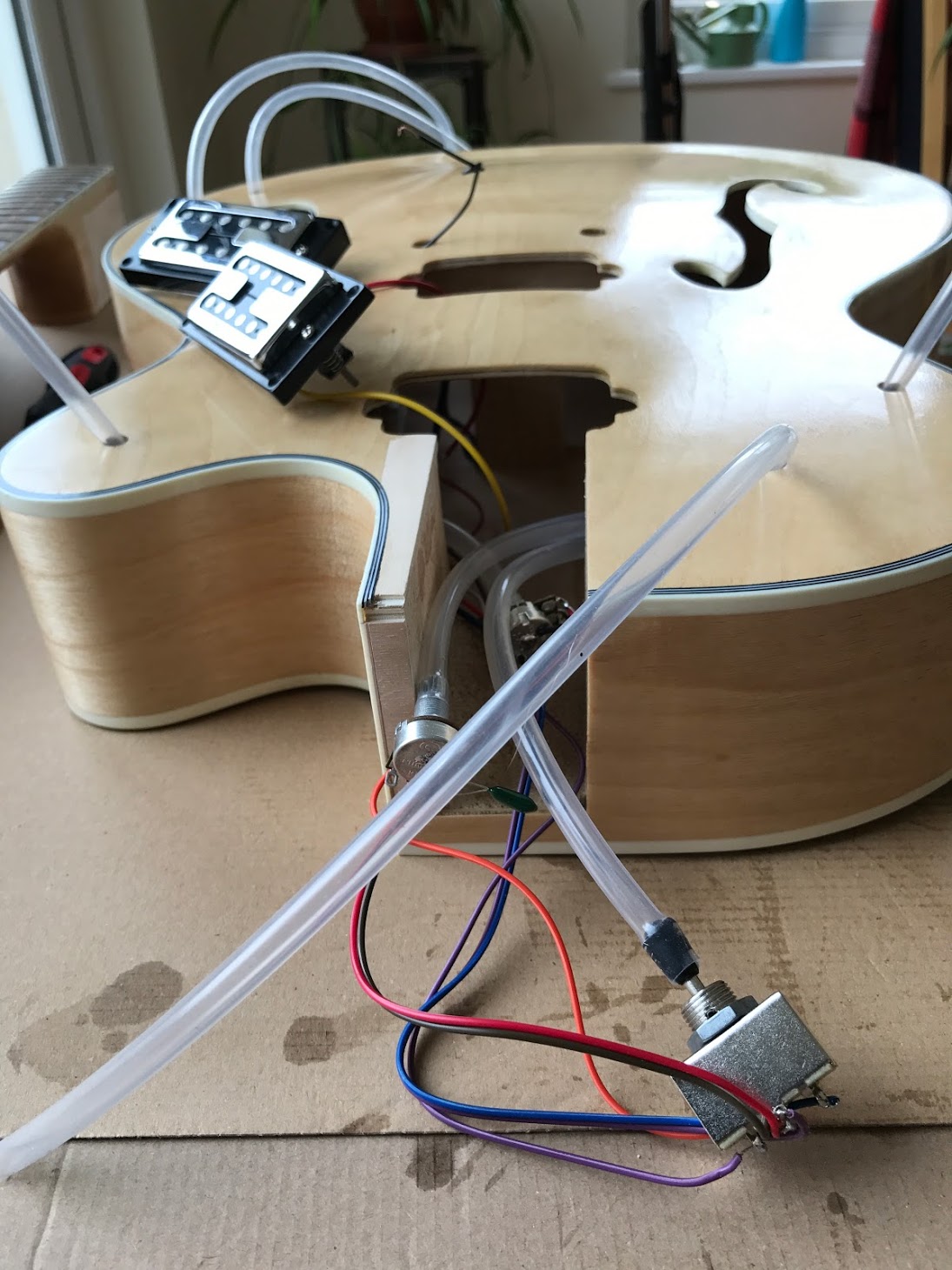

Preparing the tube approach to installing the loom. A bit like building a ship in a bottle:
Attachment 21329
Half of the loom in place:
Attachment 21330
Attachment 21331
Nothing like pulling a loom through a small hole to show you your weak solder joints. Had to take time to re-solder four wires.

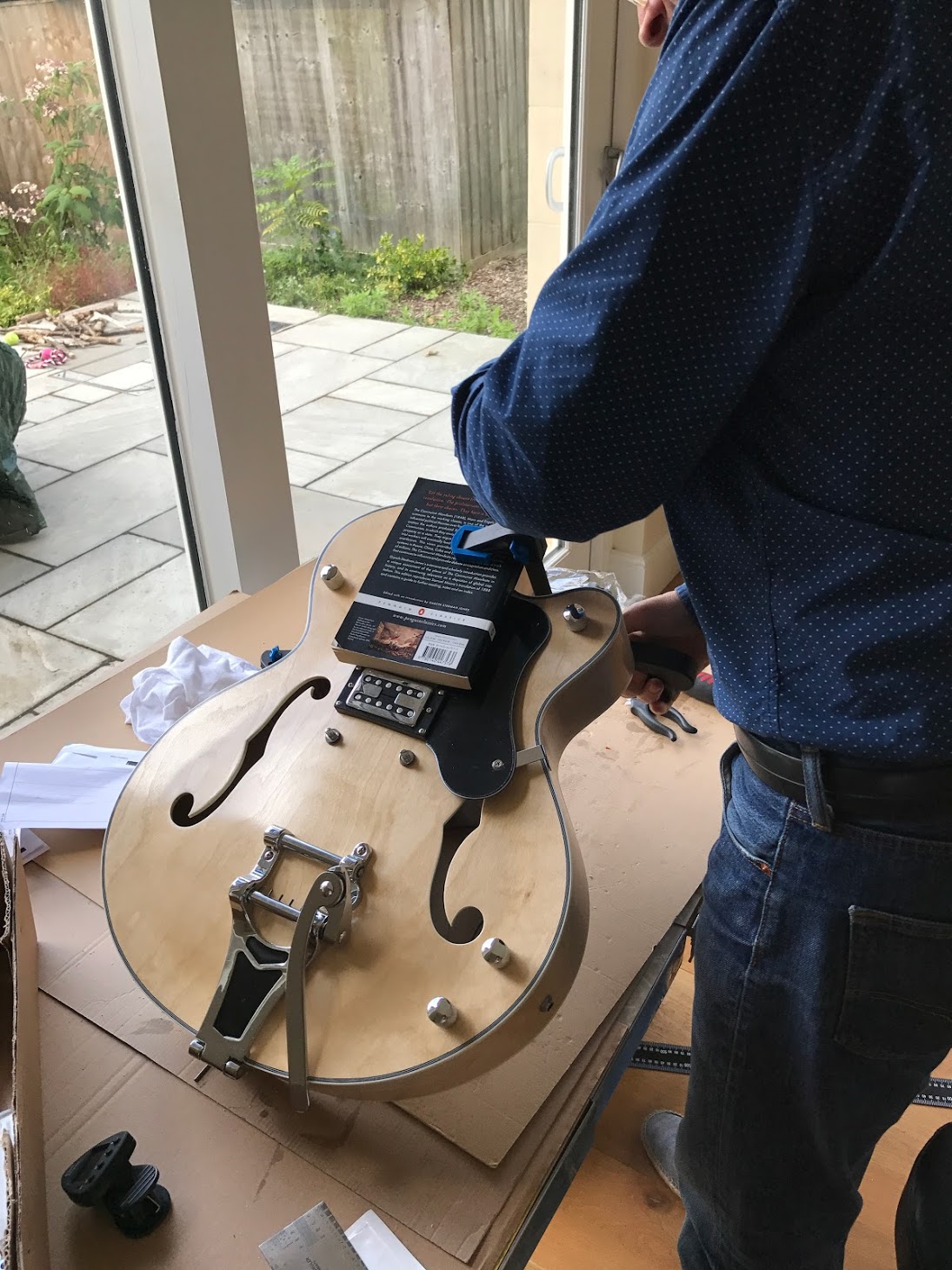

Gluing the neck (I used the controversial "put glue on both pieces" approach:
Attachment 21337
Glued, clamped, and if the fates are willing, I'll have a playable guitar in 24 hours:
Attachment 21338

I'm very happy with the way the 4 coats have gone on. The thing about Tru Oil is that it is what is says on the tin, an "oil." In this case, linseed oil. As with wood furniture finished with an oil, you expect to touch it up every so often. Linseed oil dries pretty hard, and is very durable - think of linoleum floors - they're made of linseed and cotton.
The four coats have given it a nice satin shine, and you can still see the texture of the grain. And it's easy enough to touch up.

Removing the clamps:
Attachment 21369
It didn't fall apart!
Attachment 21370

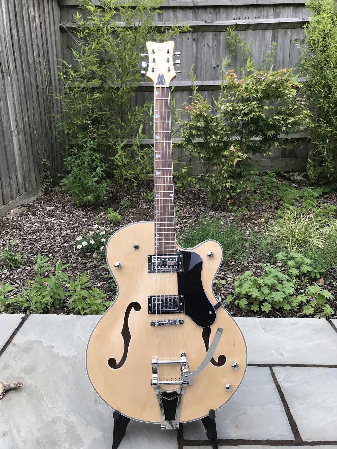

The finished guitar:
Attachment 21373
Well done man! I think you broke the record in building a guitar!
Great looking result. Looks so right.
