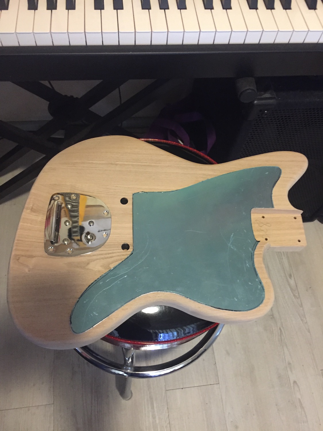

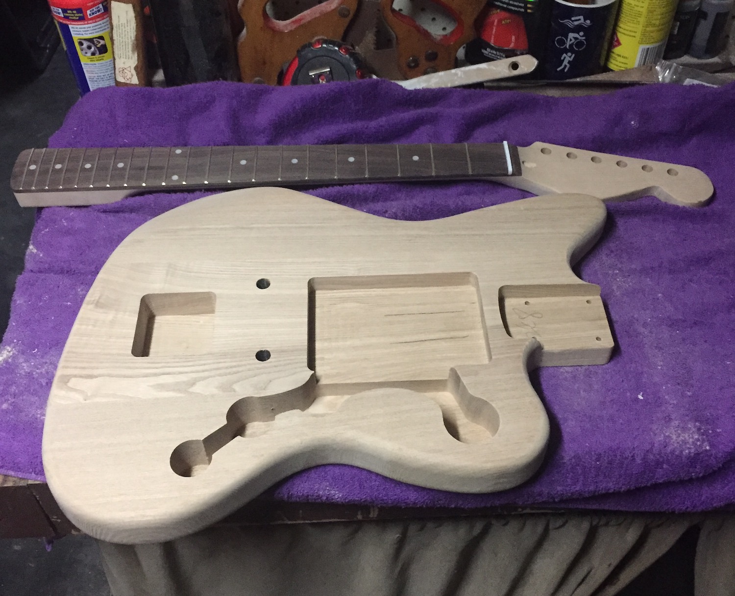

Kit ordered and due on Monday - really excited to get cracking on this one. Probably the biggest change for me with this kit is that I won’t be modifying the body. It feels a bit weird to leave it intact given I’ve never done a kit without a few tweaks, but there’s simply nothing I want to do! Then again, my mantra for kit building is to always create something I couldn’t buy off the shelf so there will be some fun stuff.

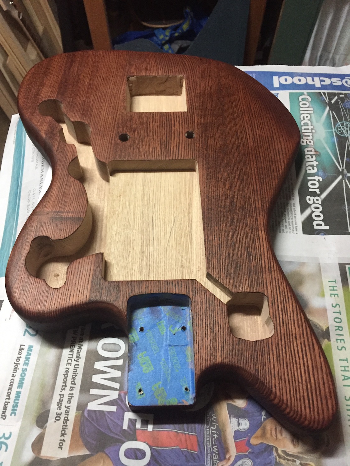

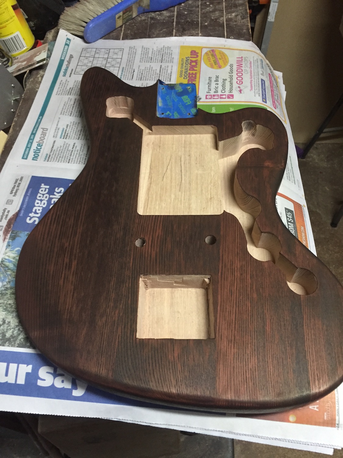

The plan is to do a walnut stain as a nod to the Elvis Costello Jazzmaster, but the interesting stuff will be more around what I do with the pickups and switching. I hope to replace the toggle switch with a 5-way switch and use the Bill Lawrence 5-way Telecaster Circuit that delivers the following:

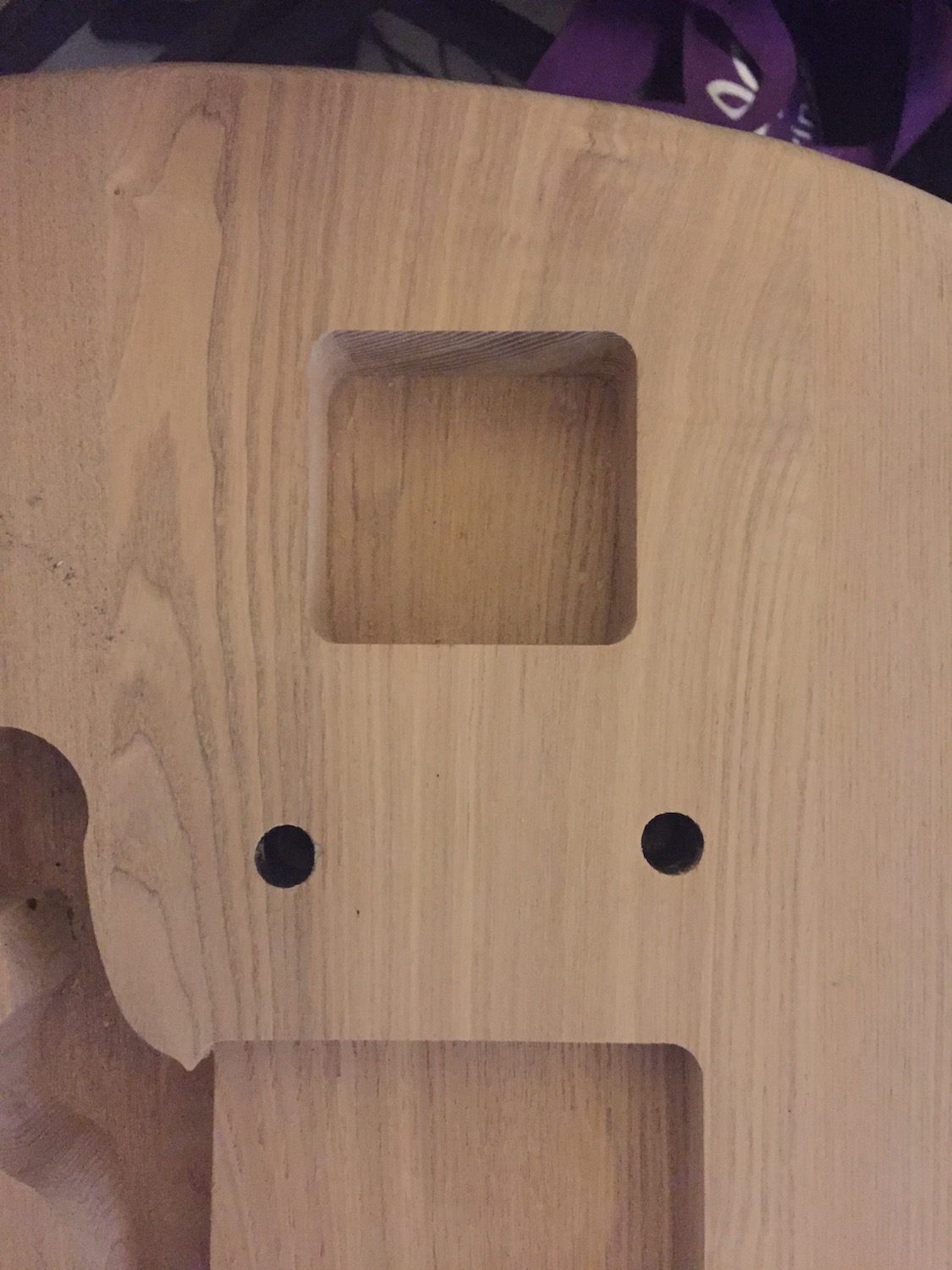

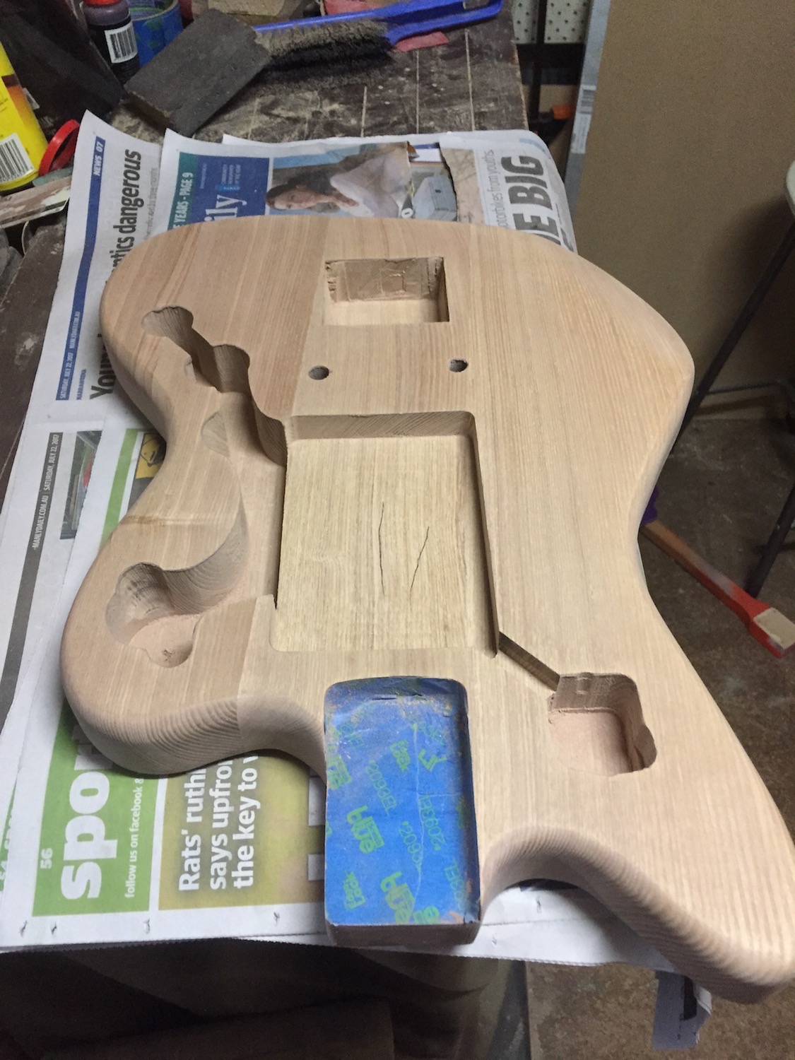

I also want to have a toggle switch on the upper horn with the idea being to have a “blower switch" that links the neck pickup to the output directly, but perhaps have a low pass filter on it (especially as the position 5 of the Lawrence set-up is effectively a high pass filter). This will naturally require an extra bit of routing. I’m not sold on the specifics of this one yet, so if anyone has some interesting ideas on what I could do with an extra toggle there I’d welcome your thoughts.
There are a couple of ways I can approach mounting this stuff. One is to simple make a new pickguard with all the relevant holes. The other is to make it a bit more Jaguar-like with control plates. The issue here is that the plates are effectively custom – the 5-way switch would be like the one on the Johnny Marr Jag, and the top horn toggle plate would truly be custom. I have found a place in the US called Faction Guitars who make custom plates, but they are US$50 each. Or I make my own…
