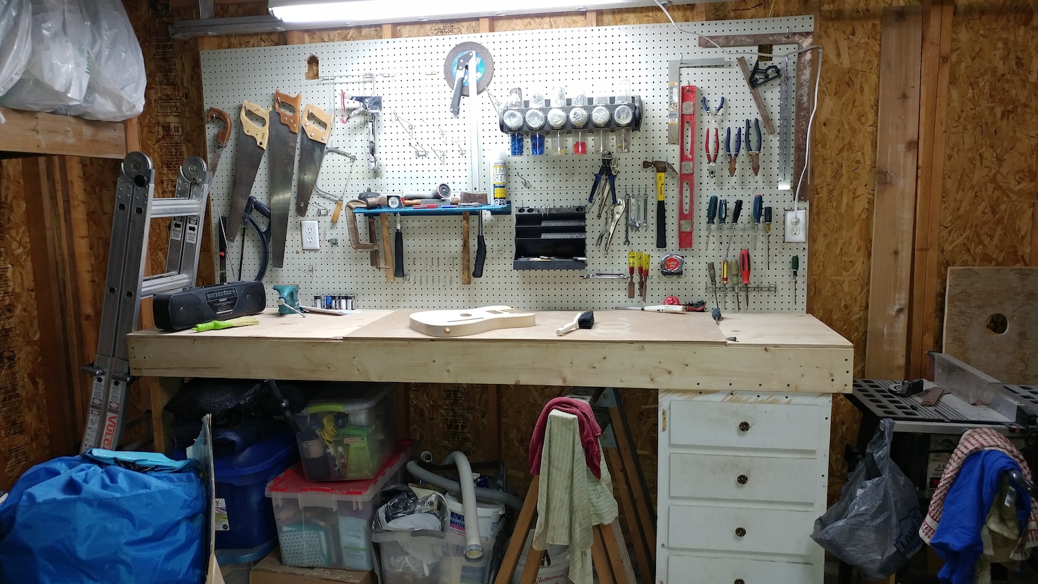

Had the kit for about 2 weeks now, as I'm building a work bench in the garage for the job. Today, I start sanding!

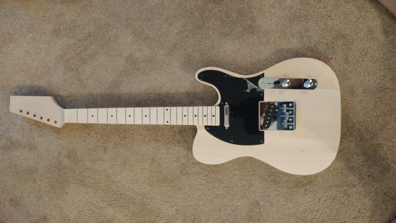

okay...pics of the bench....Attachment 20675 and Tele Attachment 20676
Keep in mind, I'm no carpenter. This is a pretty simple bench. I do plan on installing a vice somehow to hold the neck and body while I work. The drawers were re-purposed from an old kitchen cabinet, and I already had the peg board. I've installed 2 new outlets on either side of the bench, and the work light above.

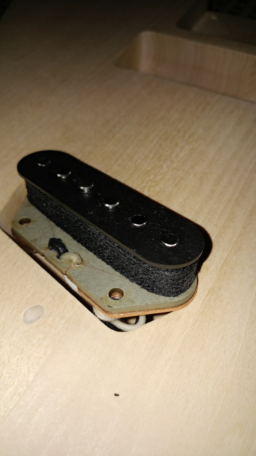

Attachment 20722oh man....I think I've just discovered that my bridge P/U doesn't fit into the cavity. what do I do?
Sadly this seems to be an issue with all the TL kits, I had to route the cavity about 6mm forward on the Tuff Dog and on the previous one with a 3 saddle bridge I was able to get away with longer saddle screws to get them further forward

just uploaded a photo...maybe that will answer your question?
Yep, looks like a little sander work, or some careful routing work to adjust that cavity. Is that a vintage Pickup? Looks cool!
Looking at the photo close up, you may just want to try wrapping some 40 or 60 grit paper around a large dowel (16, 20 or 25mm) and just tickling the corners out a fraction and that may be enough to get it in (the photo seems to show it overlapping one side by a fraction).
if its more than a couple of mm out then it may be router time.
If you've some sharp round ended woodworking gouges, they may do the trick in the absence of a router, if not then the safest, but slowest method would be using low number sand paper and adjusting each side of the cavity gradually to get a good fit. once you get your corners sorted out then you can use the same paper on a flat small block to even out the straight sides for a neat fit.
Before you get to that though I'd be tempted just to do a mock up, with PUP in the bridge plate and your neck clamped in place to see if there are any issues similar to Dave King's description. probably best you find these out now if they exist. Hope that helps

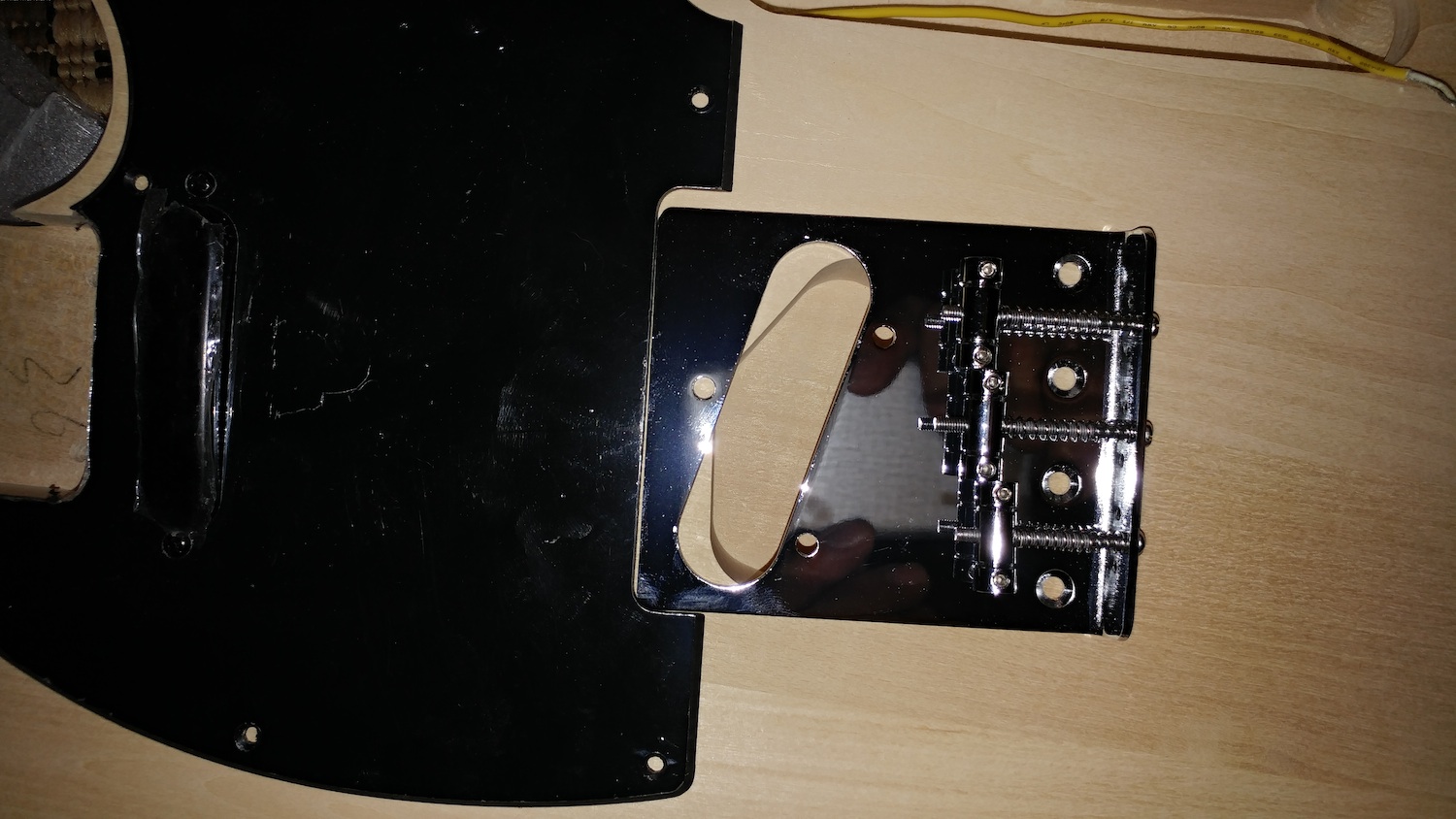

okay Dave, I've put the bridge up against the plate, and after viewing your post,Attachment 20723 I think I know what you mean. I'm now thoroughly terrified.....here's mine.
The 2 mounting screws at the bottom won't even hit wood at this point.
We'll get you through it mate, it could be worse. I elected to strip the fretboard and reshape the neck tenon of my first build, having not done any form of wood work since highschool.
The good part about it, is you can make up a template in 6mm or 9mm MDF based on your existing routed cavity. You then adjust that template, to suit the actual pickup, and then you can rout both the required adjustments at the same time.
What you will need to get though is a router bit with a guide bearing above the cutter head. Probably a 1/2" or 3/8" one would give you a nice fit to the curves of the cavity.
EDIT: The screws should locate into threads on the PUP to give you height adjustment relative to the strings I would assume? Or am i wrong in saying that for the TL Kits? TL Veterans, Assemble! Your wisdom required!
Have you checked your scale length? Before you start modifying/routing the cavity it's best to clamp the neck in place and check your scale measurements, then you can be certain where the bridge needs to sit and adjust if/as needed.
As a rough guide, the bridge plate normally sits about 2-3mm back from the edge of the pickguard. It doesn't butt right up to it (look at pictures of Fender Teles for guidance), though the control plate does sit right against the pickguard in its semi-circular cut-out.
The bridge plate only has the four mounting screws at the rear of the plate; the three around the cut-out are just pick-up mounting holes, so there shouldn't be any wood underneath them.
But you may need to enlarge the pickup rout a bit. Even Fender routs can be on the small side if you fit an aftermarket pickup with a slightly larger footprint. As people have said, a Dremel type tool with a drum-sanding bit if handy here and will save using a router. Just mark with pencil where the front edge of the bridge plate is, so that you don't enlarge beyond the front edge and leave a visible gap.

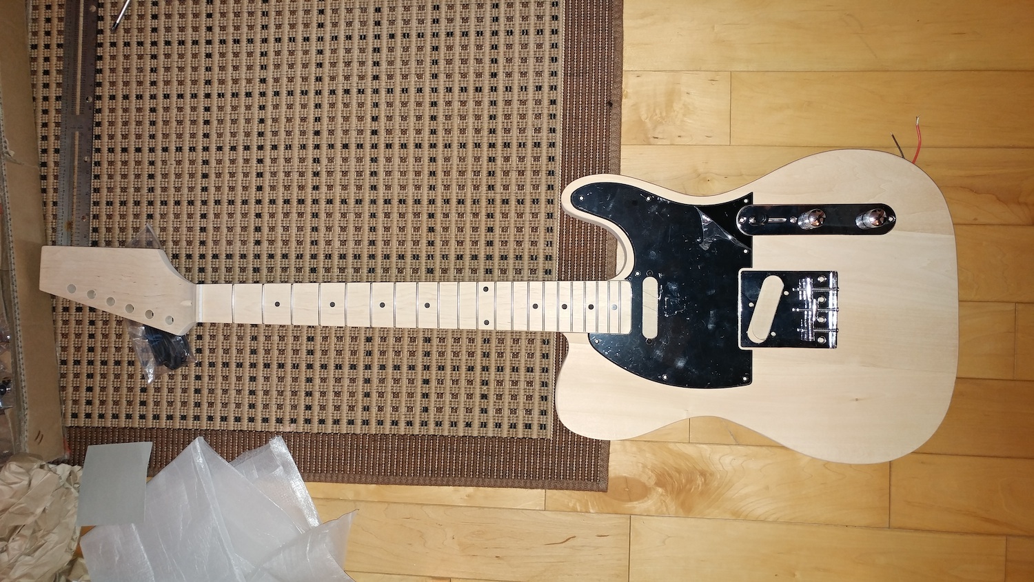

thanks for the input Simon - much appreciated! This is the mock up - I'm kind digging this colour too. More sanding, then I'll start the route.Attachment 20763
As Weirdy said the scale length is most important bit to get right. Once that has been established you will know if the Bridge PUP rout needs work.

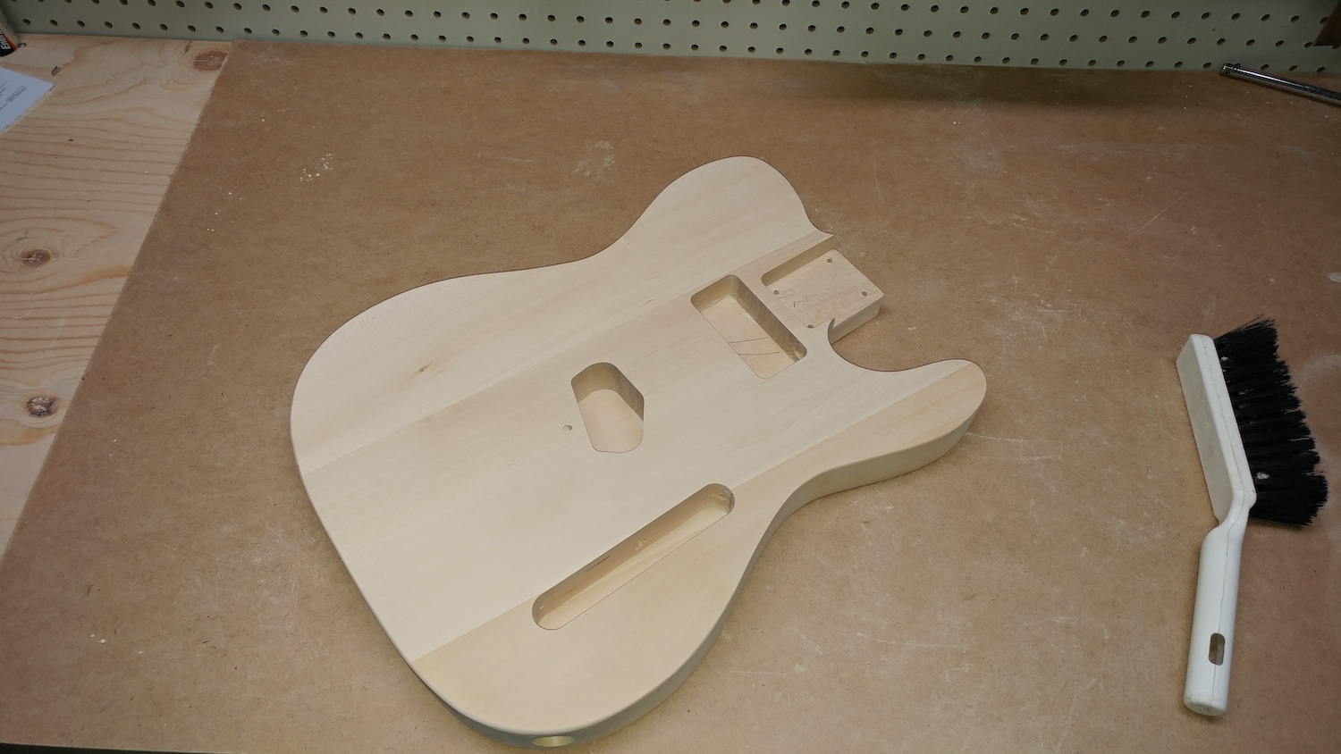

so here's the route doneAttachment 20799 - not as difficult as I imagined. P/U's are fitting nicely now. As far as scale length.....I've measured from the nut to 12th fret = 12 11/16 inches, so measured the same from the 12th to the saddle - lots of play in the saddles, so just wanted to make sure I'm on the right track. I know the scale length of a tele is 25.5, and 2 x 12 11/16 is a bit longer, but this should be fine, right?
Should be good Ian.
FWIW I normally set the bridge position with the high E saddle about 80% fully extended and on a F type guitar the saddles move further back from there so the E6 is around 6mm closer to the back than the E1 so you have plenty to work with
A Dave, said the top E saddle will be the one furthest forward, so if you set the top E saddle to around 80% (or say with 5mm of thread still showing), and measure from the top E nut slot (board side) to the top E saddle with double the nut to 12th fret distance, you should be fine for position and saddle adjustment. It's then just a question of getting the middle of the bridge on the neck centre line.

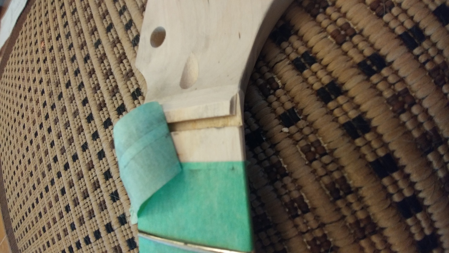

so I did this last night.Attachment 21341
Should I worry about it?
