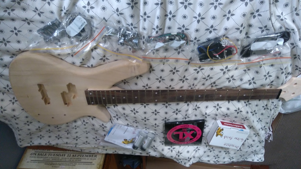

So I'm building a YB-4 as my first build. I'm going to post up a mock up tonight but I did a quick one yesterday. Looks good and I'm really keen to get it going. I'm going to stain it using DT bushfire sunrise and mission beach. Because this is my first build I'll probably have a few questions for the forum and any advice would be greatly appreciated.

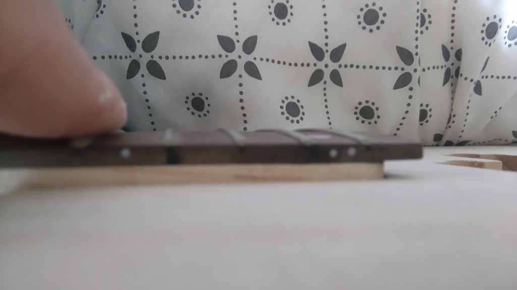

So i did a mock up build. looks good. only one issue. the fingerboard sits a couple mm above the body. how should i go about fixing this?
Attachment 18328
Attachment 18329
There's nothing to fix, that's actually how it's supposed to sit (to give sufficient clearance for the height of the bridge). The important thing is how the neck sits relative to the bridge/saddle height, and therefore how the string height (action) will be.
If you clamp the neck in place and then sit the bridge on the body and run a string/fishing line from a nut slot to to the corresponding bridge saddle it should give you an idea if the neck is sitting correctly. Are you using the stock bridge?

With the Fret board level they always look to be sitting a bit high but when you consider that bass bridge saddle at their lowest point sit about 15mm above the deck hopefully that provides some perspective to how it should end up.

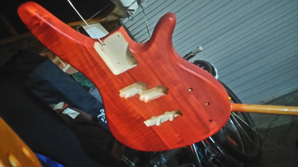

So did another coat of bushfire sunrise on the body and a cot of 5:1 mission beach to bush-fire on the neck. i think it's looking pretty much exactly like what i had picture (maybe a bit deeper on the body but this will be accomplished by the intensifying coat).
Pics aren't great quality but show more or less the color.Attachment 18432
So on Saturday I put the first coast of intensifying and I think it's just about where i want it. Any tips for finishing (especially regarding the neck)?
Pics to follow
Hey SWAM, looking good. If you are happy with the depth of colour, let the last coat fully cure, give it a light rub with super fine steel wool and start your final coats.

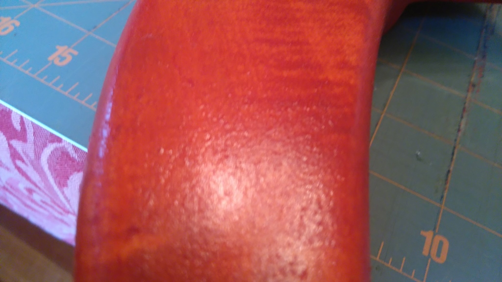

So today I was going to start with the final coat on the body and noticed some small bumps and particles in the finish (see photo). any recommendations on what I should do? thanks in advance.
Attachment 18604
I'd do some careful wet sanding with say 1500 grit paper. Light strokes as you want to level it, not break through the finish.
Put first final coat on body and 2nd final coat on neck. Manage to work out the kinks with the body with some sandpaper, steel-wool and elbow grease. Pics to follow

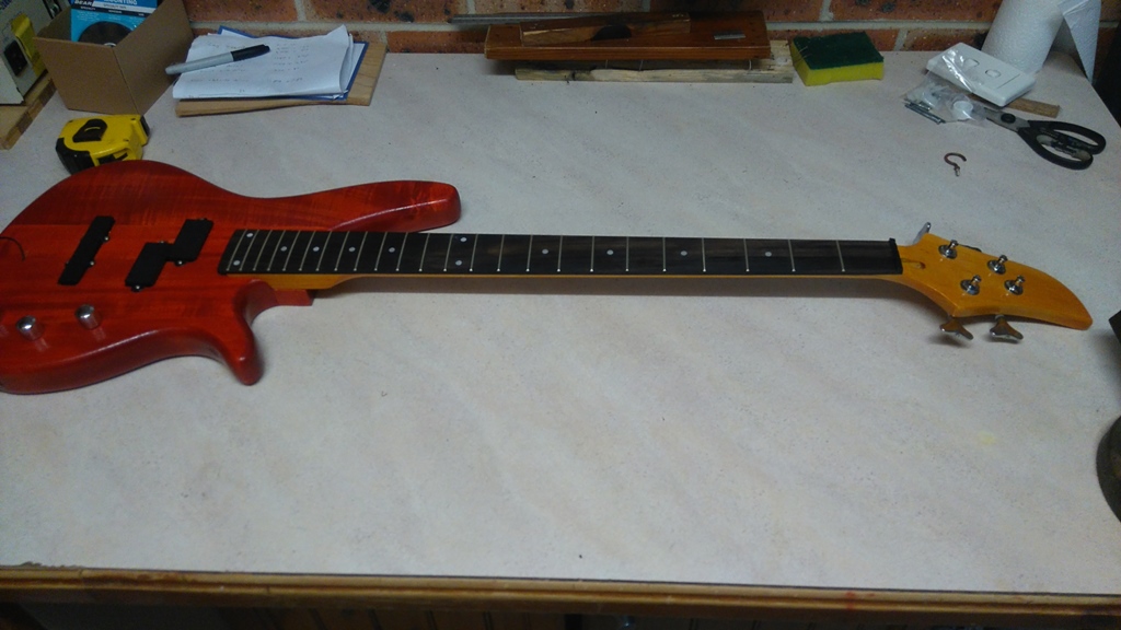

I am getting the back plate (the one that's used for screwing in the neck) engraved and will put that the bridge on soon.
Attachment 18893
Looking really nice. Can I take it that the black 1/4 circle line on the far left isn't a mark on the body?
Good pick Simon - looks like an earthing wire for the bridge when it's installed.
Oh, of course, yes! I should have put 2+2 together. It simply didn't register that there was no bridge on it at all as it looked so complete. D'oh!

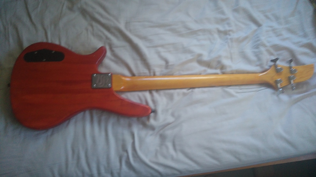

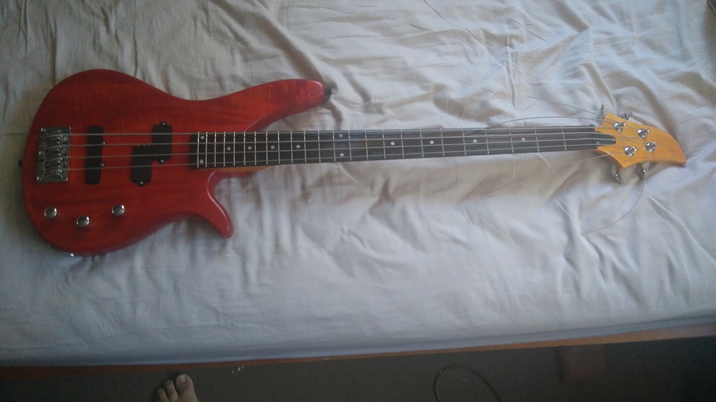

Attached the neck fitted the bridge and re-did on of the solders and now it's basically done. Just gonna sort out the intonation and action on Monday w my guitar teacher. Here's the final specs
- Stock pickups and electrionics
- Stcok machine heads
- aftermarket bridge
- sandblasted neck plate
- dingo ton bushfire sunrise body (2 coats of each coat)
- Mission beach neck (1 coat mission then on mission beach bs mix then two final coats)
- Da'adario semi-flat strings
Attachment 19018
Attachment 19019
Attachment 19020
Very nice, the neck plate looks great too.
Nicely done - worth entering the GOTM comp! No prizes only glory! http://www.buildyourownguitar.com.au...391#post137391
Great looking bass, that neck plate came up well
