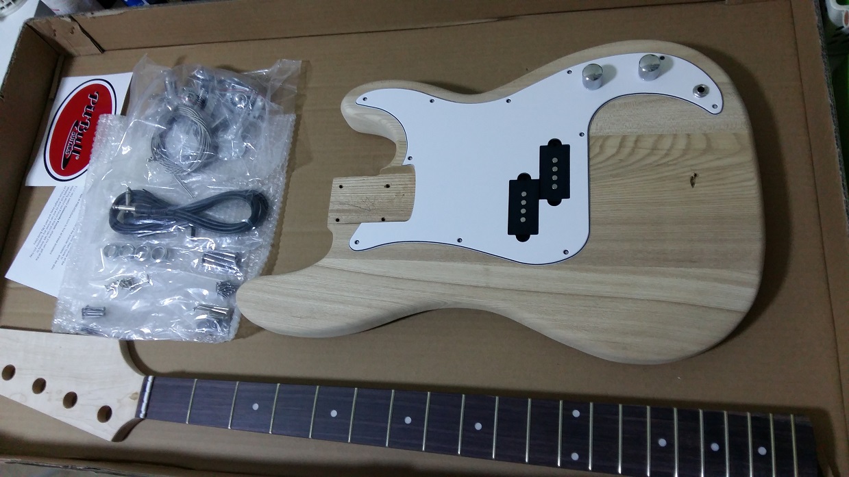

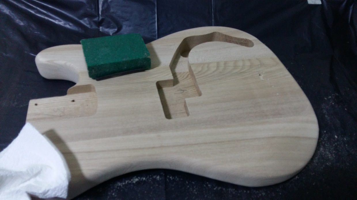

The kit came exactly on Christmas eve! Unpacking and checking the items with excitement, seems all is well, expecting a lot to look forward to building up my first own P-bass. Here is my diary. Your advices and information will be appreciated very much.

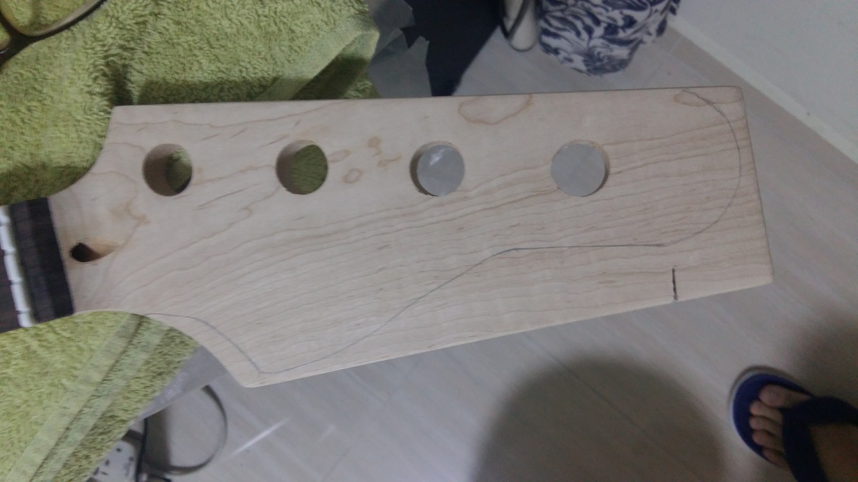

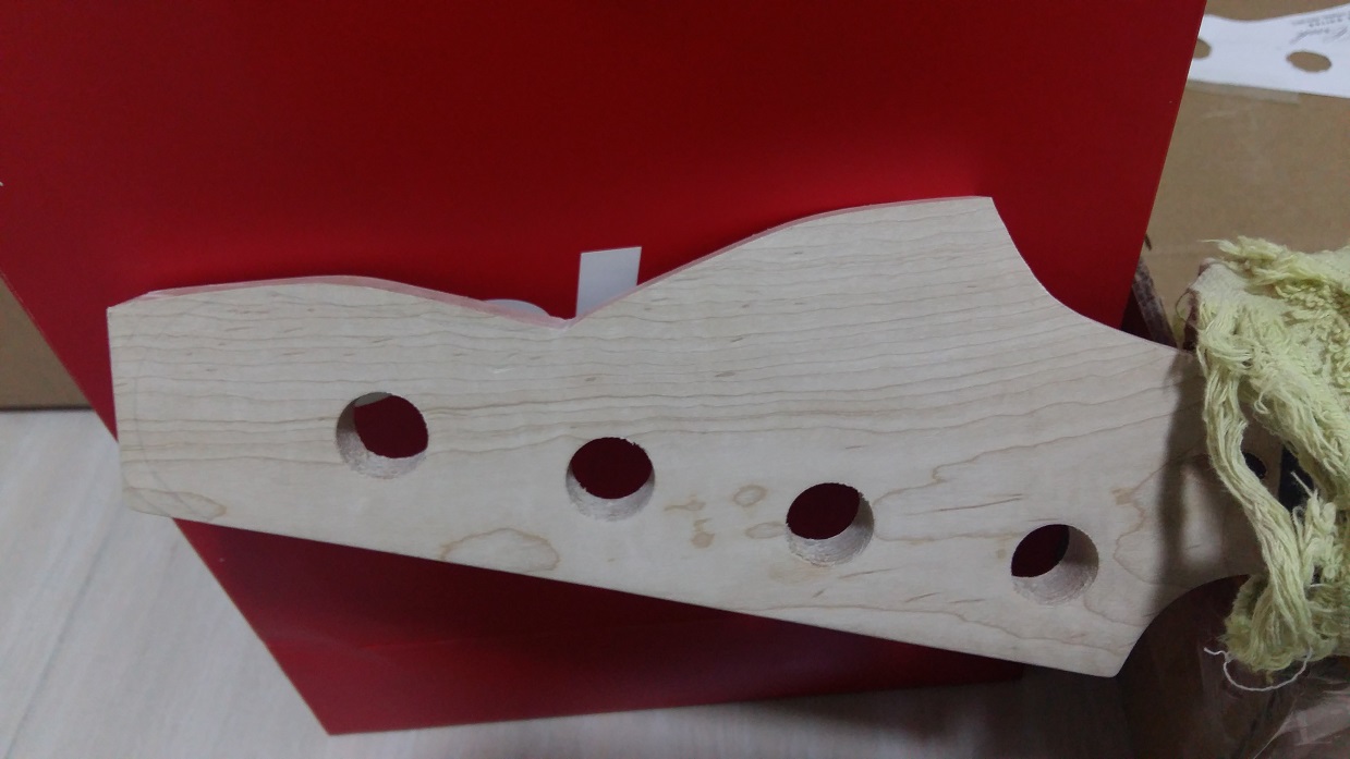

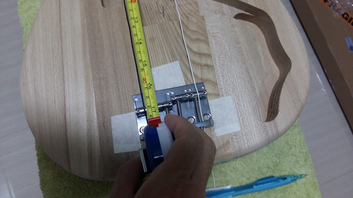

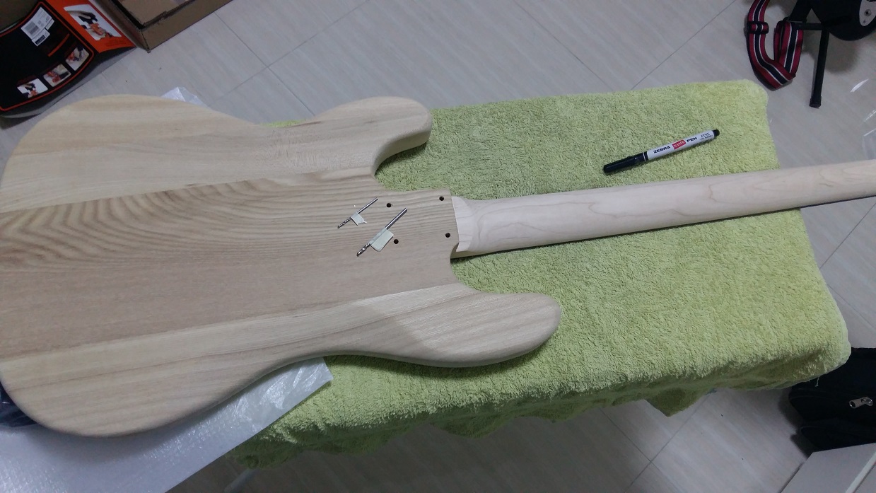

Day1. Started with mock build and looks fine. It is beautiful Ash grain!
Attachment 16026

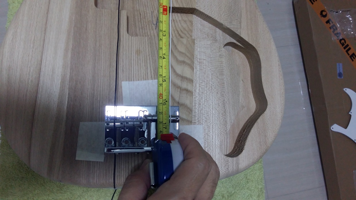

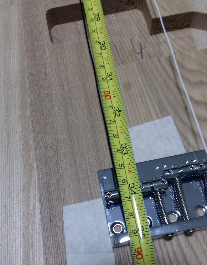

Attachment 16027

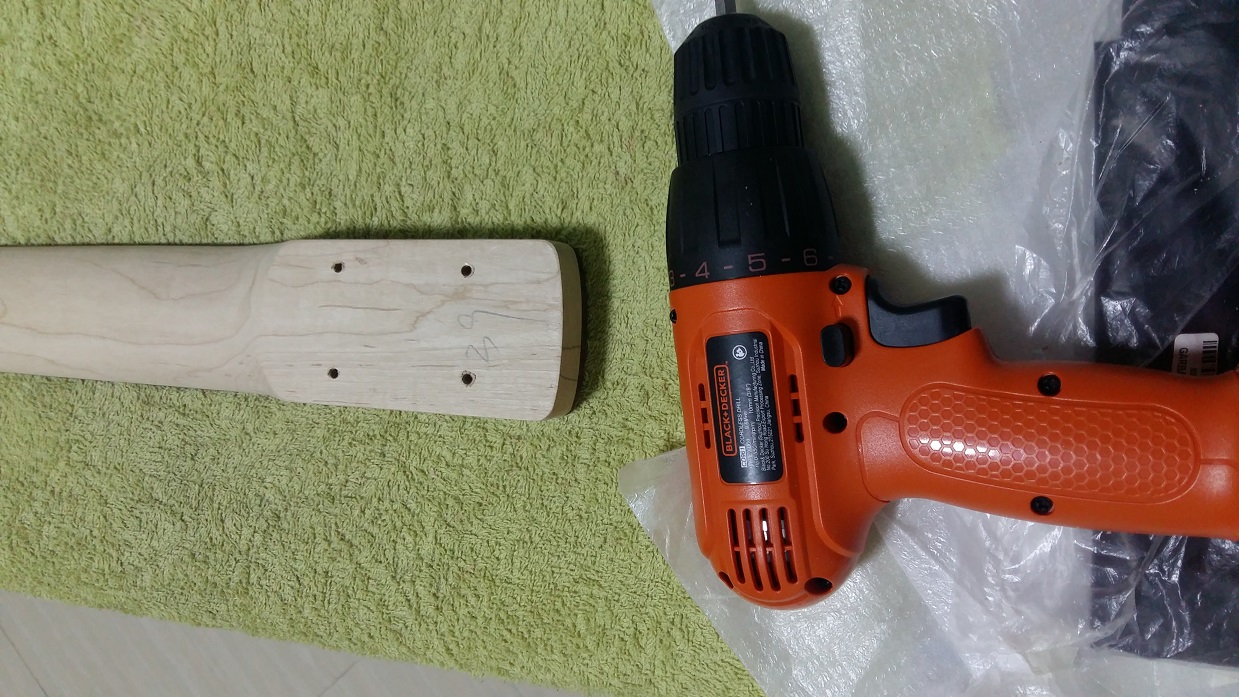

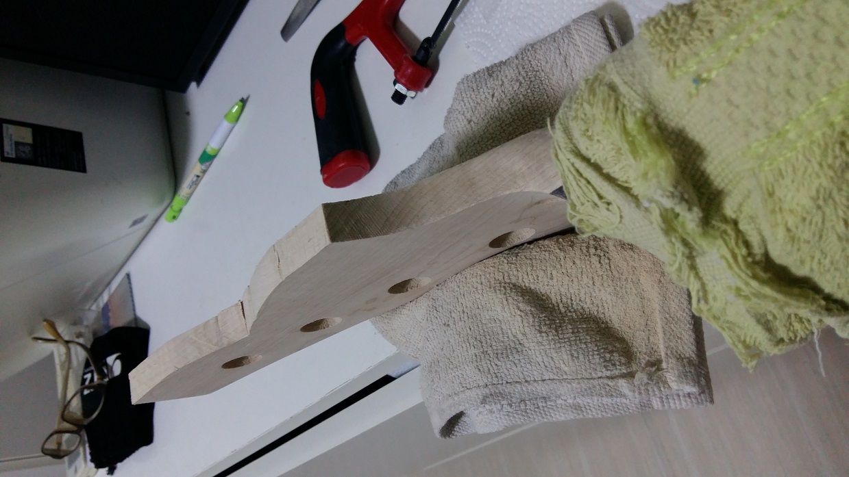

Day2. I made a hole on the neck to bolt on body. I purchased e-drill/driver from hardware shop and found its very useful.
Attachment 16028
now done the hole. :)

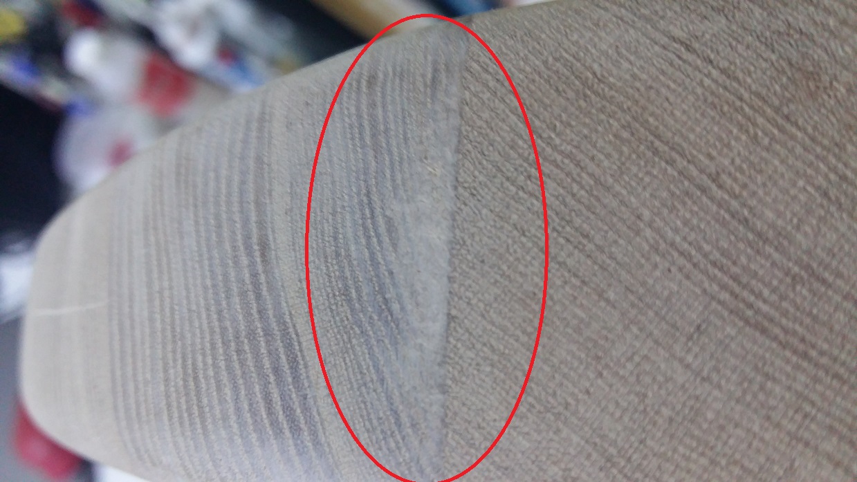

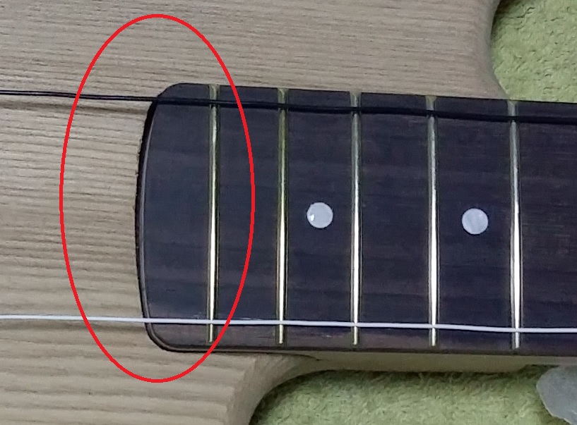

Attachment 16029
Ooops, at the very first step, I think made a big mistake… there is quite a space between neck and body. hope this won't cause problem with sound....
Attachment 16030
