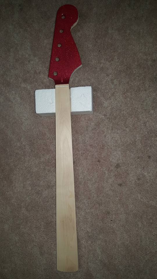

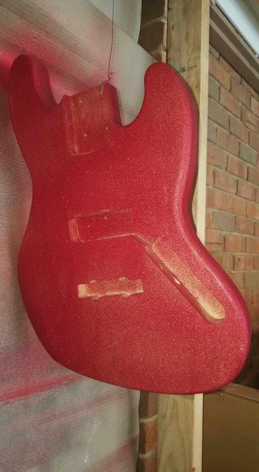

Dude, Slow down!!! You're making the rest of us look bad!!!:p
Haha Zandit. This has been over the past month. Just finally got around to posting them.

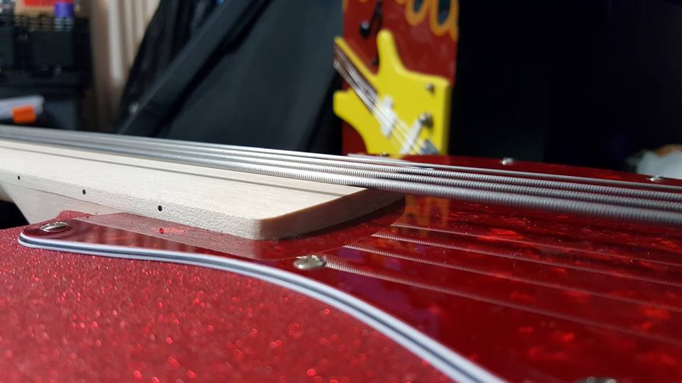

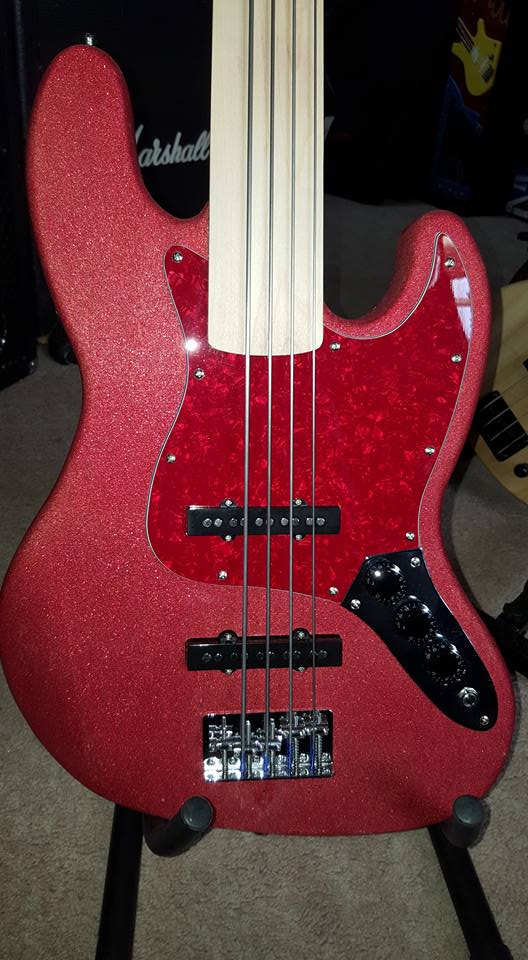

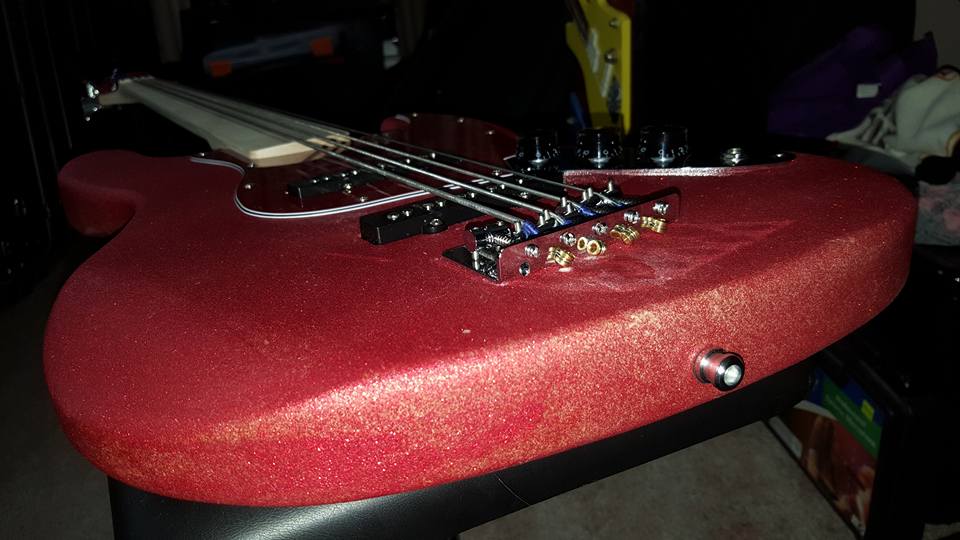

Looks like a fretless. If you have never used or owned one they are lots of fun to play. Just takes a while to get the finger positioning in the sweet spot that is not out slightly of tune.
Yes Waz, it is. I own a few. The sweet spot i figured out to suit my fingers is that the left side of my finger is in line with the end of the dot on top of the fretboard of the note i am playing. I have a clip on tuner, so i keep checking, and thats the best way for me to remember the finger position.
If you are good at playing by ear that kicks in after a while as the dots only represent points along the neck and not every fret position. On my current Fretless I ripped out the frets and used filler so that I had lines to show where fingers should be when playing notes as that made things easier for me.

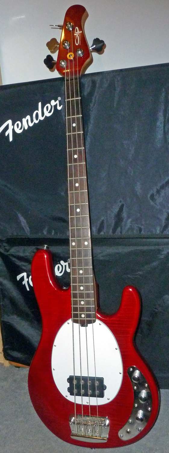

I had an OLP Stingray bass that looked very much like the MMB-4. I can't see any details on the pickup wiring, but given the three control knobs are 2 x volume and 1 x tone, it must be configured in the same way. Each of the two coils of the pickup has its own volume control, so you can run both full on for a thick fat humbucker sound, or turn one or the other of the coils down for a single coil sound (plus some increased noise). It's actually very versatile arrangement (though you have to turn both volume knobs off to silence it). If that humbucker really is like the one that came with the OLP, then it's not worth thinking about upgrading it.

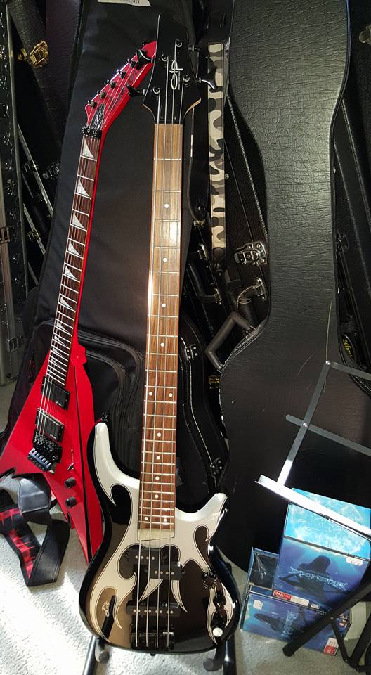

I have an OLP bass which i came across accidentally and got it for a really good price. Here is the pic.
Interesting, I've never seen one like that before, though they may have made different models for different markets. This was mine.
Attachment 15216
Very nice Simon. I have got my eye on a chrome scratch plate to match the chrome hardware that comes with the MMB-4 bass kit.
I took it to a band rehearsal to see how the bass player liked it, and I never got it back. About three years later he eventually paid me for it.
