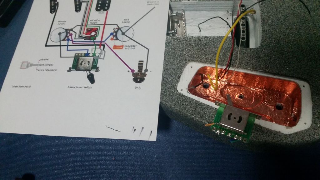

I'm planning through my wiring up of my Carson re-build - http://www.buildyourownguitar.com.au...ead.php?t=6284
I have sourced 2nd hand components from Waz and another friend, and I would like some wiring guidance, as I am changing things up a little from the original set up.
Below is a photo of my components
http://i640.photobucket.com/albums/u...psmzpq72rd.jpg

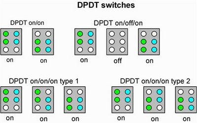

I have a standard looking Humbucker(taken from an EX-1 Kit - 12.1k), a Korean WSC 4-wire Hot stack Single, and a standard single from a Korean Magnum Strat copy. There are two Pots(1 x A500k, & 1 x B500k), a standard Strat style 5-way switch, and a small 3-way microswitch(on-on-on) that I want to use for the Hot Stack PUP.
Here are a couple of photos of the Hot Stack wiring diagram that came with the PUP.
http://i640.photobucket.com/albums/u...psjq1kfgax.jpg
http://i640.photobucket.com/albums/u...psjy94r5c1.jpg
http://i640.photobucket.com/albums/u...pswmr2wy1u.jpg
If anyone can assist with a suggested wiring diagram it would be most appreciated.
Any questions, please let me know, and I will try my best to fill in any gaps.
