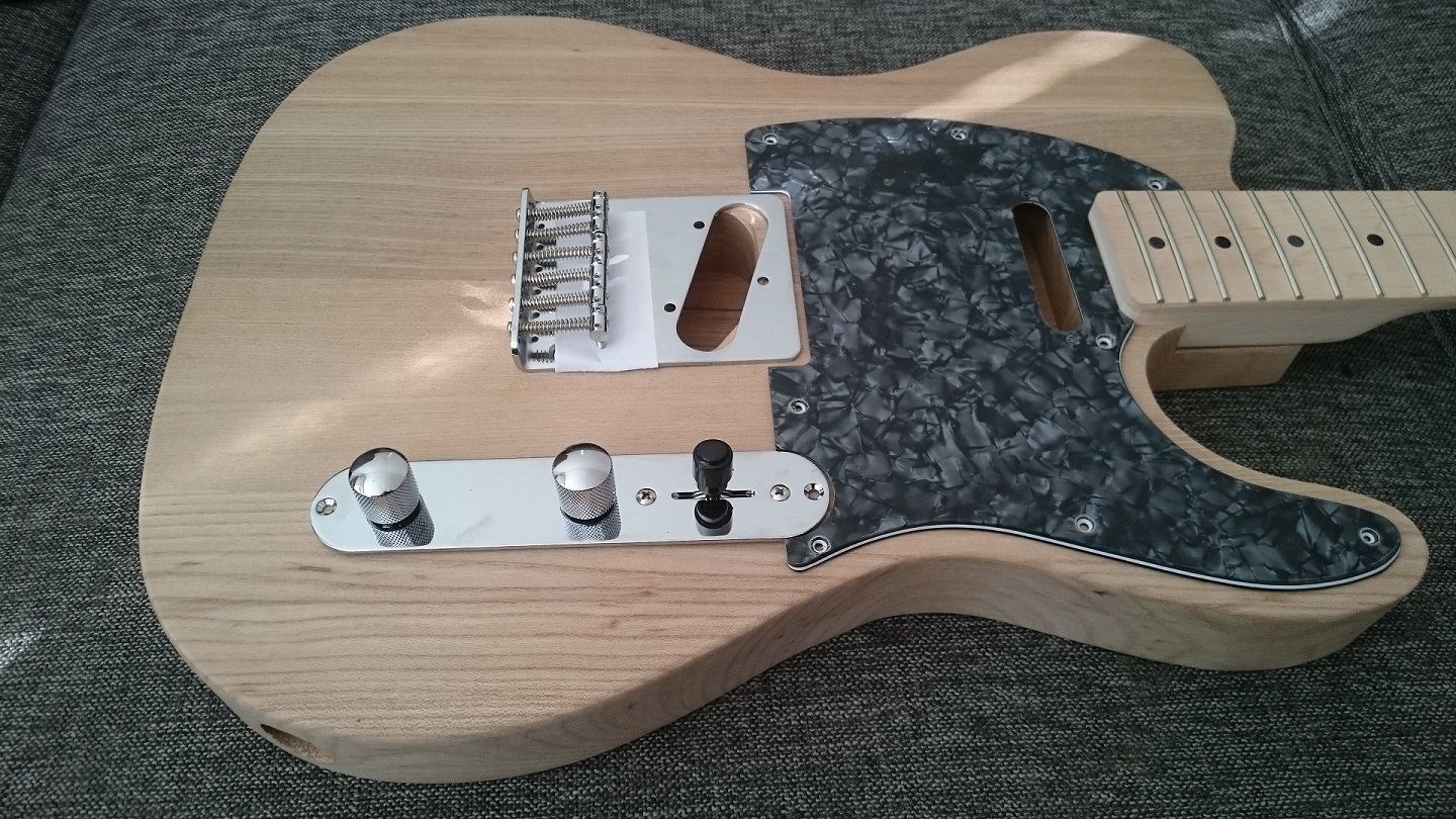

4 Attachment(s)
Ok....

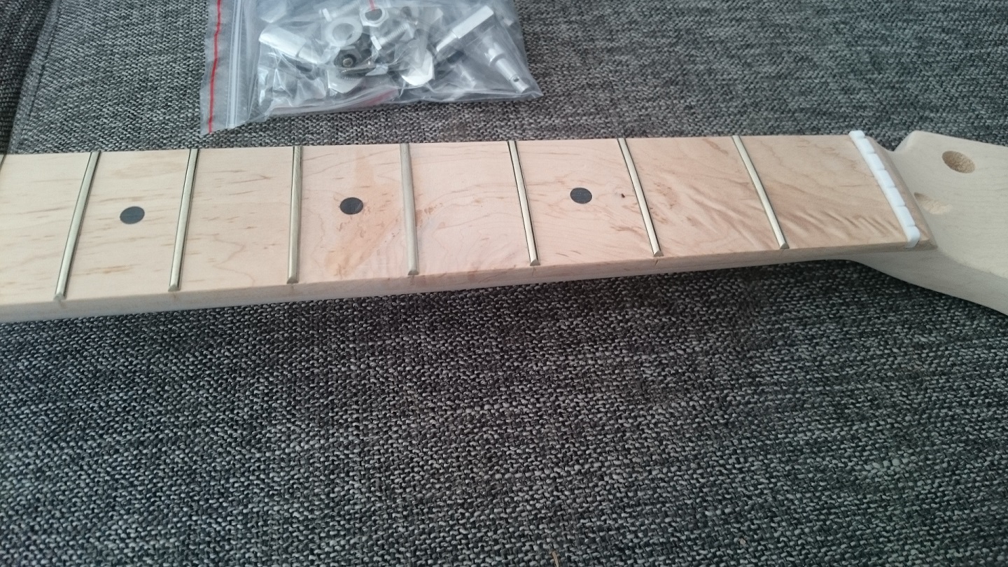

Got to mock up build stage at last. The neck would seem to be a good fit to the neck pocket - when treated wit TO should be a nice tight fit. Nice straight neck too with a fun grain on the fretboard.
As Iīm switching to a six saddle bridge, I have to route the pickup cavity larger to be able to fit the neck pup as you can see in the picture. The bridge is placed where it should be 2 x 323mm (saddle to 12:th fret distance) and it needs some extra space.
The pickguard is a perfect fit and so is the control plate.
Havenīt tried to fit the 4-way switch yet to replace the stock one if it fits but I'll work it out if it doesnīt.

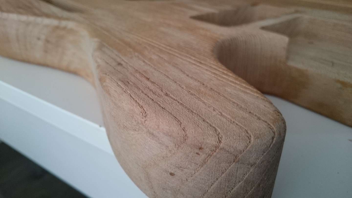

A 4 piece body is showing some nice grain and even though it has some different shades itīs ok for the color scheme Iīm after. Actually should work great with the "banged up" look.
Decided to switch to Wilkinson ez lok tuners as itīs a cheap and easy mod. Bone saddle is on it's way too.
Next week It'll be sanding and placing the bridge with routing the pup cavity. then drilling the holes for string through placements.
Can't wait to get started on this... :)
[ATTACH=CONFIG]14153[/ATTACH
Attachment 14154
Attachment 14155
Attachment 14156

I am seriously impressed with the grain on that maple fretboard Arzi....nice score.

the first step in "distressing" the wood is close to done. I found a great youtube video on how to take out some of the softer wood between the grains with a power drill and a brass brush (or something). took it with the grain and her are some results. Maybe gonna work on it little more to tidy the grooves up a bit or not.
next it's some banging with different tools and making some "worm holes" on appropriate places. What this type of removing wood should do is I propably won't have to use different shades of stain becaus it will soak more on the harsh grain and also create natural shadows in the cuts. all it should need is a light sanding in the end to create lighter areas on the color and grain.

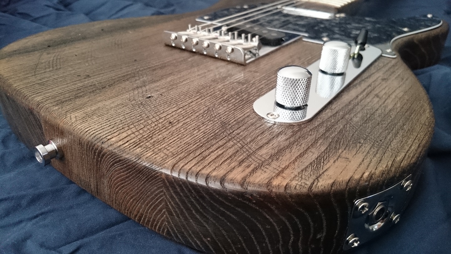

5 Attachment(s)
Okay...

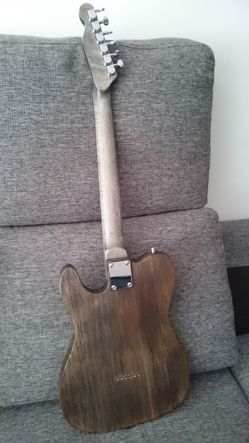

So I got the body "abused" and went to staining it and puttin on the Tru Oil. Had a hard time banging the body and poking extra holes in it - my heart almost bled but in the end... well you decide.
The color was what I was aiming for (weatherd gray) until the coats of TO when it turned mostly brown color. Still a hint of gray is there but main thing is it does look like something out of a barn wall. Steel wooled the 4 coats of TO and came up with this.

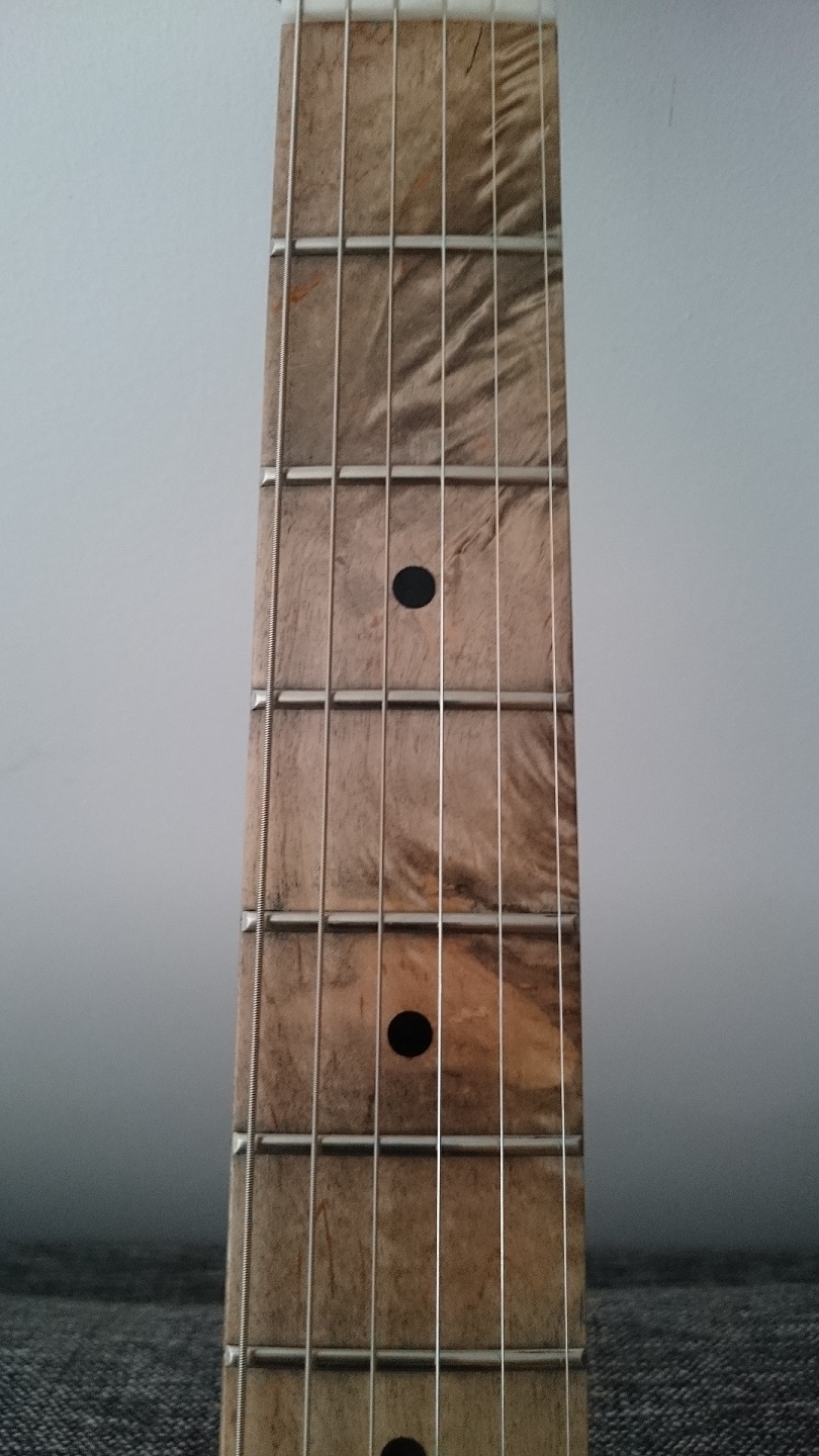

I really love the flames on the fretboard. Gray stain sanded away and TO on the neck.
The real color is way more brown than in these pics.
Here goes:
Attachment 14549
Attachment 14550
Attachment 14551
Attachment 14552
Attachment 14553
Love that fretboard, and it'll only get better with wear.

Unreal, great look and the fretboard is a stunner. It's going to contrast well with the body

cool effect on the fret board and a nice "sandblasted" look on the body.

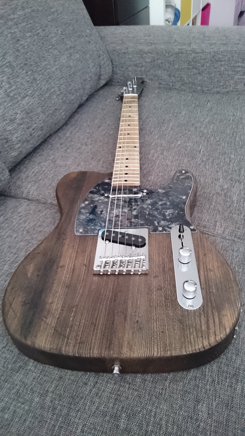

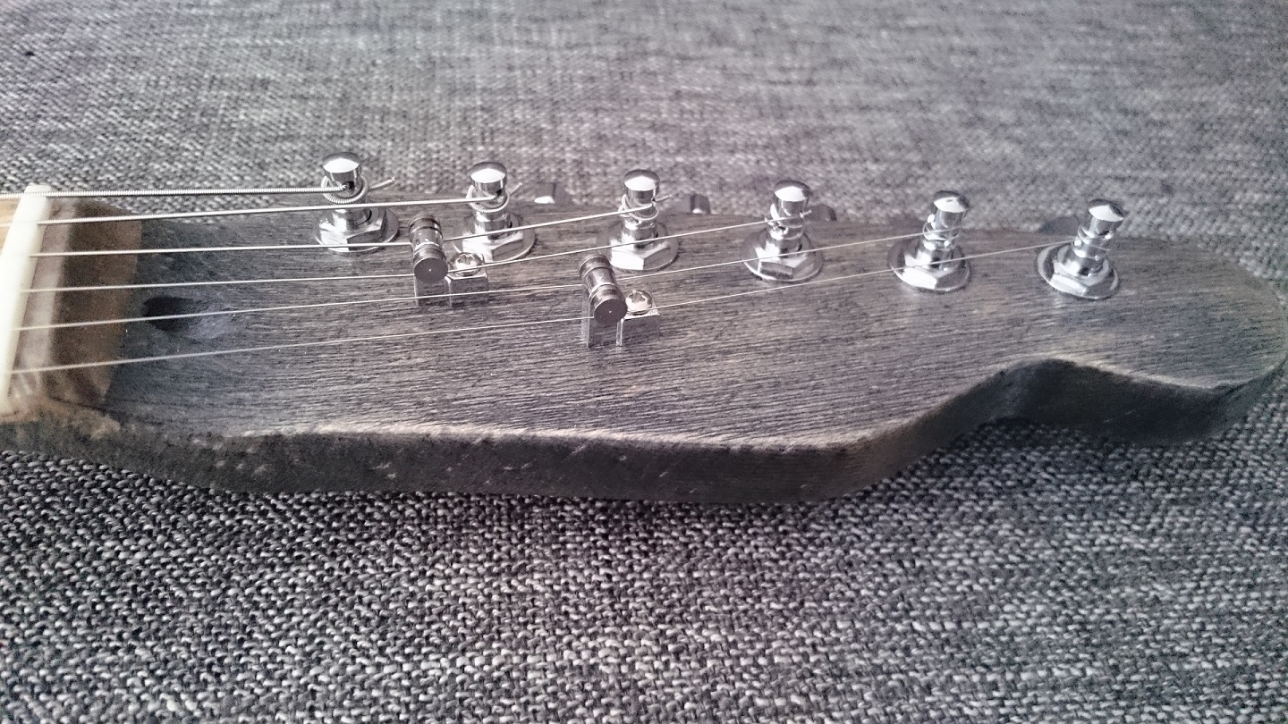

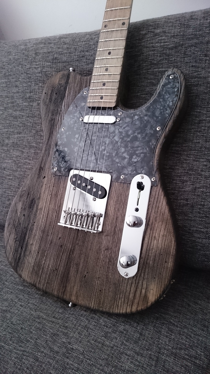

5 Attachment(s)
Hi everybody
I didn't seem to have time to post any of the work phases until now and the Barncaster is finished. :)
Got it set up and going.
Electronics are 500k pots (yes I know - 250 would be the standard), 0,47 capasitor instead of 0,22 (yes I know...). 4-way switch to add the series effect. Found out a story about using a 0,47 in a Tele would do something amazing so I tried. Conducting aluminium tape to the pup and control cavities.
Q Pickups Alnico 5 Tele set with 6,225 KOhms in the neck and 8,01 Kohms in the bridge. A Kroatian small time manufacturer and they should have been made with "vintage" specs including for example using bee's wax (!?).
6-saddle bridge for better intonation
Wilkinson EZ-LOK tuners (wonderful product if I may add) and rolling string trees
D'Addario EXL120 42-9 strings (I messed the Ernie Balls while tuning... :( )
Levelled and polished the frets
Haven't been able to try this one with a good amp so far but everything works with my practice amp.
Here goes:
Attachment 14780
Attachment 14781
Attachment 14782
Attachment 14783
Attachment 14784

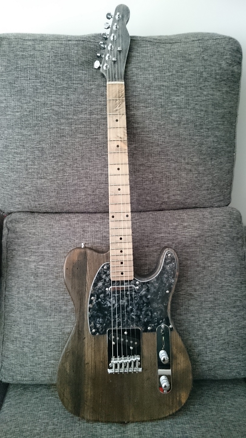

3 Attachment(s)
More pics... for some reason my phone's camera took some really grainy photos. Have to get some better ones if I decide to take part of a GOTM
Attachment 14785
Attachment 14786
Attachment 14787

Arzi, I love it. It looks like it could have been made out of old fence palings. Great attention to detail.
