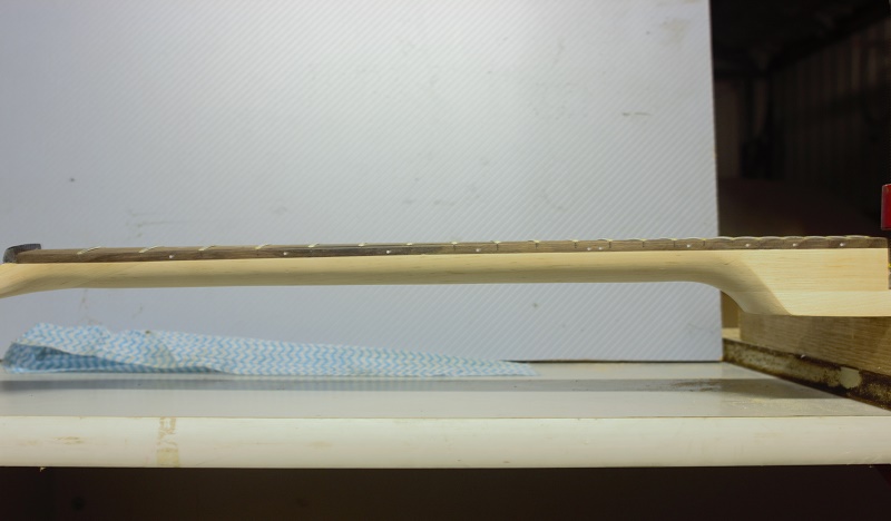

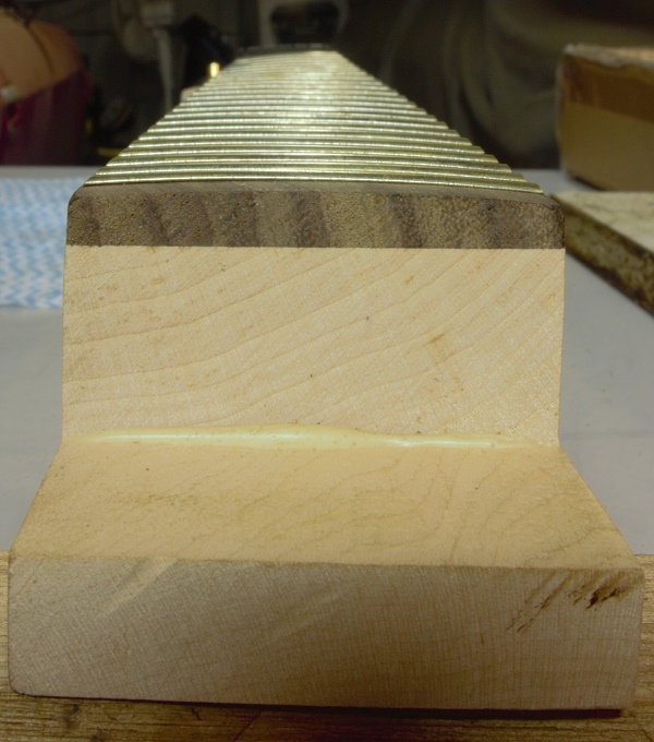

Anny way, you can see in this picture that as the neck approaches the nut it twists anticlockwise.
Attachment 12909

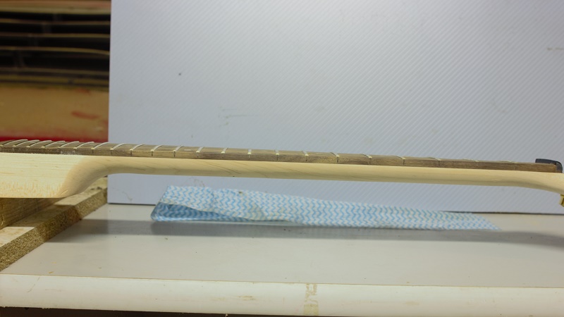

I this side view you can see the top of the fret board on the left but as you look to the right you can only see the side.
Attachment 12910
This is the view from the other side, and again you can see the top of the fret board on the left but as you look to the right you can only see the side.

That neck looks more warped than a Collingwood FC fan !
to send a PM go to 'Notifications' top of the page, then click 'inbox' then under the headings 'My Messages' 3rd from top left there is a 'send new message' button, click that and you just type the username of the person you want to send a message.
Hi Zygoat,
As per my email, yes, this does look twisted at the headstock end. I think we should get the complete kit back and replace with a new one after we double check the neck.
We can send you another kit and include a return shipping label which you can put on the box and drop at your post office.
If you're happy to do this I will arrange asap.
