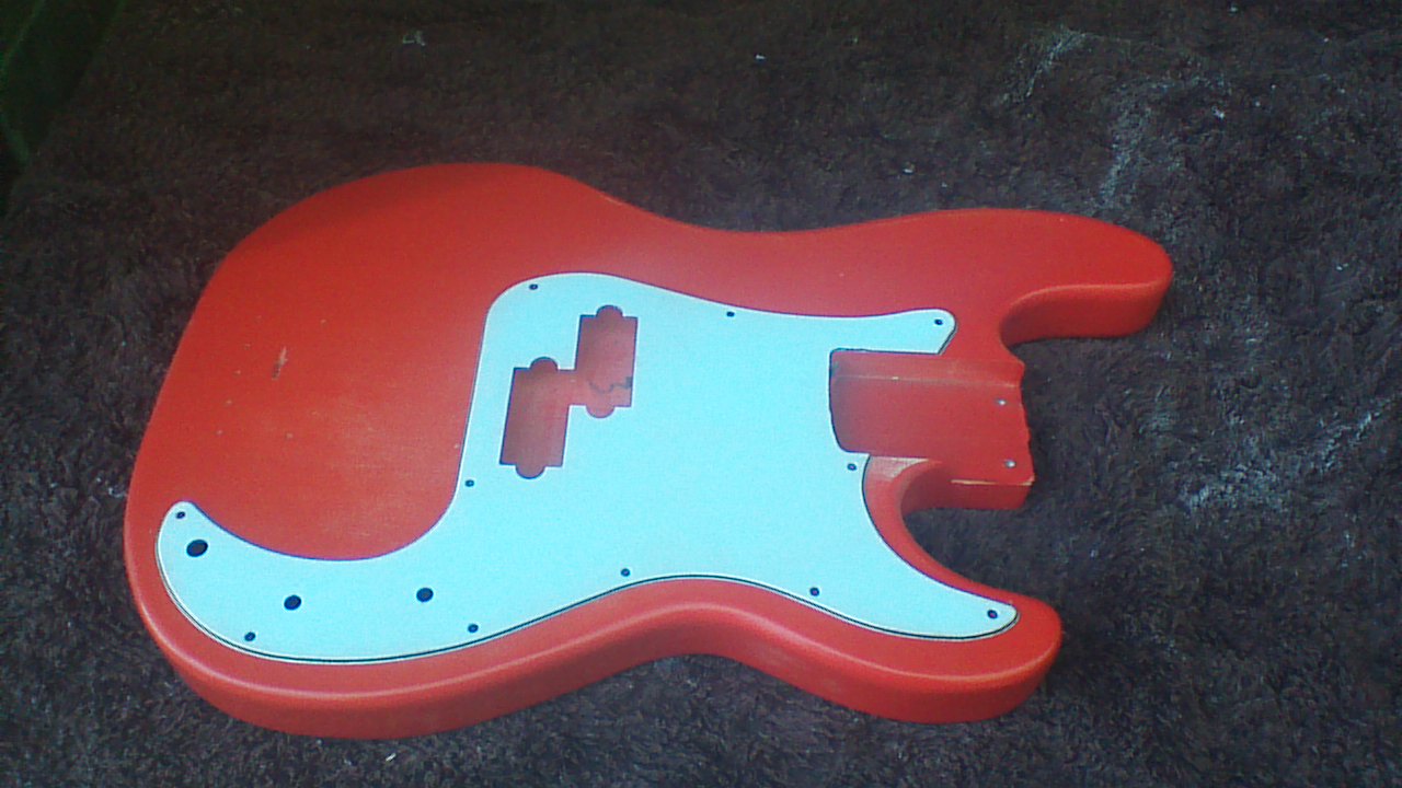

Sprayed 4 coats of nitro Fiesta Red. Thinking I might do the fender custom shop relic thing where they do white over red and then expose the red. I have a can of Olympic White so might give it a go.
Attachment 13649
Looking good! I'd be interested to hear exactly how you did the relicing once you've finished the process, I was thinking of doing a flat khaki-ish green exposing rust-red exposing silverish metallic at some future point and trying to make a bass look like an old tank.
