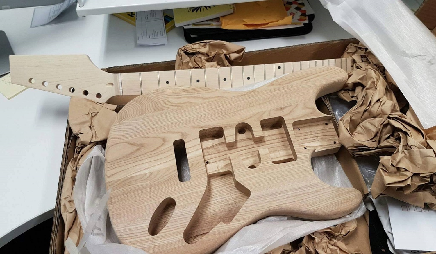

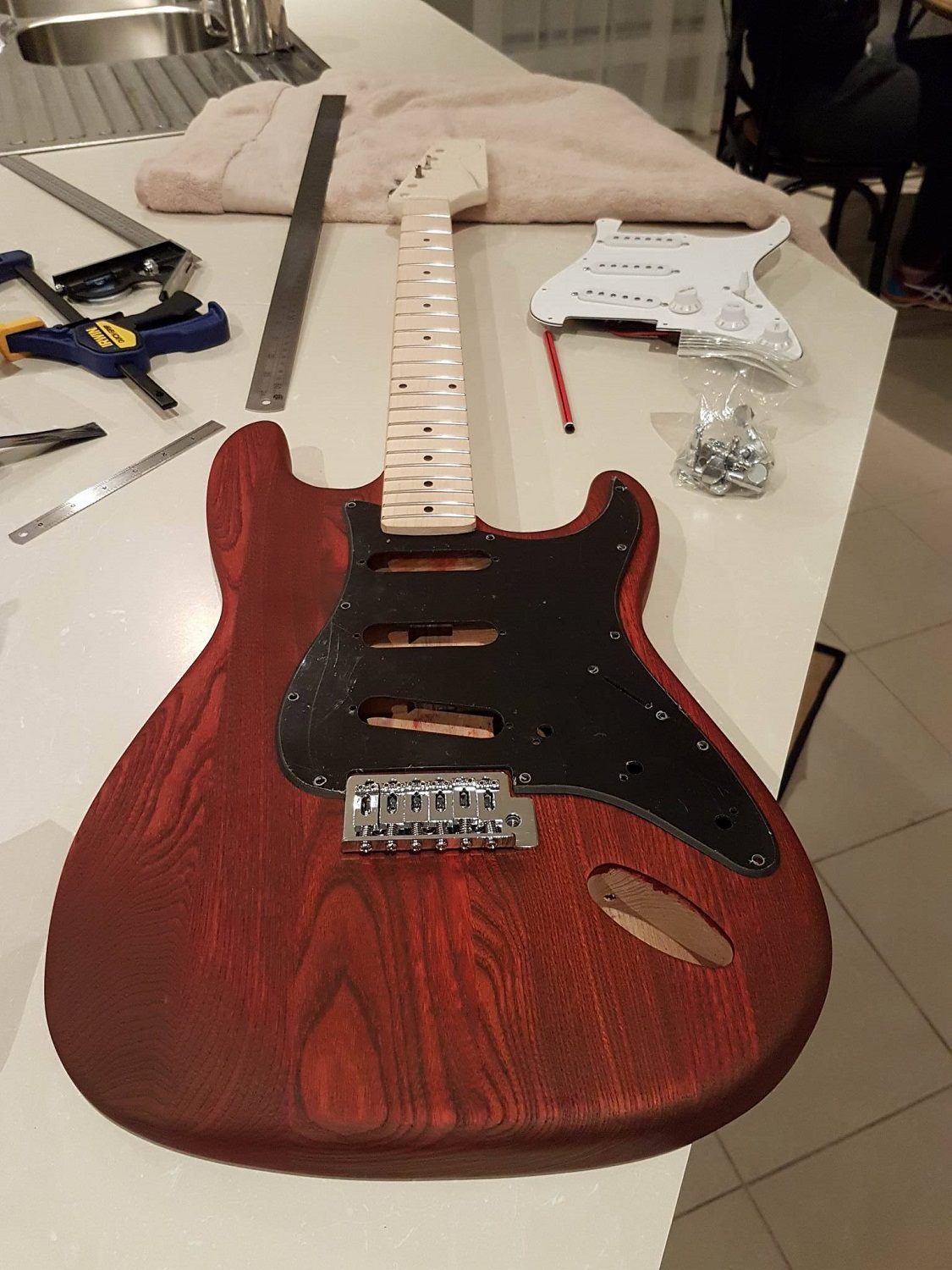

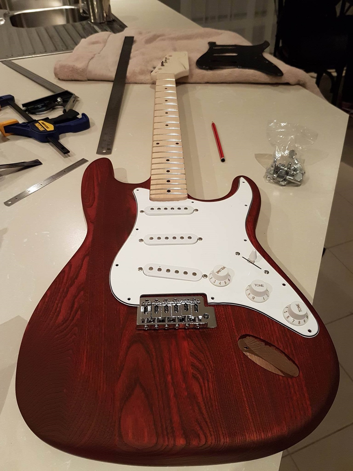

So... I ordered the STA-1M kit from adam a few weeks ago.
Along with the stock kit, i ordered the Grover tuners and a bone nut to suit.
I need to order a bridge, and i like the look of the Babicz FCH bridge.

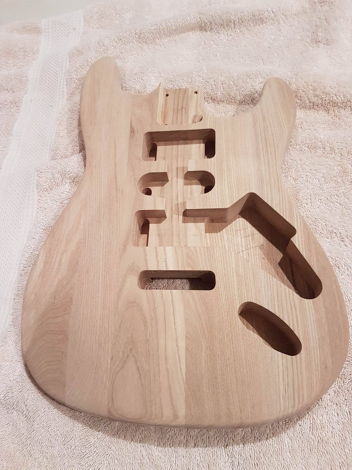

Day of Delivery :D3

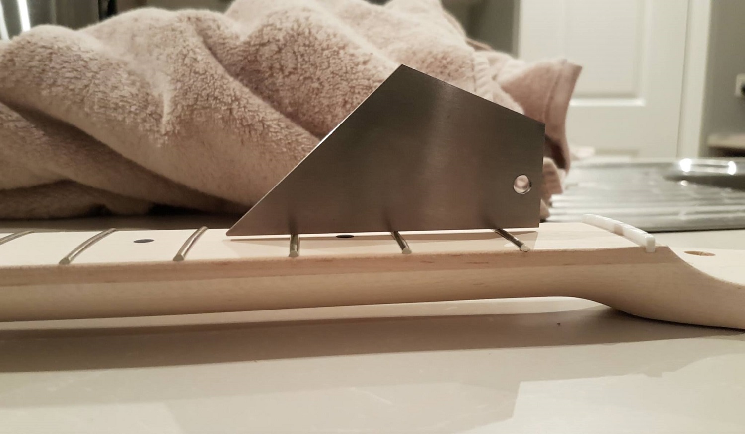

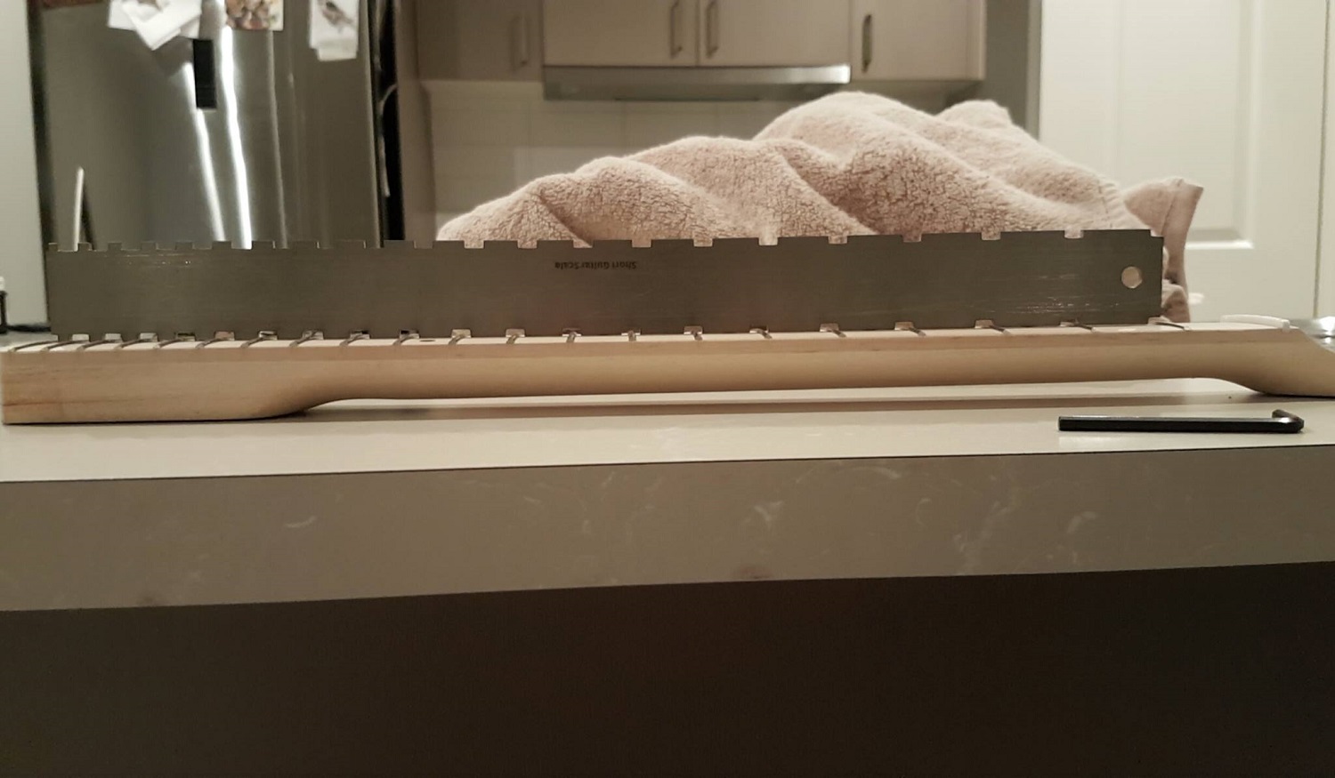

Cue, 1 notched straight edge, fret rocker, fret files, switchcraft output jack, doublesided copper shielding and some tightbond.

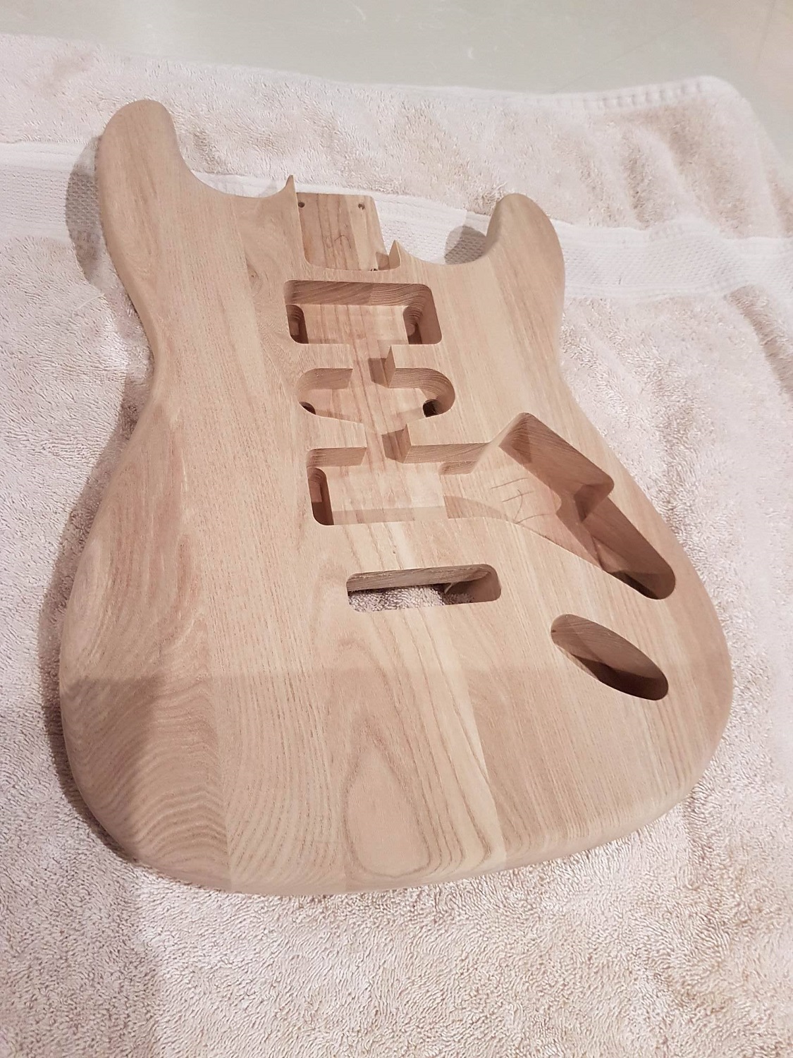

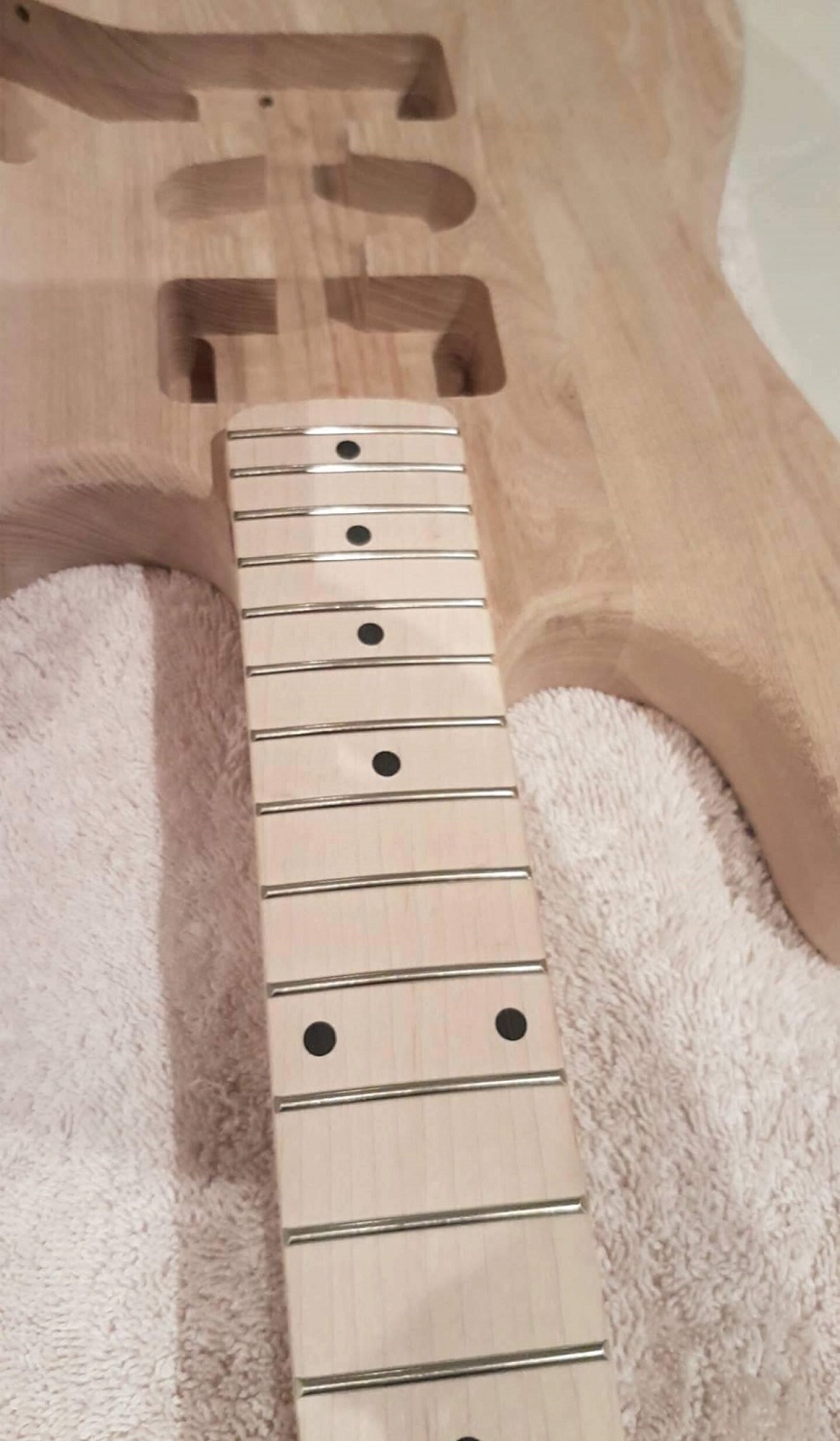

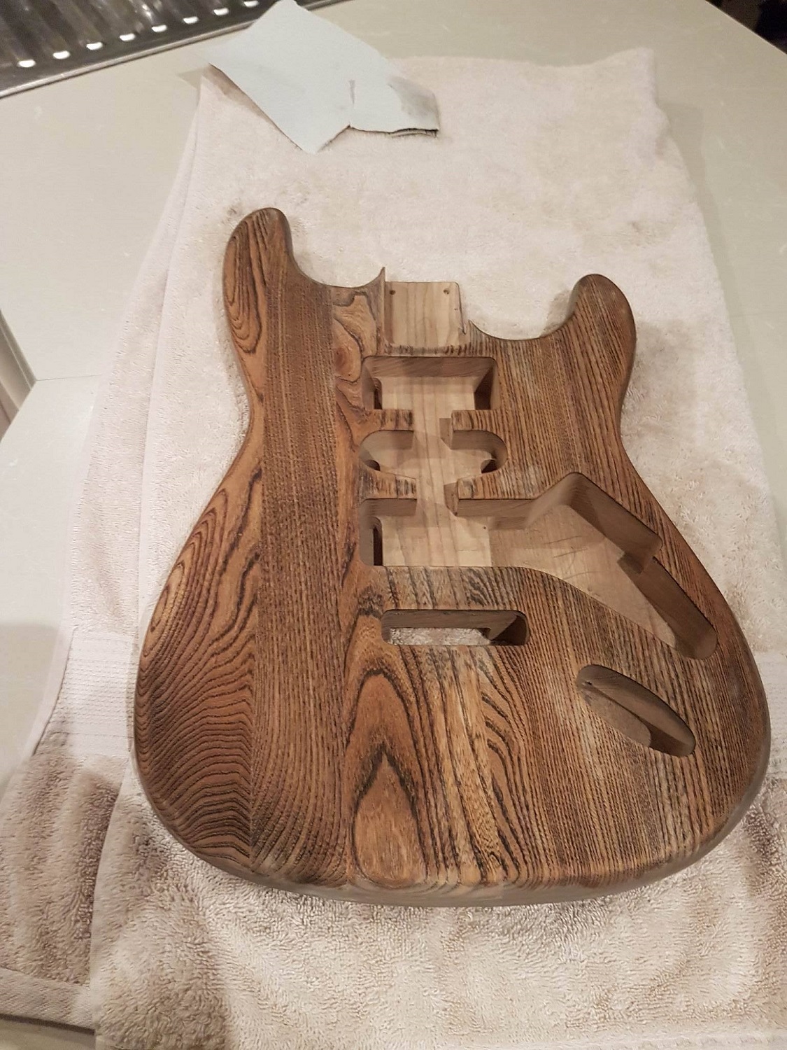

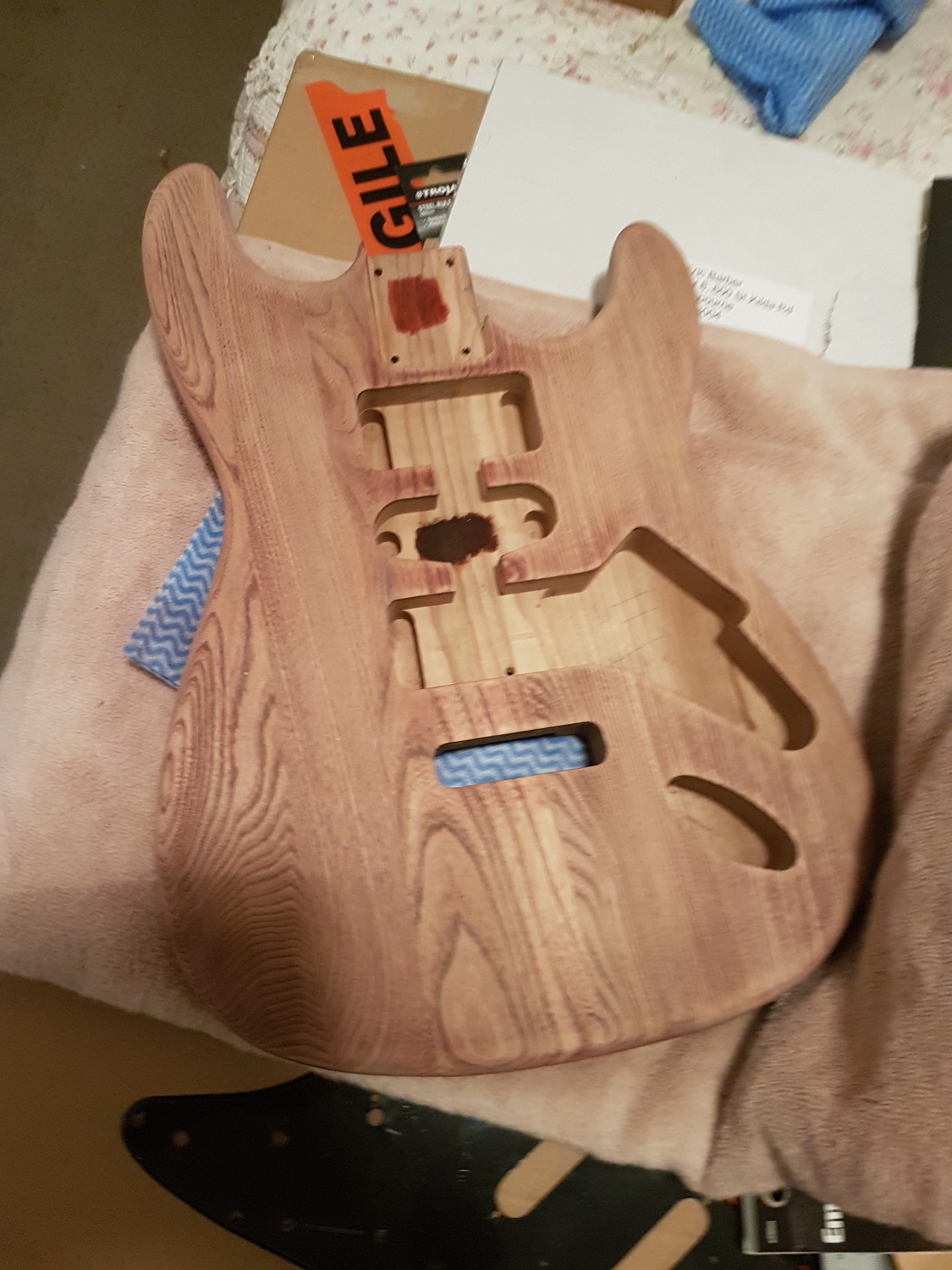

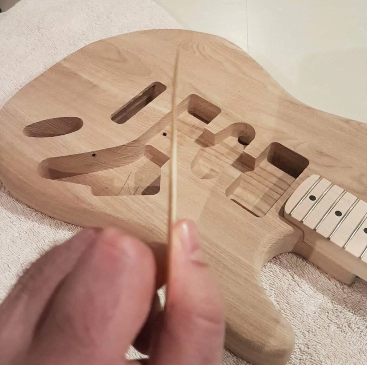

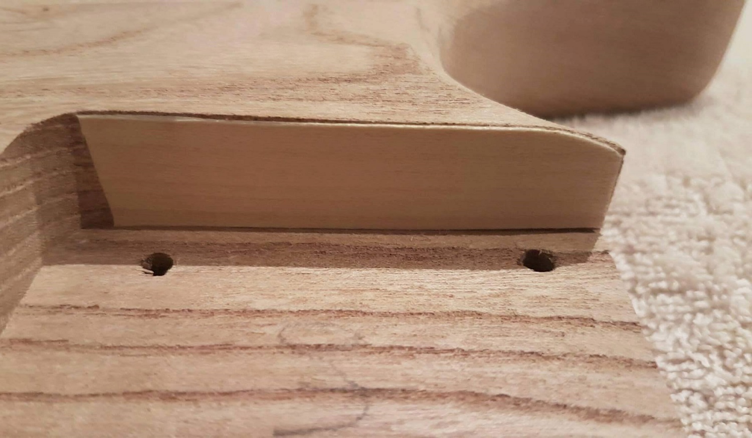

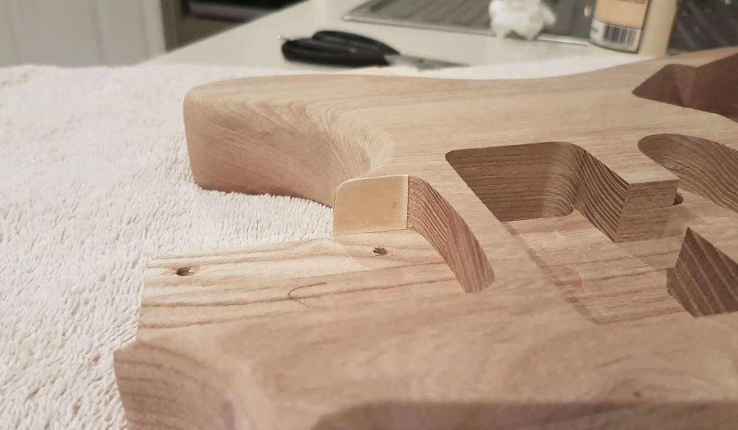

About this time I do a mock up (after reading the damn manual...) and realise that my neck pocket is slightly too big ;)
Not to worry, i order a sheet of .4mm veneer and get to work...
Attachment 12515
Attachment 12516
Attachment 12517
and BAM.. a neck that fits properly...
