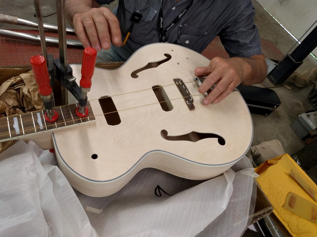

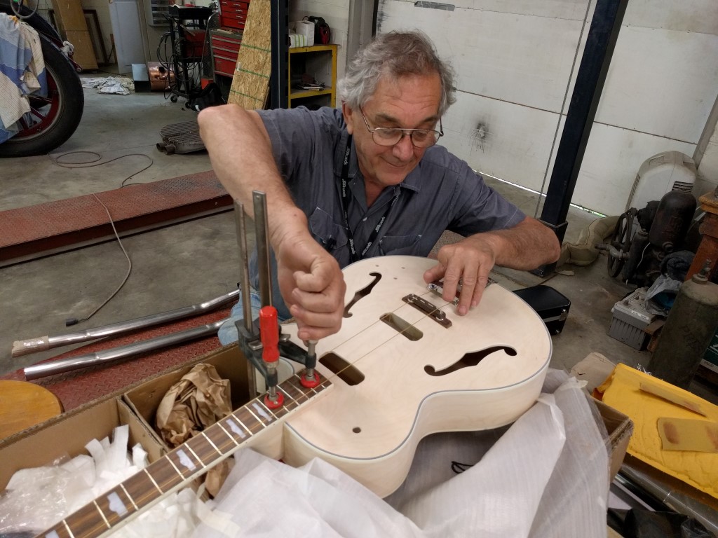

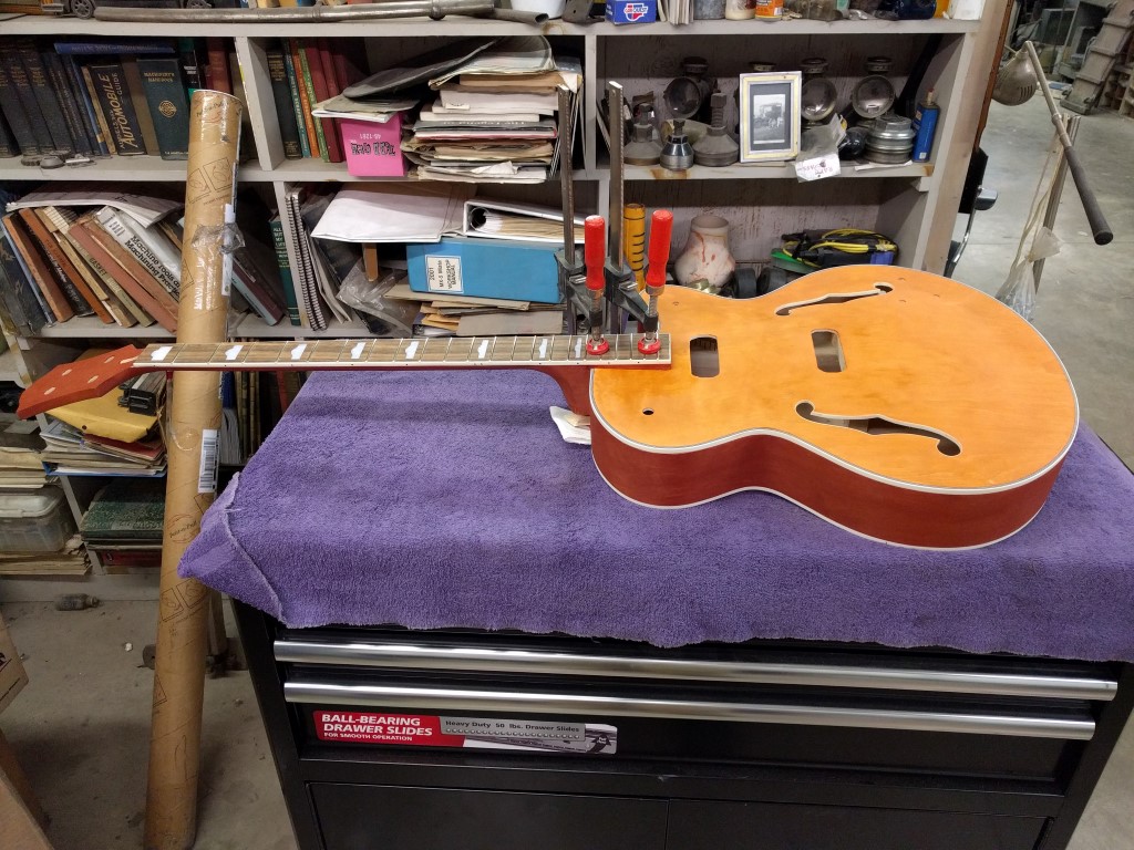

Next, we bolted the neck on to check neck alignment.
The neck was actually a tiny bit too big to fit in the pocket correctly, so some careful judicious sanding was needed. Also, there was a bit of...slag? in the pocket (wood bits in the corners that hadn't been routed out correctly), so a bit of time with a file was needed to clean that up. Once we were sure the neck was seating in place properly, we threw some clamps on it.
Attachment 12276 Attachment 12277

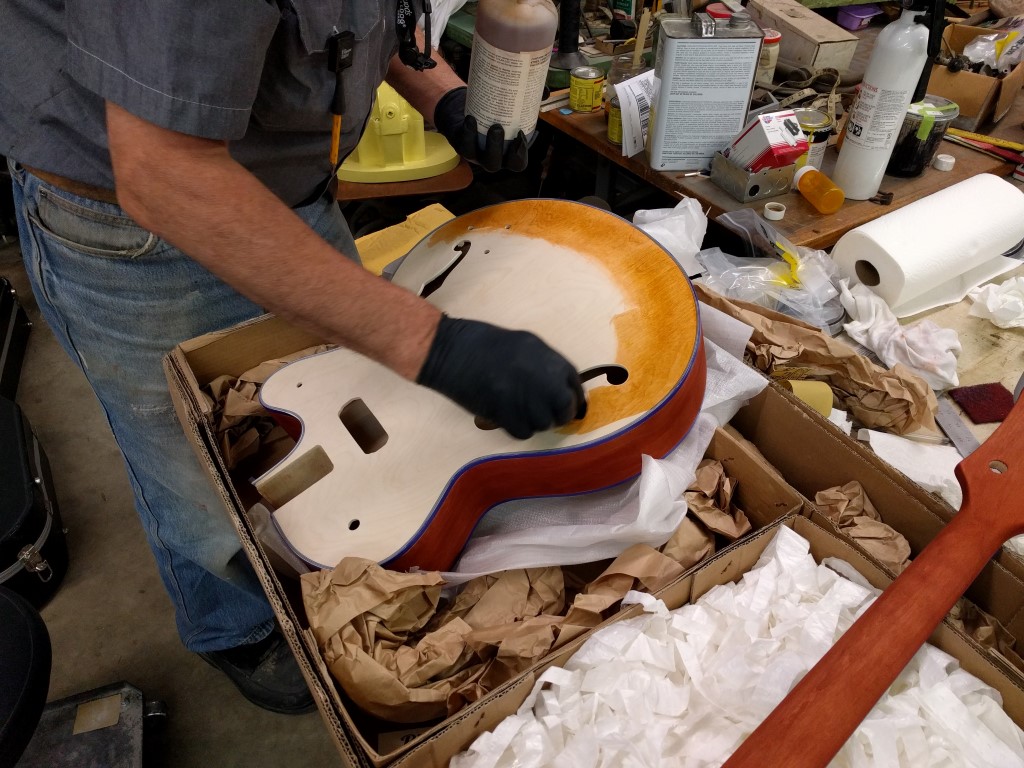

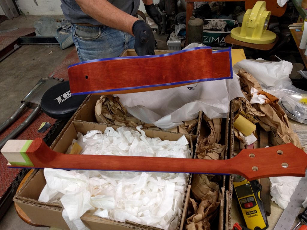

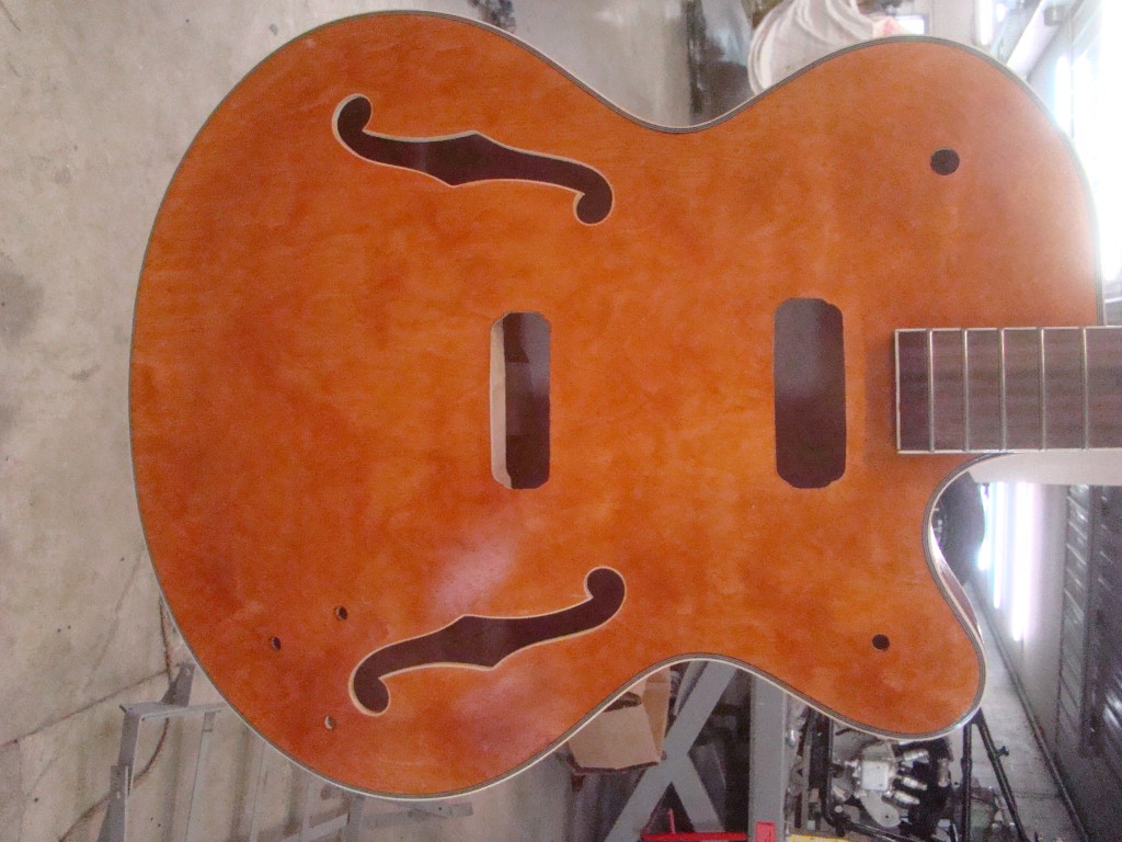

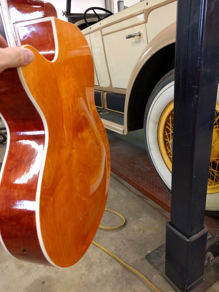

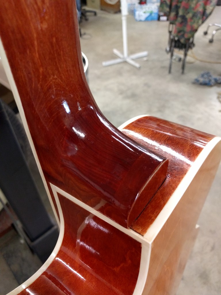

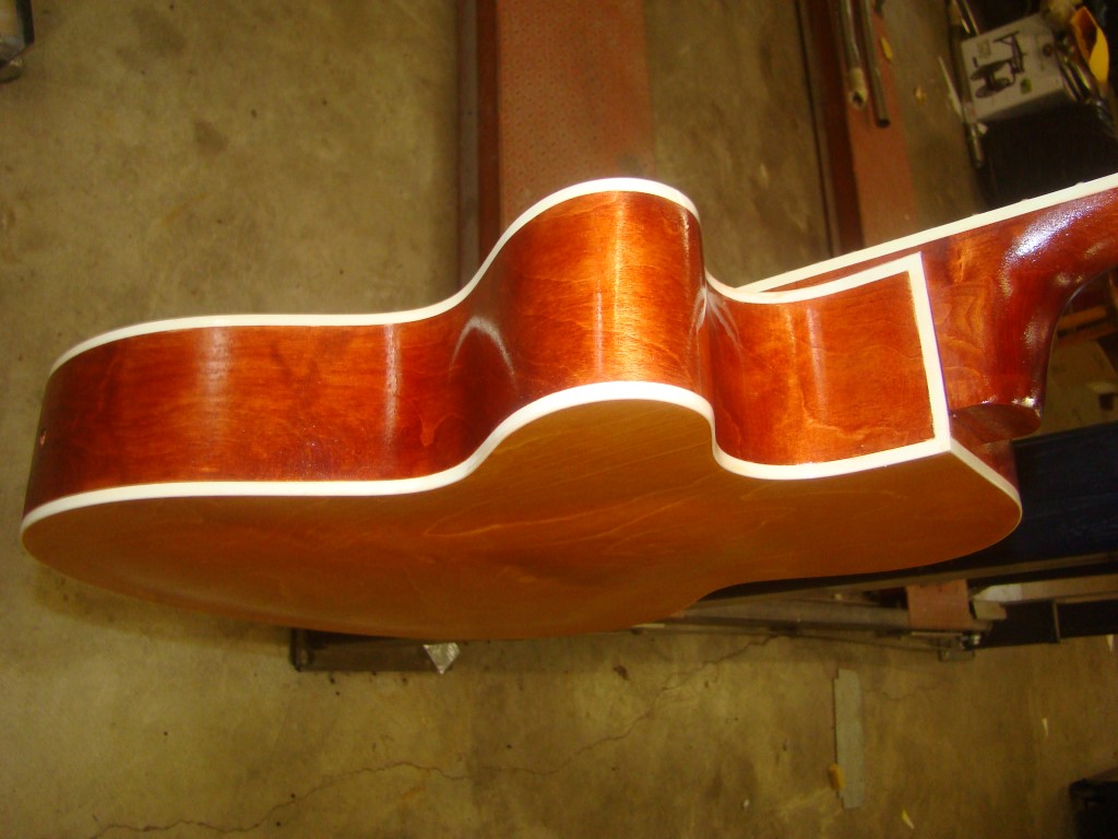

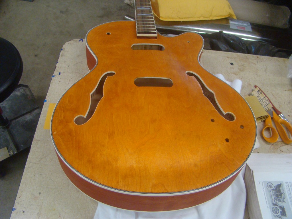

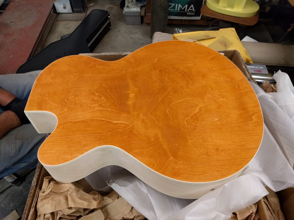

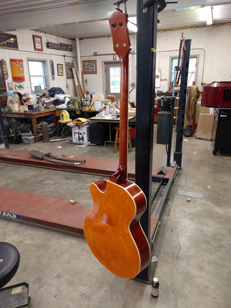

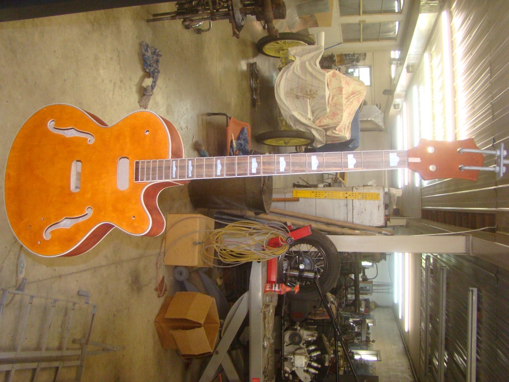

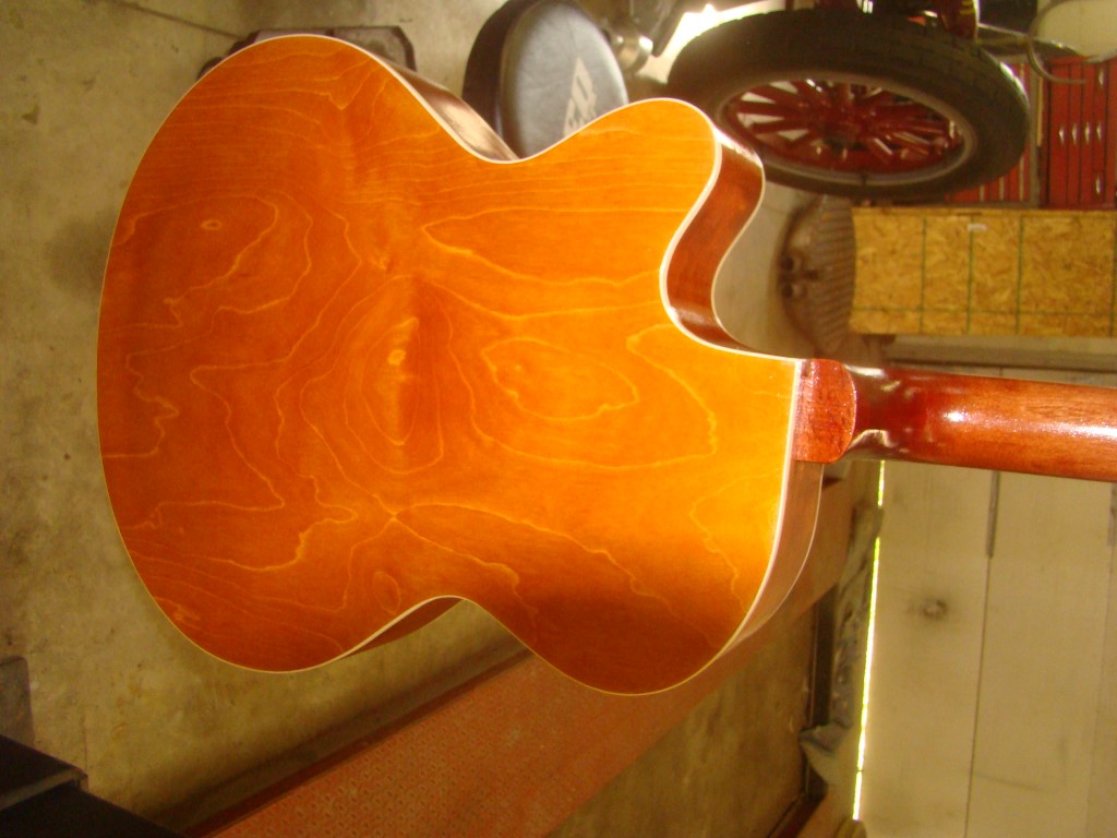

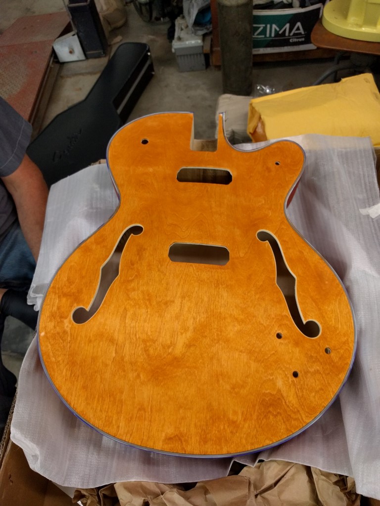

Next we stained the body and neck, deciding that we'd do the staining while the guitar was still in two pieces, and then glue in the neck so the guitar could be finished as a single unit. We used Solar Lux dyes (because our friend had some on hand, and we'd read that they were good for this sort of thing), applying medium brown mahogany to the neck and the sides of the body, and golden fruitwood to the front and back. (We did the back, then let it dry thoroughly. Then did the neck and sides, letting them dry. Then we did the front.) The dyes looked great while they were wet, but ended up very "flat" looking when they dried.
Attachment 12279Attachment 12280Attachment 12281
