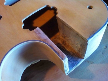

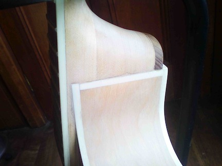

Some of the collateral damage from the neck removal

Had a bit of blackwood the right thickness.
Attachment 32232
Sanded and filled. Not the flushest join. Also apparent is damage on the bout from the steam. Will be going for a darker back and sides to cover this up.
Attachment 32233
Likewise on other side.
Attachment 32234

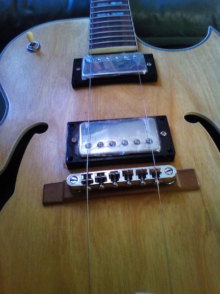

You may recall that the neck angle was still slightly askew but thought that a floating bridge or renotching the bridge saddles would get it right. Had an idea for a sort of fake floating bridge.
1. Remember to drill an extra hole for an earth with to the tailpiece because I'm not using the stud mounting inserts.
2. Some strips of hardwood, blackwood I think or maybe myrtle, glue together and sanded to contour.
3. Holes drilled for studs.
4. Threads cut with bolt.
5. Voila
Attachment 32397
However quite a lot of sanding to get action down. Also I ground the bottom off the ABR to make it flat.
