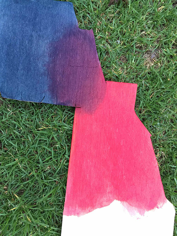

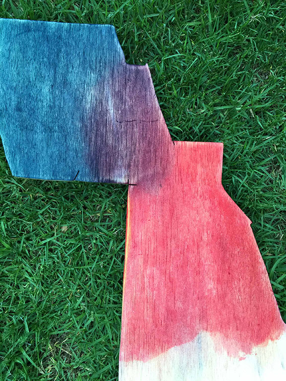

I did 2 woods, marine ply and a hardwood in 2 colours, red and blue.
This is the result of dyeing then sanding marine ply. I overlapped the colours to see how they would blend.Attachment 8366
Nothing exciting. The wood does not like to take stain.
Attachment 8367
Sanding did not improve the look.
Plywood seems to be a denser timber, as its manufactured for strength, which will make it less receptive to dyes. It still gives an idea on colour, though.

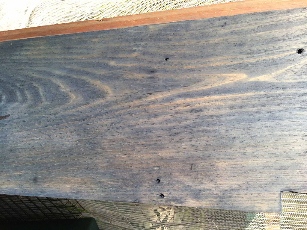

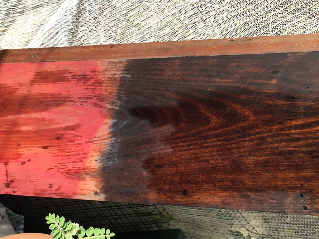

Here is the hardwood. It has a few remnants of black and red ink after I sanded it. Most of the ink, a previous attempt at staining, disappeared. The dark is shadows, it was late afternoon.
Attachment 8368
Here is the wood dyed red
Attachment 8369
This is after sanding back vigorously this morning. I wanted to make sure it was not just a film on the surface like most of the ink had been.
Attachment 8370

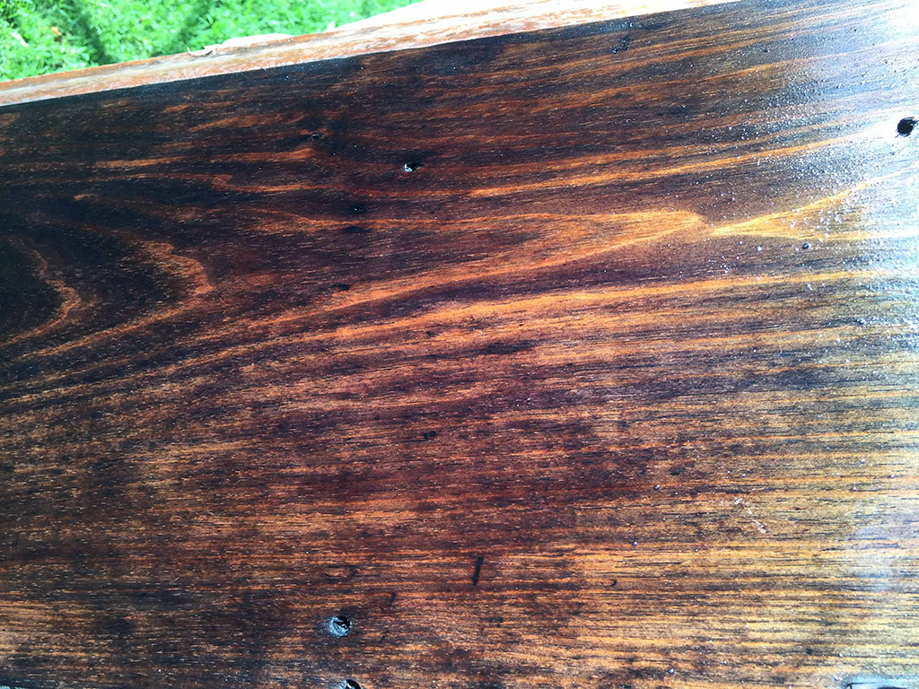

And finally what is looks like wetted
Attachment 8371
Much better than the ply. You need some grain to hold the colour.

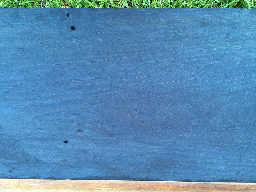

Last version was blue on hardwood.
When I first dyed it late last night it looked black. I was thinking OMG I have gone too far. Dried lighter.
Attachment 8372
After sanding the grain reappeared.
Attachment 8373
It looked good wet
Attachment 8374

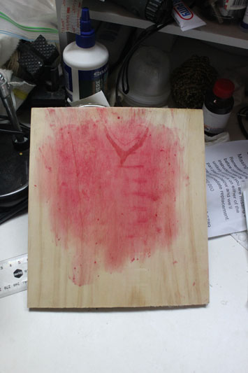

As it happens SWMBO was cooking some beetroot from our garden as I read this thread.
What else is a guy to do?
I grabbed a piece of pine and the scraps bucket.
I gave the pine a very quick sand, just to key the surface.
I simply rubbed discarded pieces of the boiled beetroot onto the pine (and scrapped off the vegetable matter that stuck to the rough surface).
The images were taken a few minutes after, as a control:
Attachment 8378
Attachment 8379

After a couple of weeks of drying the beetroot stain had faded a small amount.
When I applied the poly over half of the stain, it lifted most of it onto the cloth.
After a few more weeks in the shed (out of direct sunlight), the colour has faded almost completely.
I don't think it is permanent enough on wood - a white shirt maybe different...
